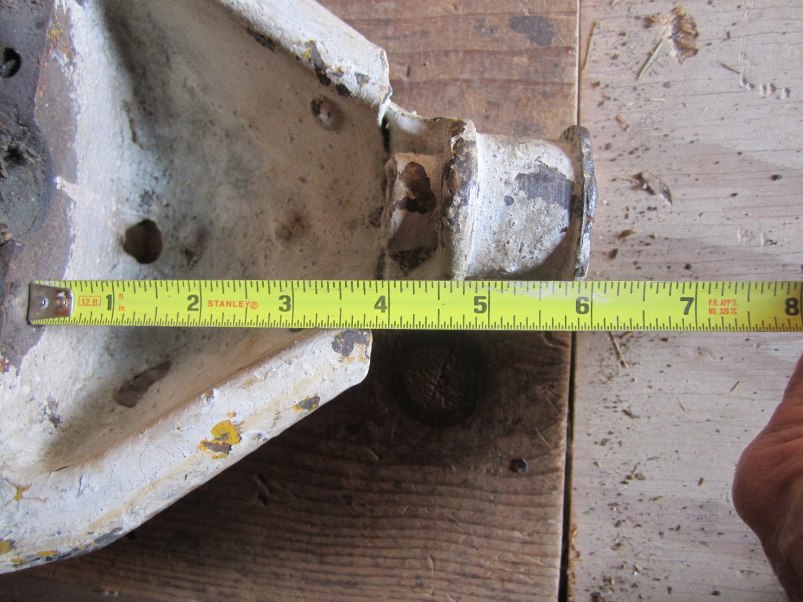

Now that it's much easier to post pictures (although the number posted could be increased) I thought I'd share my next project. It's a T engine with a B crank built by Orville Enyeart in the 70's for Andy Mounce (who I bought it from). From Andy's stories I believe this is the engine that made it up Pikes Pike and class winner at the Newport Hill Climb in his 26/27 Touring. Enjoy

We just worked on an engine similar to this one. It took a whole bunch of work to stuff a model B crankshaft into a T. You have to turn both the rod and main journals down to model A size or it won’t fit. There have been some T’s built with model B rods but they are OHC jobs with no camshaft in the block. Orville was a genius, he made some incredible stuff.

Was the block moved forward on the pan or the flywheel flange moved?

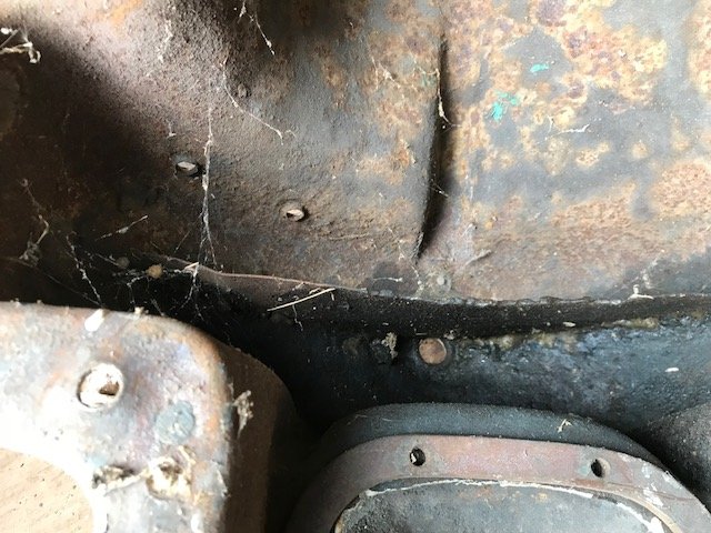

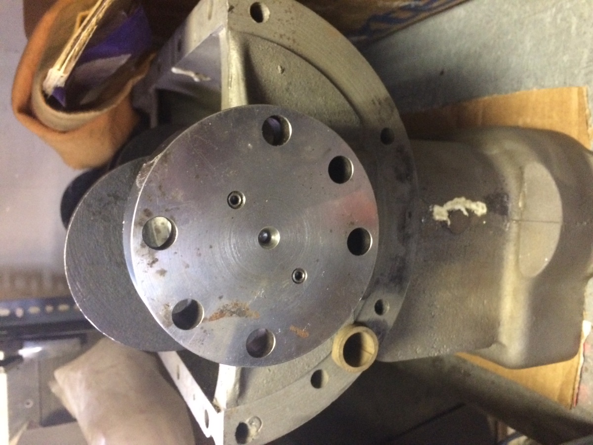

Here are some pictures of what I have done
1. Stretch of pan
2.relocation of front mount
3. Oil pump mount and block “stretcher”
4 SPEEDI SLEEVE for key cover
5 sleeve installed
1. Stretch of pan
5 sleeve installed

Thanks Les, some more pictures. The block is moved forward on the pan. The spacer on the end of the crankshaft I believe is when he ran this engine with the aluminum crankcase and C-4 transmission.

Here's some more pictures. This will get the "straight pan" fanatics squirming. Again the engine was mounted to an aluminum crankcase running an automatic transmission with a Model B crank shaft, so I'm guessing they weren't too concerned with pan misalignment. It appears that the arm may have been a single piece with the rubber bonded to the now two loose pieces of the bracket. Not sure where I'm going with this yet. Summer of 2020 project. Enjoy.

Welding the flange on in the process of shortening the crank is VERY difficult!!
The 2 viable methods “in my opinion”;
1. Move the block forward, which is what is shown in Orville’s engine
2. A taper/press fit THICK flange that I’ve shown a couple of pictures of. The rear main bearing is shortened 3/4”. This method has been successful.
3. I tried the weld approach with the work done using very advanced technology. Ultimately after about 5,000 miles the weld failed. No particular harm from the failure. I have fixed other conversions done by less skilled welding and they only survived a few hundred miles
