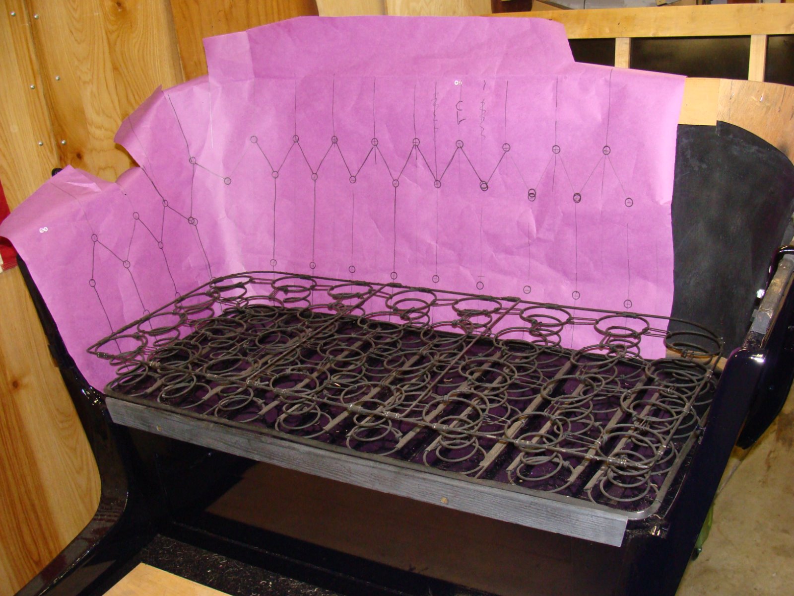

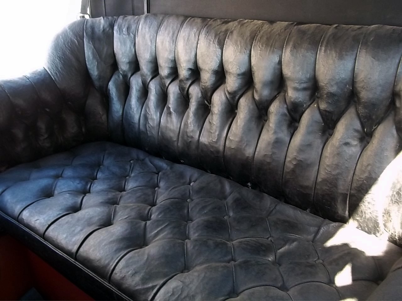

I made the patterns for my upholstery for my late 1911 Beaudette bodied touring car. In my research from original upholstery, I have determined the cushion for the Beaudette is two diamonds deep and the Hayes three diamonds deep.
Early 1911 used the wood frame seat, later in the year (on Beaudette cars at least) the frame was steel, then the bottom was covered with hardboard and artificial leather.
Here is a Beaudette Cushion: Here is a Hayes Cushion: Here is another Hayes cushion: The back seat cushions are typically one diamond wider than the front cushion.
Here is a wood framed seat cushion:
And the metal framed cushion with the bottom covering from later in the year:

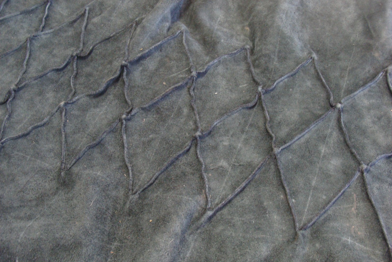

Here are some more pics from my project: : ^ )

And a few more:

Full disclosure: I made the patterns, found the leather, horsehair, ordered the uncovered upholstery prongs from the factory, found original capped upholstery nails, and got trim from Original Larry. I did not do the sewing. I found a local upholstery guy who had never done a Model T, never worked with horsehair, and never used prong style buttons before, but he was willing to try. I liked that positive attitude!
I made the base patterns and leather patterns. We used duck cloth for the base, used rubberized horsehair for a horsehair base, then used regular horsehair for the stuffing.
I would be happy to share all my patterns with you.

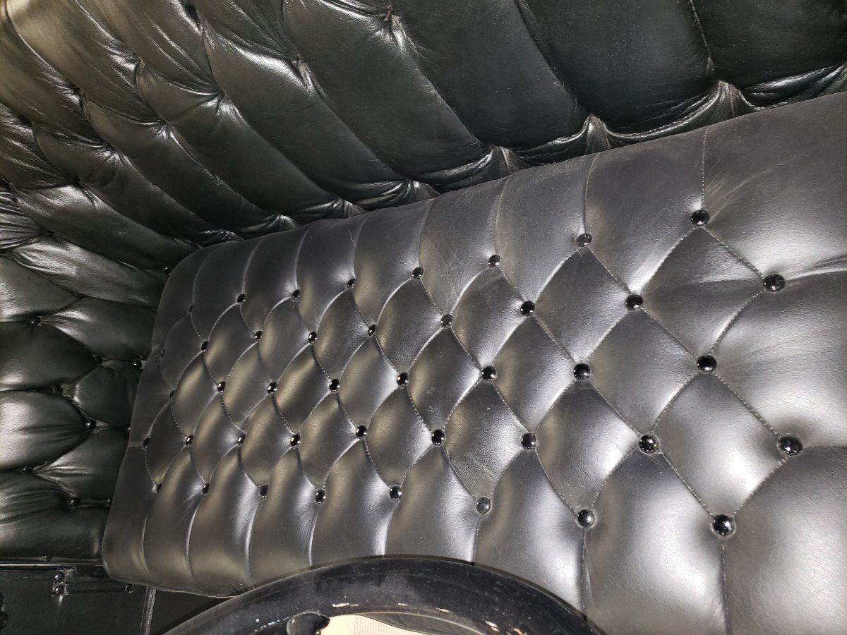

These show my home done 12 Touring upholstery job. These cushions were made using cut off scraps from this and another car project. The diamonds were individually sewn together, then padded to suit. This cushion frame is one of Snyders repo box springs. To determine the pillowed look this would have, I used the cheap vinyl pattern method. This is a most comfortable car to drive.
