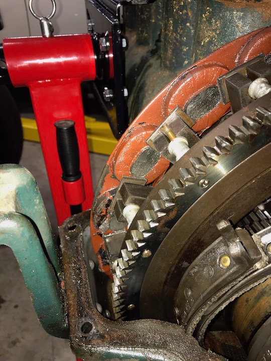

Re: Getting Rattles Back On The Road
The triple gear pin must be broken in order for the gear to touch the flywheel like that
Looks like a nice car otherwise
Stephen
Stephen
Topic author - Posts: 1152
- First Name: Robert
- Last Name: Govoni
I think the pin may be broken as well. We will have to see once I open up the engine.

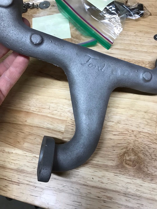

That said, nearly every as-is car I've worked on, has cheap $2 paper gaskets at the intake/exhaust manifold glands. They invariably are deteriorated to the point of failure. It looks to me that you have an intake leak and to run, the carburetor is set to very rich to keep the car running. This results in two plugs running very lean and two plugs running very rich.
Use these: https://www.modeltford.com/item/3063-64.aspx if your exhaust manifold is straighte enough (it almost surely won't be), so if not, use these: https://www.modeltford.com/item/3063MC.aspx
If you want to have high probability of failure and warp the exhaust manifold further, use this: https://www.macsautoparts.com/ford_mode ... erial.html which of course you don't want to do..just wanted you to see what an inferior product looked like

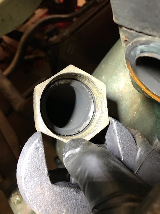

So this is is what happened when I tried to use the Pack Nut Wrench. It was too small. I called the vendor I bought it from and he said it fit the nuts they had. He gave me the measurement and when I measured my Pack Nut it was bigger. I used a pair of channel locks and got it off ok. I also bought a new nut.
- Posts: 6524
Robert
sometimes those repro wrenches need to be kissed on a belt sander or a grinding wheel. I have an original wrench which fit an old nut just fine, but because I tour and wanted to carry a wrench (and not an original pristine one) I bought a repro wrench. Wouldn't fit the nut. Huh. Ground the surface roughness off the jaws and everything was fine. Has seen a lot of rough use since then and is holding up fine.
FWIW.
FWIW.

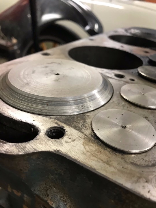

So this is what the valve spring area looked like.
Looks clean.
Looks clean.

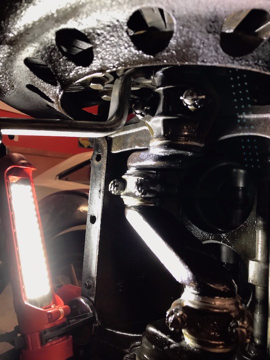

Well I got the engine out after work today!!!

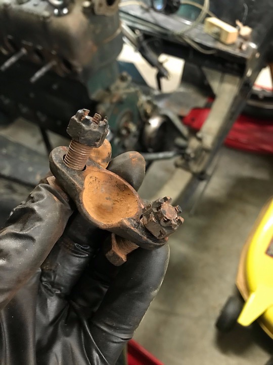

When I took off the Rad Rod I found not cotter pins and different size springs. That's not good.

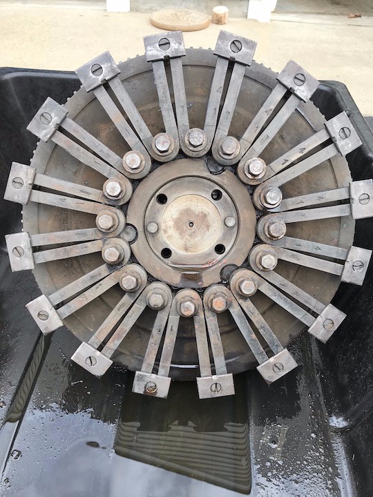

So now I can see two issues that I had known about . First the Mag Ring is the wrong year. That explains why my starter wouldn't come out.
Then I saw that one of the pins was broken on this triple gear. I hope that's the only issue..

Looks like you're making good progress. Those wishbone ball cap studs/nuts need to be wired to each other, not cotter pinned. If you use cotter pins, the nuts will be retained on the studs, but the studs can still back out from the pan.
http://www.mtfca.com/discus/messages/70 ... 1497125290

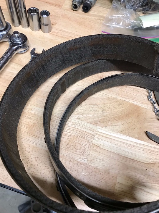

It looks as if the removable bands have been ground on for clearance sake. They were installed backwards.

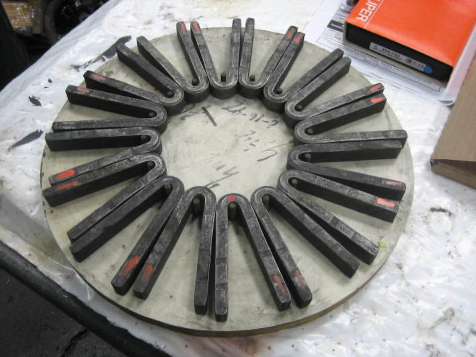

If I am correct in the tangs having been ground back, you will want to a) locate new old bands and b) install them with the removable ears on the driver's side

Well today I got the Pan off. here is a look inside.
https://www.youtube.com/watch?v=HpwDrVDo_No
As you can see the triple gear is jammed against the flywheel. The pan looks real clean. Some sludge in the bottom.
So I was told in my post that the bands were ground and needed to be replaced. I don't see any marks on them. Do they look ok?
- Posts: 6524
They do in fact look fine...just installed backwards
Consider new lining material based on reverse band
Purchase Repairing And Restoring The Model T Ford Transmission and also do some searching on the MTFCA forum for discussions on triple pin bushing clearance. Reading the book and studying the volumes of info on the forum, you will find key things, like how to press out the pins without destroying the flywheel, and what sort of clearance the bushings should be to the pins. Yours were likely set too tight at the last rebuild. Finally, I'd strongly suggest you purchase new bushings from Bob's Antique Auto. They are the closest things to the correct material, and that is important. He supplies them to some, but not all other suppliers, and I don't know which is which, so stick with Bob's.
This is going to undoubtedly be a learning experience for you. Good luck and go slowly.
- Last Name: Govoni
Thanks for the Info Scott!!!! I plan on replacing the lining as well as getting my bushings from Bob's. Everyone recommends him. I never knew there was a right and left for the bands.

So how do these Transmission bands look?
I plan on changing them since I have everything apart.

Appears to be a pre-starter mag coil ring, but not much earlier than '17. If it is in good condition, it would work fine. A large coarse rat-tail file would take care of the starter notch real quick! The notch doesn't need to be very deep, about a quarter of an inch. A lot of people however, would recommend getting a rebuilt coil ring for reliability reasons. The original cotton wrappings have a tendency to be somewhat rotten after nearly a hundred years. And churning oil can remove them resulting in a short in the windings.
Band linings look like they are almost due for replacement, so definitely, redo them at this time.
Check all the transmission parts carefully. Especially the drums and the flywheel around that broken gear pin!

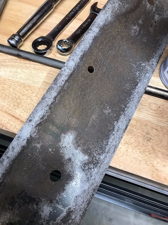

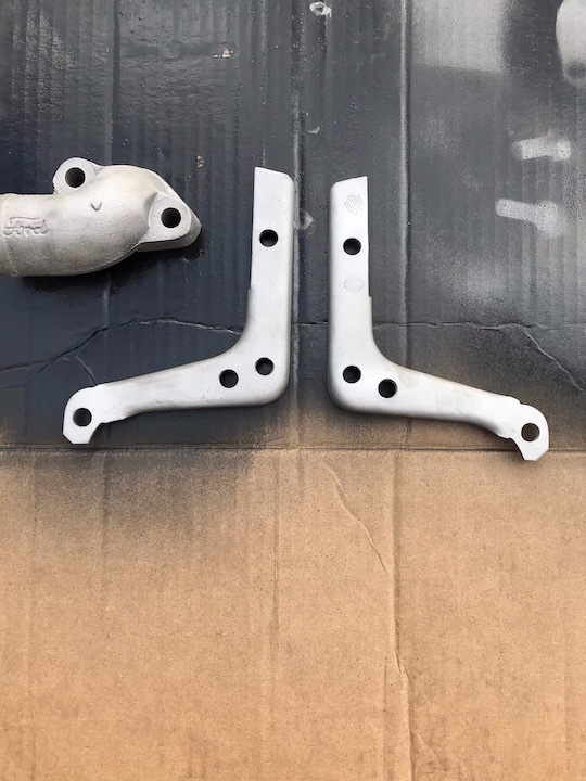

Well I got a bit more done on Rattles yesterday. I decided to clean up the intake and exhaust in the blast cabinet.
Is this a reproduction exhaust part?

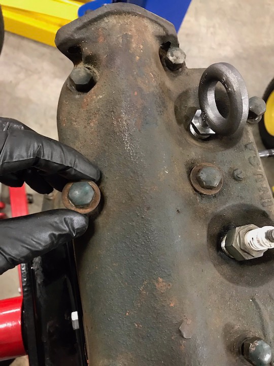

Well today I did some more cleanup on the motor. I used brake clean and then some small items off to the blast cabinet.
I think I need a new Valve cover. This one is so pitted I don't think you will ever get a seal on it.
This is the only shim I found behind the Magneto.I think I need a new Valve cover. This one is so pitted I don't think you will ever get a seal on it.
- Posts: 6524
clean the valve cover like you are doing. Apply Ultra Black around the perimiter and place the gasket on it. Lay the assembly on a surface plate or similar and lightly weight it. Let it cure and you'll be fine. When you assemble to the engine, grease the sealing boss on the engine, apply Ultra Black on the gasket and lightly tighten. Allow to cure and snug a little more. The next time you need to look at the valves, the cover will pop off and every tiny divot on the cast iron block will be in the Ultra Black and will reseal perfectly for multiple times thereafter.

Good Idea Scott. Want to make sure I got this right. Are you saying use the black sealant on the cover then add the gasket and put it gasket side down and add some weight. let sit for 10 min? then put grease on the side of the block, more black sealant on the gasket put it on and let it seal.

Well I went out to check my pistons after a call to Lang's with questions about installation. The guy who rebuilt the engine used aluminum pistons and yes the split of the side of the piston was facing away from the cam shaft. still odd that the number 1 piston has the wrist pin bolt facing the cam shaft and 2,3, and 4 are facing away from the cam shaft. I'm not so sure how many miles are on the engine so if I remount the 2,3, and 4 rods on the wrist pins and crank I run the risk that the bearings (that are currently worn in the way they are) are going to wear unevenly. I plan on redoing the cotter keys. They didn't leave one side long so they may not hold against the rod and one was missing.

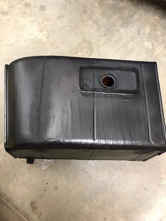

Well I got some more done today. I'm not sure why people have such a hard time with the gas tank on a 26 touring. I mean after I pulled the engine, steering column, and dash board it came right out. Ha!!
Here is a video of what I found. The tank looks great on the outside. Unfortunately the inside is lightly rusty. I'm going to send it out to the place where they take it apart and seal it.
https://www.youtube.com/watch?v=6q9CjmZNZM8
Then I took the head off. I saw that the guy who had the car before me added some washers to three of the head bolts. My guess is that there is some junk in the hole and instead of cleaning it he just added a washer to take up space. I got a new set of head bolts and head gasket. I'll remember to put the gasket on correctly.
This is what I found when I got the head off. I'm not sure if this hole I pointing to is supposed to be blocked by the head gasket. All the steam holes looked good.

Looks like you have something to start with, The bores look glazed,so it may have more miles that you think. Great time to look it all over. At least bead hone it and new rings. Check valves, adjustable lifters are nice. Make sure it has a good cam gear. I like the stock ones. They make better cams , and some people advance the stock cam 1/2 a tooth. Higher compression always helps. I installed high compression pistons in dads car and it was very noticeable along with advancing the cam. Looks totally stock. Thanks for sharing.

Thanks John. In looking at the cylinders I can still see the cross hatch scratches on some. Then again who knows. I'm just glad that it was rebuilt at some point. You sometimes never know until you open it up. Ha!!

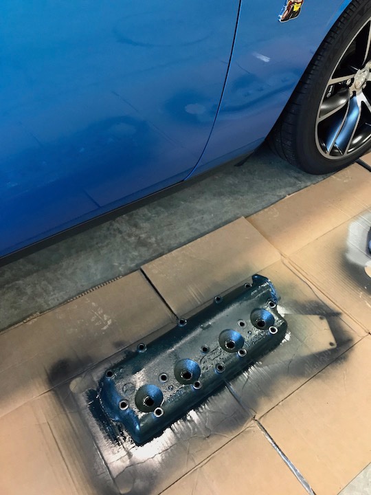

So tonight I got my blast cabinet running good and cleaned up the head.

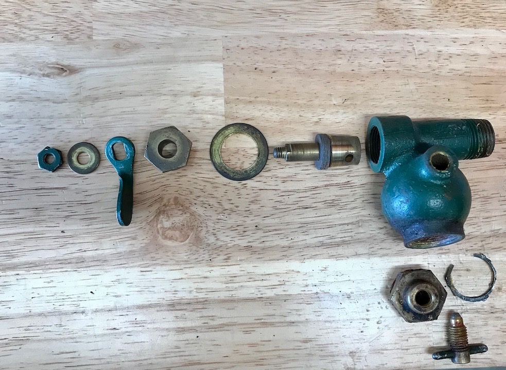

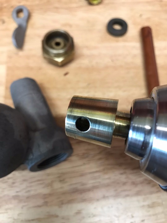

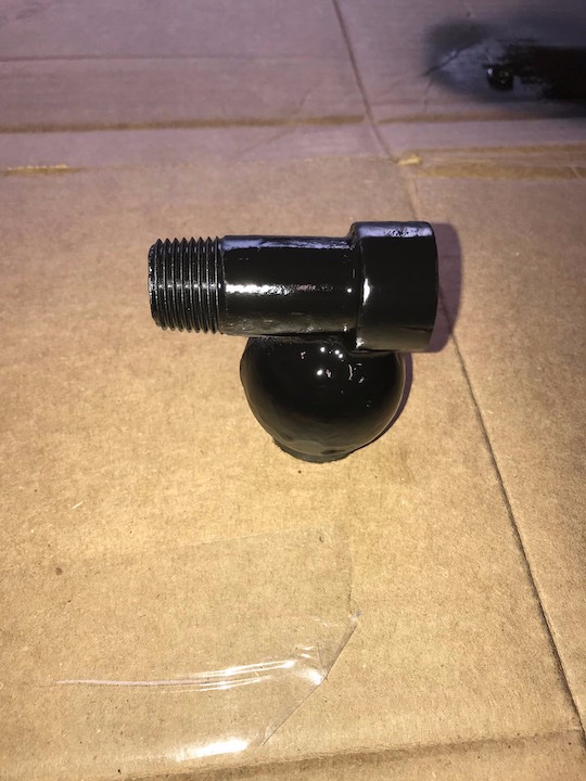

Well today I cleaned up some bolts and then went to work on the sediment bulb.
This is what I have to work with. Found out that there was no screen inside. This is what it looked like when I got it all apart. I have the rebuild kit for it. Question: If I put this in my blast cabinet will I mess up the threads? I'm using a mild abrasive "Black Beauty".
- Posts: 7239
I would expect the threads to be OK, but I would duct tape the tapered cylinder and stuff paper inside the body to protect the mating surface.
- Last Name: Govoni
Good Idea. I'll see how much I can blast out from the other end. I'll be careful around that surface. Thanks!!
- Posts: 837
- Last Name: Clements
- Location: Waynetown Indiana
You might want to use some lapping compound on the tapered surface. Also, buy some of that EZ Turn lube that Lang's sells. It works really well on the fuel valve.
- Last Name: Govoni
Thanks for the tips. I was wondering how I was going to clean it up.
- Posts: 522
- First Name: David
- Last Name: Dewey
- Location: Oroville, CA
You think black beauty is a mild abrasive? I always understood it was much more aggressive than glass beads.
T'ake care,
David Dewey
David Dewey
- Last Name: Govoni
Scott, Is the EZ turn Lube for the threads to seal them from mass leaking out or for the pard that I could Lap in to make smooth just behind the Packing? The guy who had the car used teflon tape. That's not good.
David, You are correct "Black Beauty" is very abrasive. I should have been more clear I'm using the fine "Black Beauty" It comes in many variations. I had to change from Glass it wasn't working as well on some of the hard rust.
- Posts: 837
There is a leather seal that goes around the shaft and then the brass fitting compresses it to make it seal. The EZ Turn lube is impervious to gasoline and lubes the brass valve and the leather seal. I used liquid Teflon to seal the pipe threads at the tank.
- Last Name: Govoni
Thanks Scott! I ordered the EZ Turn.
- Posts: 6524
If you truely believe that the plug requires lapping, you will want to use TimeSaver Yellow, for soft metals. Apply per instructions (mixed with oil), and work the valve into the body gently...let the compound do the work. Too much pressure, too much time, or too coarse of a complound and you will remove too much metal from the plug, score concentric rings on the plug which will weep endlessly, and end up with a "ring" on the large end of the plug which will forever be too big and will not allow the plug to seat deeply enough now that excess material was removed.
The Timesaver is a non-embedding compound, which is what you want. Stay away from anything that mentions carborundum or anything that has to do with cast iron or engine valves.

Today I cleaned up the Fuel sediment bulb. Next I'll do the brass.

Today I got my Gas tank back from Moyer's Tanks Inc. I have to say they did a great job. Keep in mind they coat the inside and outside. Yes it's a bit runny but you won't see it much and I would rather i have no issues than a tank that looks pretty. I know some choose to do this themselves but the tank on the 26 is a bit odd with the baffling and over fill tube. The take it all apart clean it and then reassemble it and coat it. Didn't want to take a chance in running rusty junk through a rebuilt carb. You can see what I paid as well.

Well today I got some painting done.
I decided instead of lapping in the valve. I would hit it with some 0000 steal wool and then chuck it up in my drill and use never dull on it. I'll put some E Z Turn on it when it comes in from Lang's.
Then I polished some brass. Having been a Marine for 30 years I thought I was up to the task. I decided instead of lapping in the valve. I would hit it with some 0000 steal wool and then chuck it up in my drill and use never dull on it. I'll put some E Z Turn on it when it comes in from Lang's.

I received an order from Lang's one item was my new Mag ring with the correct notch for the starter.
Question the coating on the Mag Ring covers this contact for the Magneto post. Should I sand it off for better contact?
I know you can't see it much but I tried to get as much of the black parts painted with some black engine paint from Eastwood. I also did the head and exhaust manifold.

Well I sanded the blob of solder on the Mag ring. Then I took apart the Mag post and cleaned it up as well as painted it. I still want to clean up the brass a bit more for a better contact.
Then i put together my Sediment Bowl. I used some EZ Turn and thread sealer that is used for gas threads. I hope it holds gas. I bought a gas line shut off that will go next to the Carb.-
- Posts: 837
Why is there a washer under the nut on the shut off valve? The nut needs to squeeze the leather seal in order to seal. Once working properly, you do not need another valve at the carburetor. This valve will do the job just fine.

Looking good! One question, is the exhaust valve on number three cylinder sticking open? In several of the photos there appears to be a large gap in the lifter to valve, and another photo or two the valve looks to be stuck open? May be just my eyes and the photo angle but thought I would ask!

Scott, That washer was there when i took it apart. When I put it together it was loose like it needed to be tightened some more. I think I'll take it out and try tightening it without the washer. The exploded view I printed from the forum didn't have the washer there.
Bill, I'll check but it think it's just the timing from when I took the picture. I'll turn the crank and see if it is sealing.
Thank you both. Always good to get several sets of eyes on.

Bill You are correct I just went out to the garage (My wife said "you're going out there now?") I can see the valve is stuck. I hope I can free it up with a wood mallet. I'll then turn the engine over and make sure that they are all working.

Easy does it Robert. A large faced hammer will not strike a square blow.
be sure to strike a square blow on the valve, and better yet, with a small brass drift directly over the stem, centered on the valve face. Be prudent. Consider soaking stem with penetrating oil first. Rotate crank/cam and get cam on heel. Tap valve closed. Repeat.

Scott, I took it easy and placed a wood mallet on top of the valve and tapped it with a rubber mallet after adding some penetrating oil. It moved no problem. I could almost do it with my finger. Then I turned the engine over with the crank and the valve went up with no issues and I had to once again tap it down. Did this several times and now the valve almost closes on its own. I'm going to let it sit and see what happens then try again. I may have to take it out and clean it up. All the other valves seem to be working ok.

Excellent
This usually how it goes, but sometimes they can really be stuck! Glad this didn't fight you.

Well today I got the valve working as it should however after talking with John at J&M Machine I'm going to take the valves out and clean out the guides and make sure that they are clean. John is a wealth of information and nice guy. He will be rebuilding my transmission as soon as Bob's gets another run of triple gear pins done. Bob makes the best and I'm happy to wait.

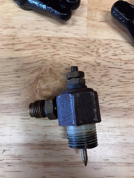

So tonight after work I started to clean up the engine pan. I took off the sight gauge and petcock. Then I took them apart and cleaned them up.
Question: Should the petcock have any packing on it held with the pressure of the spring?

Well I had a bit of a setback this weekend. I brought my transmission to J & M Machine in Southborough MA. First I am very thankful that I did. They were able to find cracks that would have spelled disaster had it not been checked. Two of my drums (Brake and Reverse) had cracks that were found once Magnafluxed. The other drum was very thin from someone turning it one too many times. The output shaft was gauged and banged up and cracks were also found in the clutch plate and fly wheel. I'll be replacing all that and more. This is a good example of pay me now or pay me latter. Had the drums just been cleaned up and used they would have come apart soon.
I have to say the shop at J & M Machine is impressive. We got a tour of all the machines that they have and what they were used for. I like what John said. "The Model T is a simple engine that is also very complicated. There is a lot to check and do so that everything works together."
They also have sent me pictures of the progress and are very helpful in offering advice and answering questions. If you need machine work done on old engines these guys are great. Hard to find people who work on old stuff.
So when I get done I may end up with a transmission that is worth more than the car but That's ok. I think Rattles will be with me for a long time.

Tonight I painted a water outlet and 1926 Pan reenforcement brackets.
This was from Lang's It was a NOS one. It cleaned up very well.
This tool and shims are very important for the 26/7 Hog's head.
Thanks to J&M Machine for the suggestion on the bracing (I still need to buy the top bracing) and for showing me how the tool was used.

Well I got some pictures from J&M Machine. They make their own drums and like I said all of mine were cracked.
The Magnets have been all recharged.
They are looking for a 26/7 clutch plate for me.
