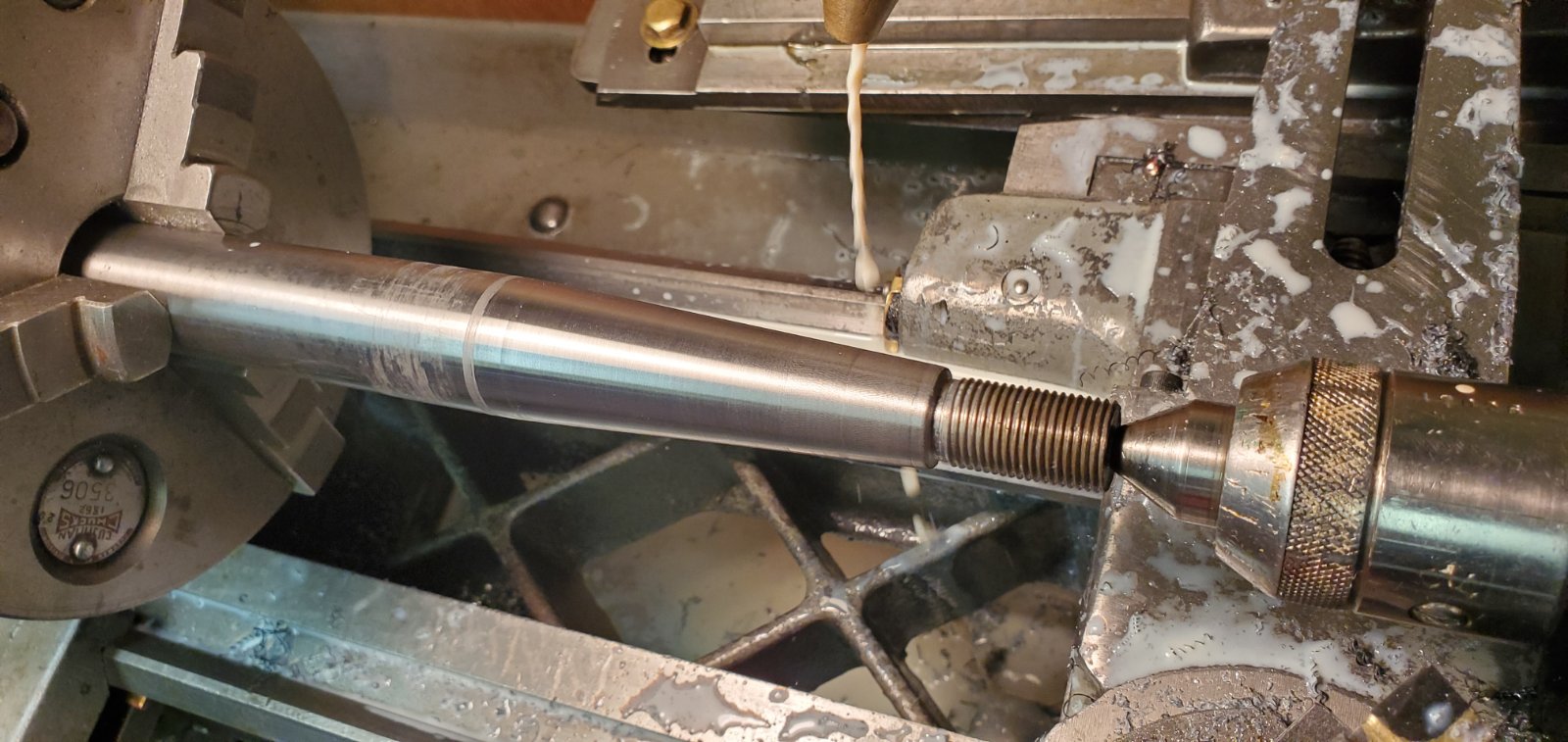

We (mainly Glen) did the work on a South Bend 10" lathe. Have the thread, taper and keyway done.
Notice taper attachment behind lathe bed.

Better picture of the taper attachment.

We started with a 1 1/8 inch shaft, heat treated 4140, 36 inches long.
