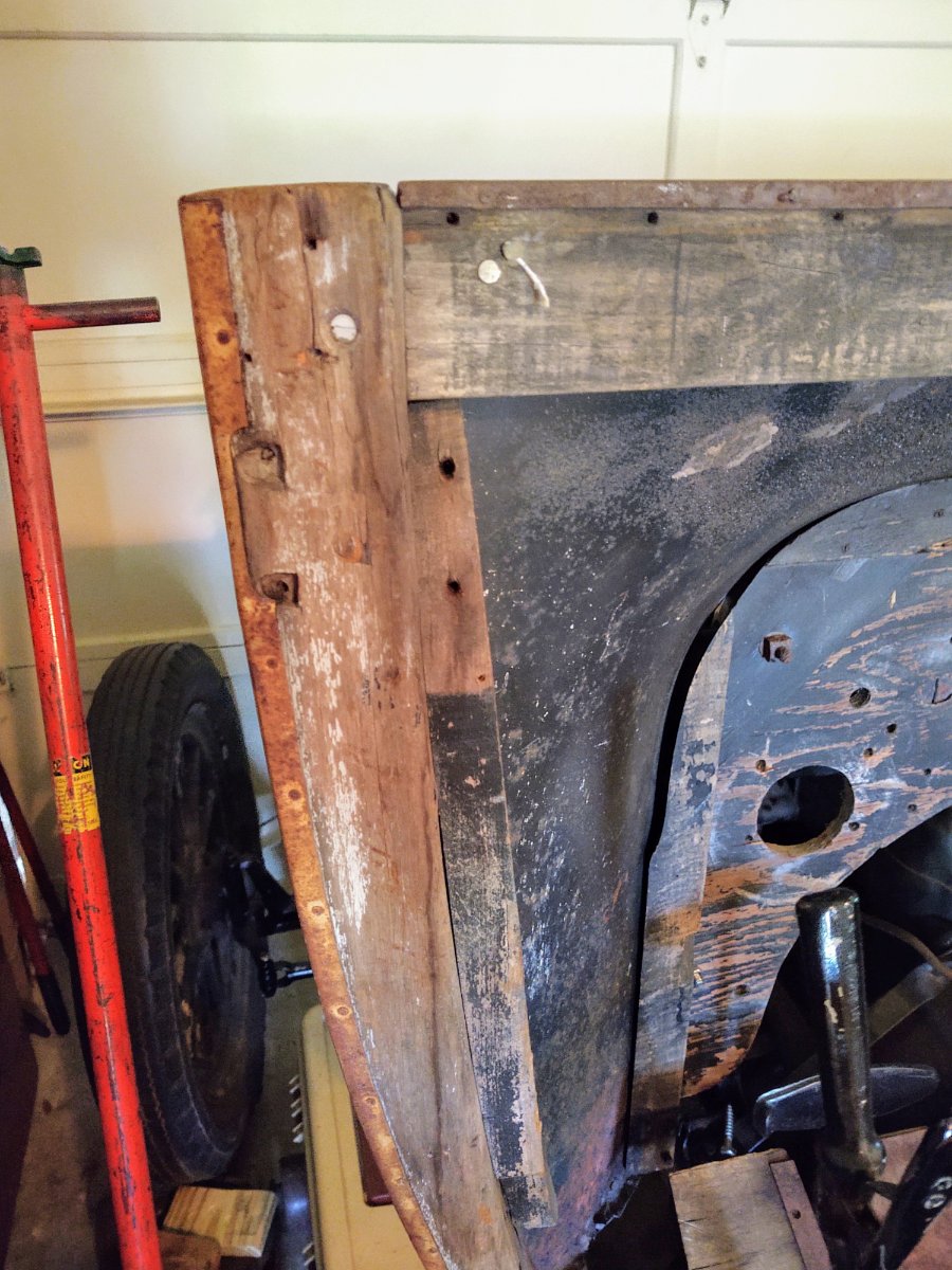

2nd try hopefully pictures load. Building myself a T, have this cowl and trying to find out if it had a dash, how the windshield mounts etc.

Looks like a coupe cowl. Wooden firewall and looks like it had a steel dash for the ammeter etc, so likely a 1919 to 1921.

I'm certain you'll be asked for full front and rear images of the cowl and wood firewall/dash. Reasonable chance your firewall/dash is not original. Basic measurements width at the bottom and height. You can see some minor variations of these

More pics will help, but believe Wayne has it, seems like the remains of a coupe cowl with the upper windshield wood pillars cut off.

Looks like it’s the front remains of a Coupe or maybe a Sedan since they look real similar without the rest of the body. Wonder if you have any of the rest of the body.
With what you have you probably could build a huckster or depot hack if you don’t have any more of the body.
Unless you know or have a source for a closed T body remains or parts that style is hard to find body parts or panels. No reproduction body panels are being made.
The open T’s body’s are more plentiful and the body panels are being reproduced so parts are more readily available. Good luck with your T project!

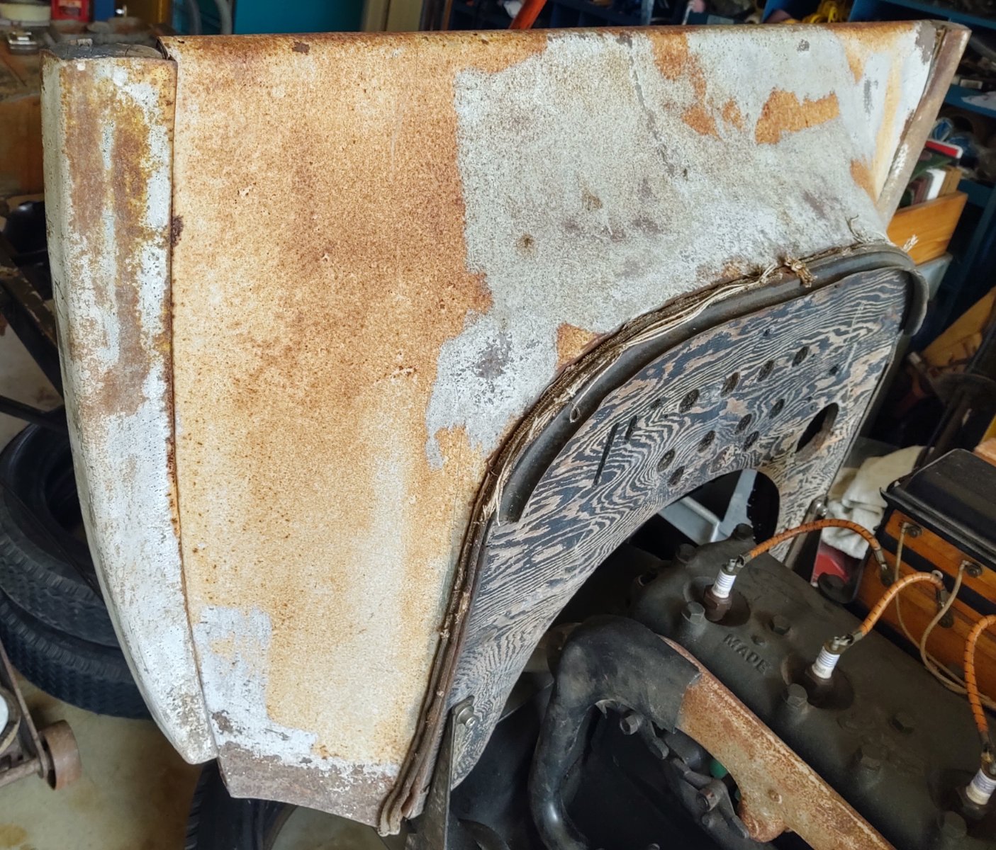

Thank everyone for the help, not much info on these years. Can't find a 39" dash most are shorter, just seen 2 listed on eBay from Canada but pretty cut up that show 39", might have to make one.
Looks like the steel dash bolts in below the strip of wood on the cowl ?
Been looking at used body's as the rolling chassis so nic
Any thoughts on how to mount a cut-down windshield to this thing. Thanks
Not sure what the story on the cowl is but came with the package.
