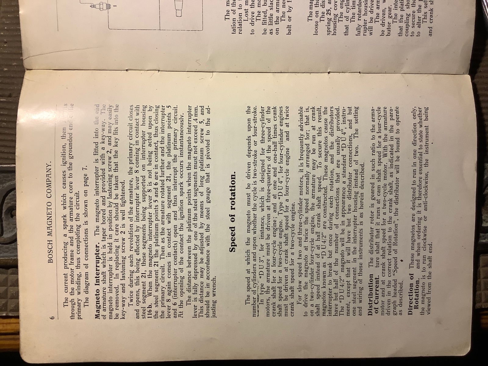

Anyone running one are these clockwise or counter clockwise for the mag have one of each dont wanna send wrong mag in as im waiting on DMC gear set

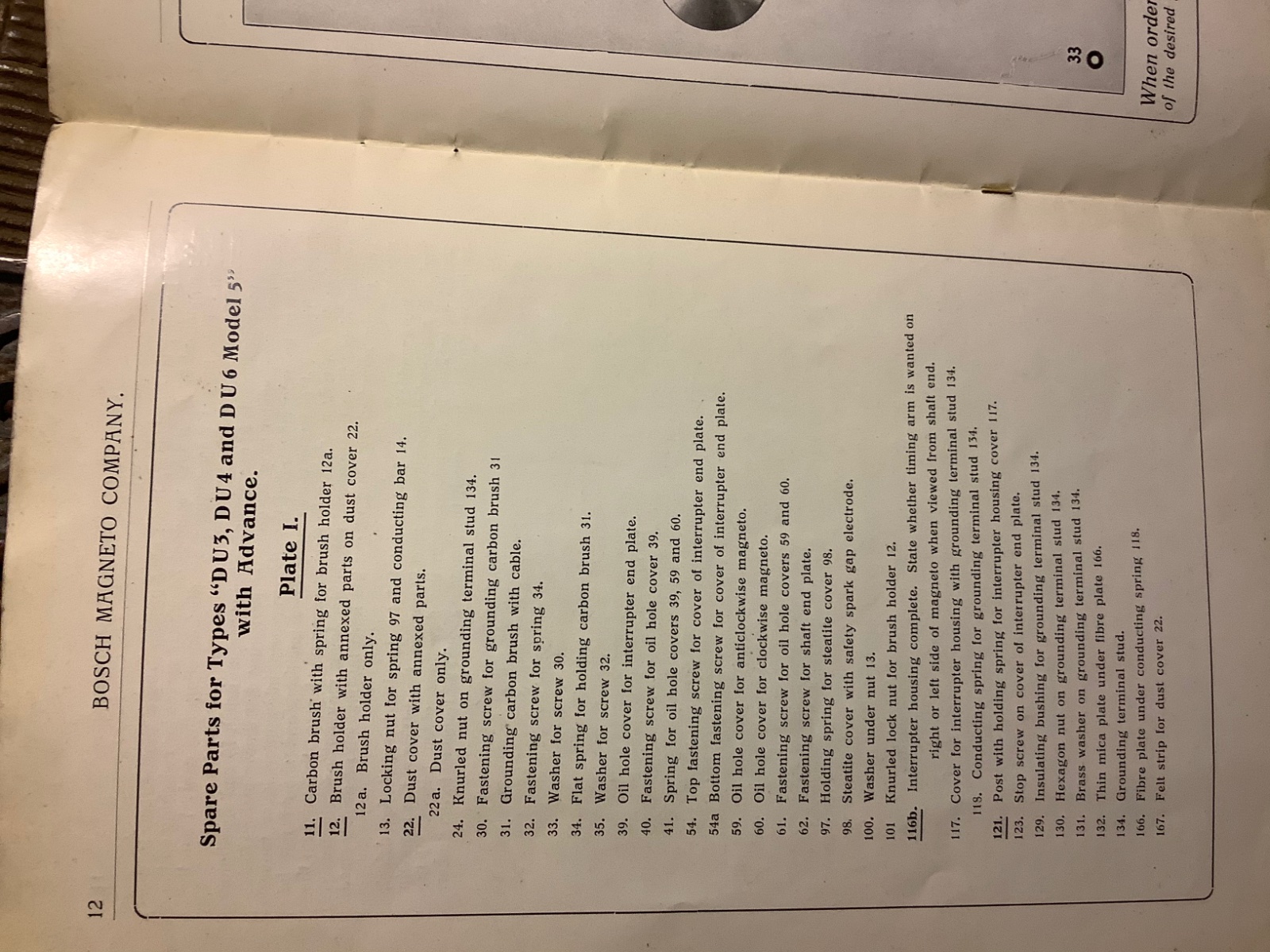

Bob, hope this helps. This is what the points set (Bosch) should look like for a crossdrive front magneto plate. I’d have to dig into it as to what it’s called, clockwise or anti-clockwise. The side drive ,that mounts on a shelf and attached where the generator would go uses the same rotation. The 3 gear side drive (splitdorf) uses the opposite rotation as shown.

Clockwise -Columbo cross drive
Getting my head wrapped around it again, it’s called a clockwise rotation. It’s important to remember this. The Bosch DU4 mag will revolve either way, but you need to have the correct interrupter plate ( points plate ) in place. The rest can easily be changed by moving the gears to time.
