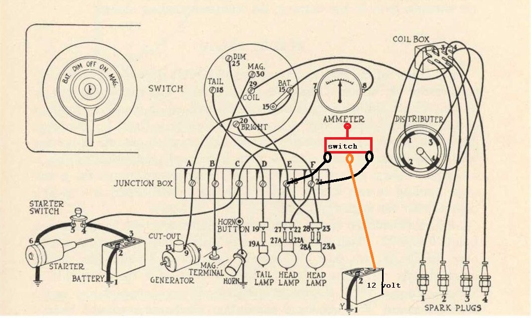

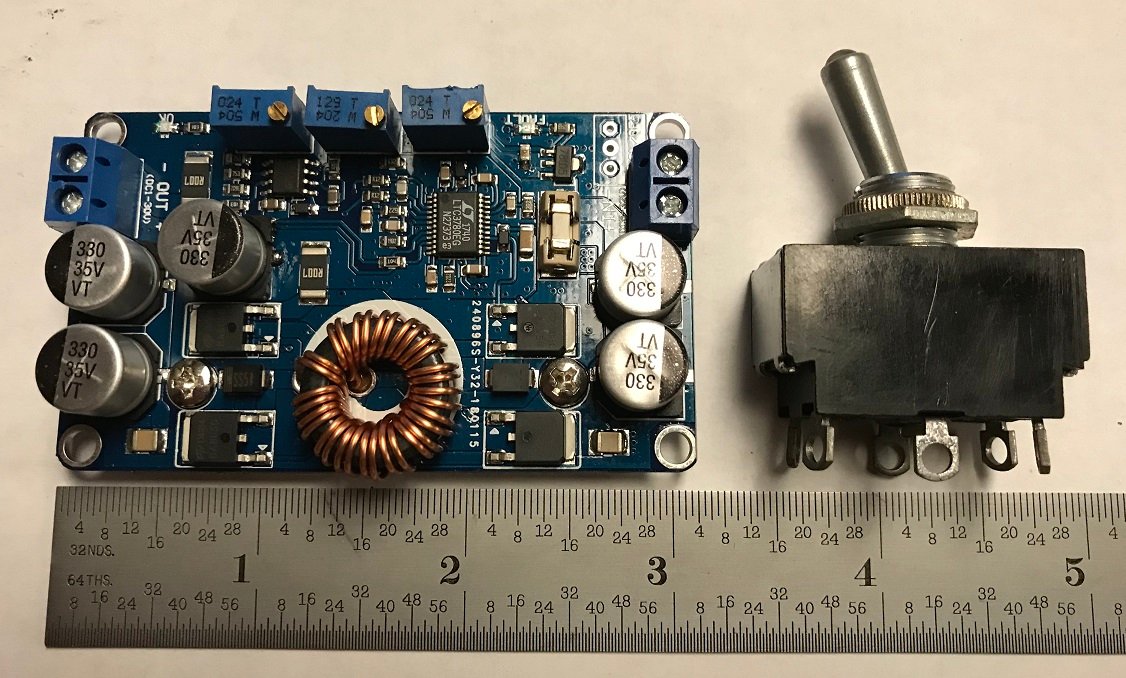

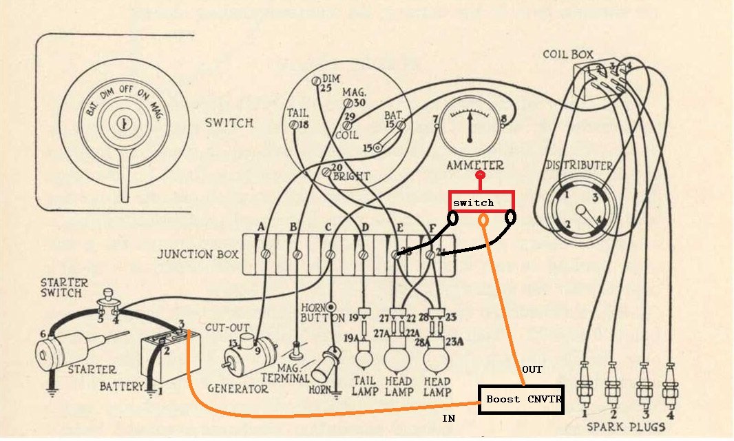

Post by TRDxB2 » Thu Jan 23, 2020 8:32 pm
Personally I don't think its worth the bother to change the system other than the bulbs. But here are two options - both are the same in that you will need to disconnect the DIM and BRIGHT connections on your ignition switch and incorporate a toggle switch and mount that somewhere. The difference of the input is a 12 volt battery as in option 1 or a buck/boost converter as shown in option 2 and I included a picture of it. What it does is convert 6volts to 12 volts many are available on ebay for about $12. I purchased this to experiment with and haven't tried it yet. I chose this particular one because of a YouTube evaluation and that its output can be regulated.
https://www.ebay.com/itm/LTC3780-Automa ... 80838c7b92 The converter is very small and could be included in a box with the switch. You can also learn about them on YouTube.

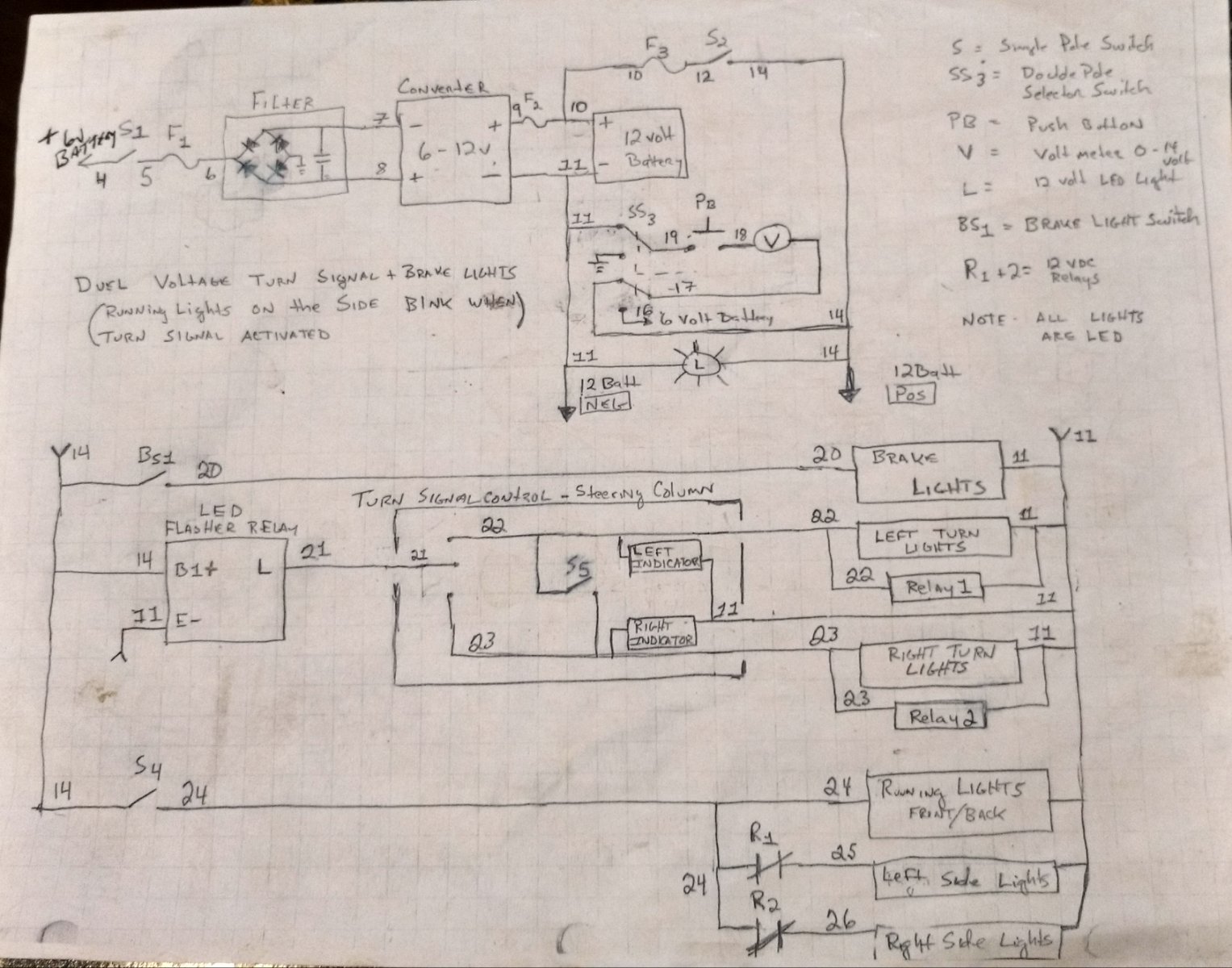

Here is the electrical I used for a separate 12 volt led lighting system. I did not install the upper left part with the 6 to 12 volt converter. Also I installed side lights above the tires in the fender wells. These run solid when on and blink when the related turn signal is on. The blinker switch on the steering wheel is one I made with long arms controlling a rotary switch. The blinker switch has led lights on it so I can see which signal is on. I wanted a buzzer but that didn't work out well. Can't hear a thing when driving. There's also a light under the dash so I can see the petals when the running lights are on.
There's a hundred different ways to do this but this is what I did.
The T I'm building now will just have a 6 volt system tied into the existing wiring running led or bulbs.
Just give me time to Rust and I'll be good as new. :) Wabi-Sabi
