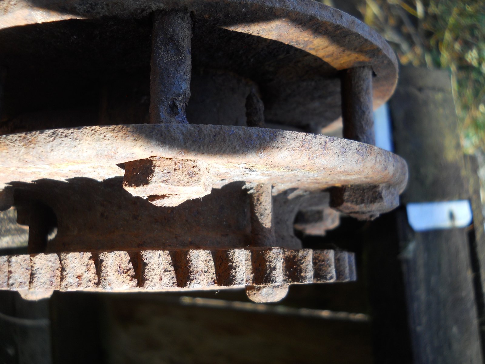

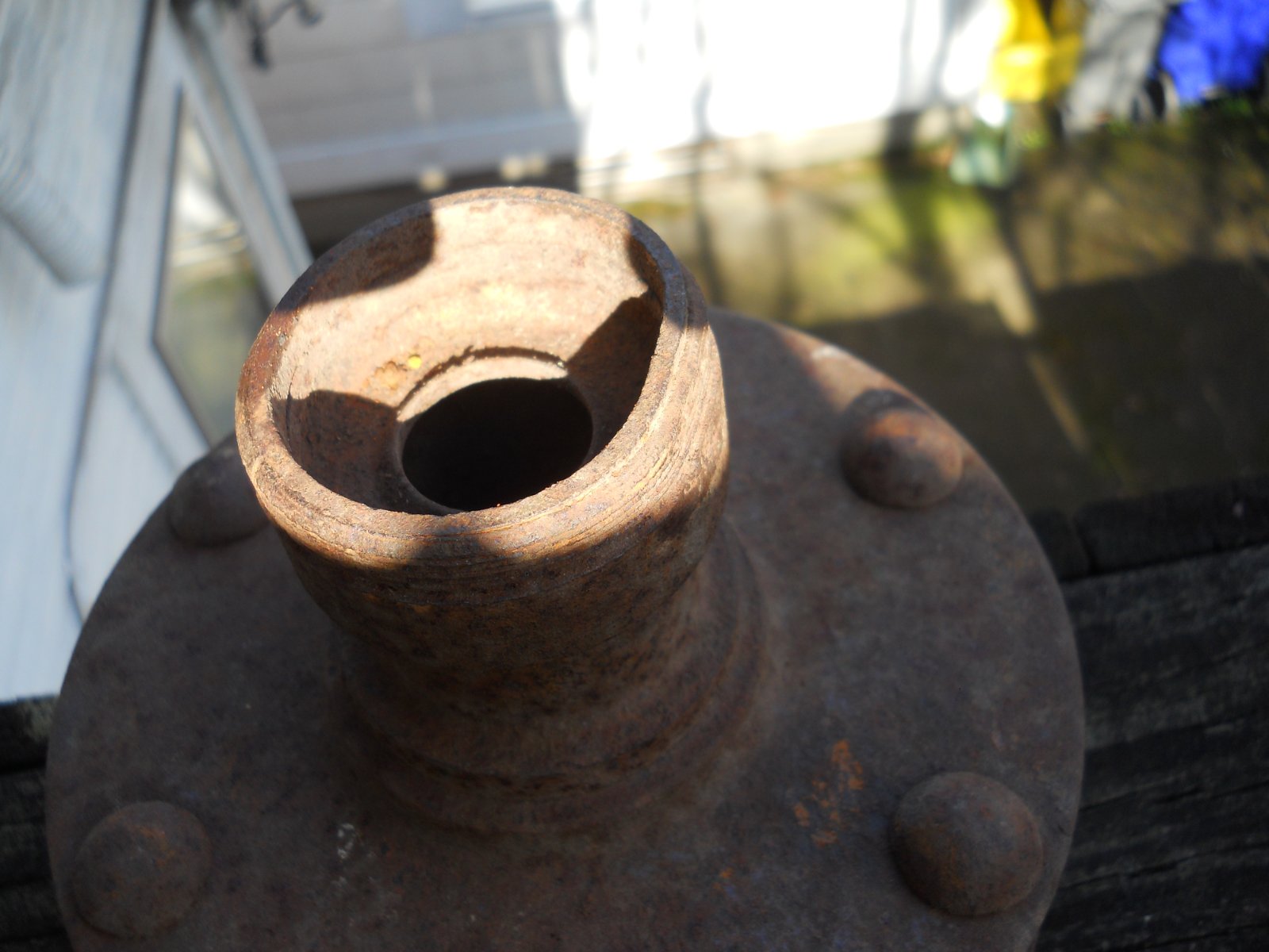

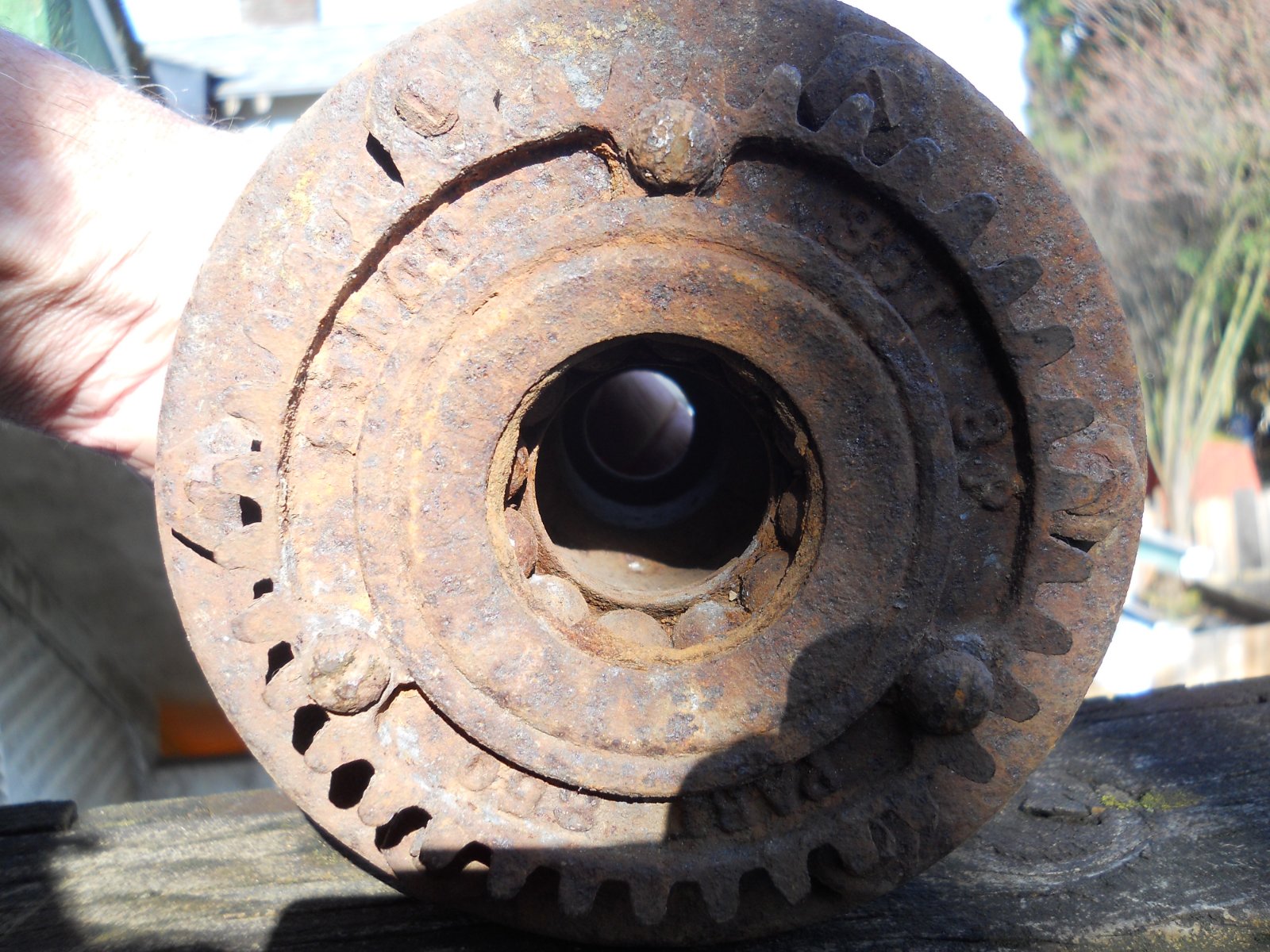

Is this a common enough hub or worth fixing, or trying to?
I think this is about 1915/16ish machined with Jones gear. If worth trying to fix I have an idea, but looking for input. The only crack I can see is in the bearing cup which is not seated and cocked a bit. I think most of the dented part is more in the threaded end.

Later than 15/16 and not worth fixing in my opinion, easy to find good ones.

Yes I would agree that this is better as an anchor for a model boat or the scrap bin, or maybe a "work of industrial art"
Keep the speedo drive gear from it though. That is something harder to find and unusual.

Hub: junk
Gear: marginal/poor regardless of rarity...I think once cleaned up, it would be kind of tough on the fiber gear. If you had a source of fiber gears, and couldn't find the drive gear (this) then it is worth using.

Ok thanks. I will take the gear off first, then too the scrap bin it goes.

I think the hub is 1917-1918, the last of the hubs machined for a speedometer gear. It shouldn't be too hard to find some good ones. You'll want to apply a die grinder and make notches for removing Timkens. Hubs of that era used roller bearings, which didn't require notches.

The machined hub is very useful when mounting the Stewart 8685 gear (60T8P) as the gear fits snugly and centers this gear onto the hub. I know John McLaren used this hub with his wire wheels so a speedometer setup could be easily installed with his wires. Granted, it is not a 1915 hub, but it is desirable. I would not toss it in the scrap bin. I hope this helps,
