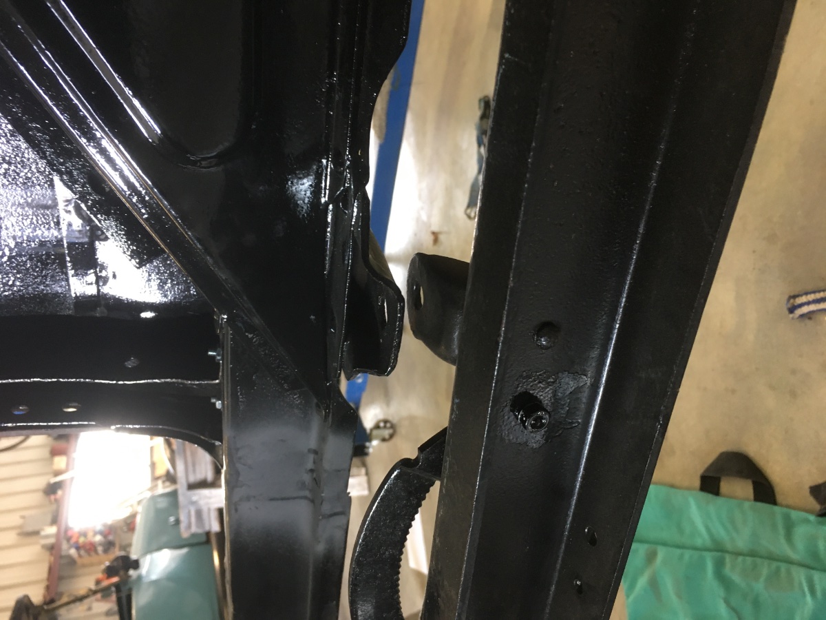

As a preview, this is a survivor 26 roadster that has been much hacked upon that I’m trying to resurrect as a roadster pickup. Bottom of cowl and cab patch panels have been welded in. I have found evidence a previous owner also welded in new front cowl supports (the triangular uprights down by driver/passenger outside feet) on the body subframe and think this might be part of my problem now. I have bolted the body down with the body wood pieces in place in front of the seat pan, under the seat, and at the back spring perch. So now I’m attempting to fit doors. The drivers side seems close and needs only a little tweaking to latch, probably in the hinge area. The passenger side is WAY off! It almost seems the body subframe needs to be cut/bent and re-welded to make the door opening correct.
Here’s a pic of the front body mounts, are these supposed to have a block between them before bolting up? Here’s a shot of the passenger door...yikes...

The front body mounts do not have a wood block.

That’s what I thought, so pulling/bolting that mounting spot together just pulls the cowl down even more and opens the door gap even farther.....

By frame replacement, I assume (or hope!) you're talking about body subframe? This was a first test fitting and I reckon I need to make sure the wood blocks sit down tight against the chassis when the body bolts are tight in the mounting ear. And I guess I can check the gaps where the wood blocks sit on the chassis frame and see if that gap matches the front mount gap? Should that space be equal?

Frame check turned out OK with check measurement methods I found on the board here. One other question, the body blocks DO need to sit right on the chassis frame, right? After tightening the body bolts down, the wood still sits about 1/8' above the chassis frame top, so I reckon some sanding is in order around the chassis frame mounting ear?

Asking this question again in this same thread, hopefully folks will read down to here. Here’s a few picts of the new body blocks under the body subframe, showing how high the body frame sits above the chassis. Should these blocks be sanded down to close this gap? Should the blocks actually be sitting on the chassis as well as the chassis mounting ears? I guess it shouldn’t sit down far enough to have the body frame member touching the running board bracket, so the block should hold it up proud of that?

Sometimes sanding down your blocks causes other problems such as the hood/firewall/radiator etc not fitting correctly. Instead use plastic horse shims that are used in commercial doors. You can buy them at the major box retailers. Will make things align better anyway, you can adjust where need be for perfect body alignment.

Just wondering if there was a “too high” point for body to be above the chassis because of block thickness....
