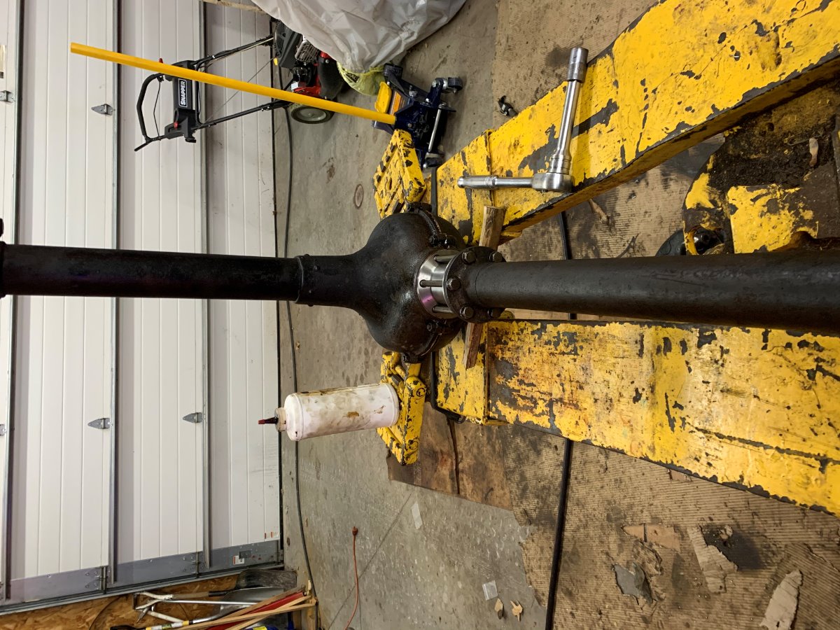

Here's how I did it:

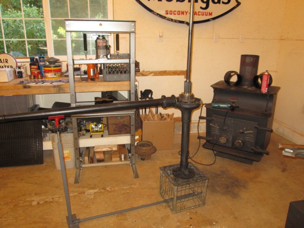

Being slightly "vertically challenged", here's my test assembly station - old steel milk bottle crate, some tubing and an adjustable collar for height to hold the torque tube. I use this for setting the r. & p. then after removing the d.s., assemble the other half on this set-up, remove by engine hoist or similar assisting device & set onto jack stands, re-assemble radius rods & torque tube/d.s. & set on to a rear axle dollie w/wheels to roll back under the T.
