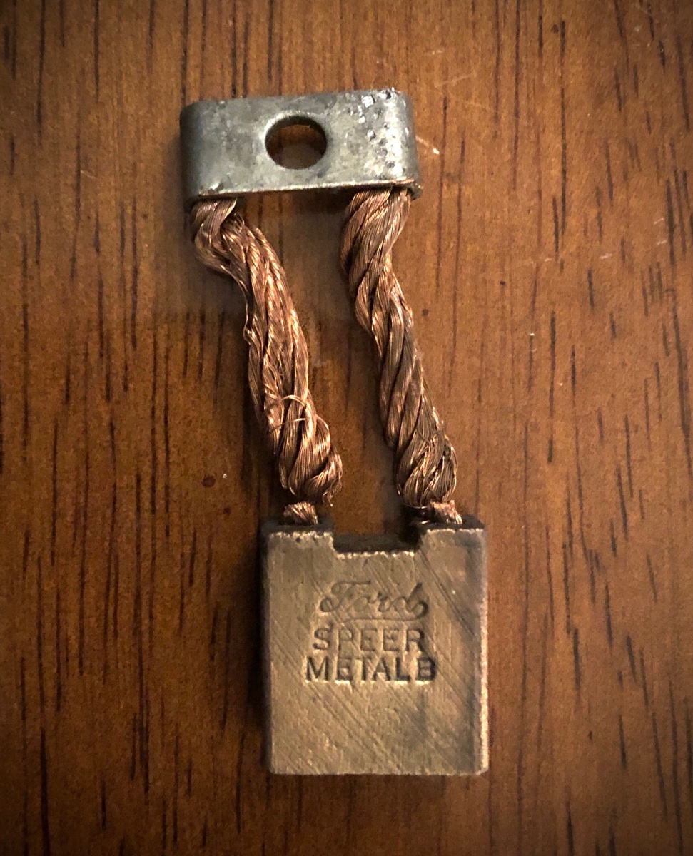

LOL ... sure guys, I know how to reset the timer. And it works great so I may do that and keep the ones I ordered as spares. Only thing is that this one has a pretty string spring and might wear out the timer faster. Just thought something like that brush would be pretty standard. Here is the vintage brush I installed. A little different than the modern ones. Has the piece that staticky out off to the right in this picture.
Mark Osterman
Topic author - Posts: 1014
- Last Name: Osterman
- Location: Rochester, NY
Re: New Day Timer Brush
A little iPhone glitch at the end there ...meant to say the little piece that sticks out to the right is different than most.

Mark: The picture you posted of the brush is not the same as a NOS. Sorry. The brushes on originals had a slightly different size, and God knows where they put the slot for the brush these days. I've been using originals for years, so I have no problems. I recently had some bushes duplicated out of an electrical brush material that contains 1% carbon. Haven't tried one yet.
- Posts: 3909
- First Name: Larry
- Last Name: Smith
If you'll look at your picture above, the bottom of that brush is not the same as an original. Again, check the pin slot and see if it's in the same place.

Well, here is an update. As I suspected the NOS brush I put in my New Day Timer was set at a slightly pitch than the new ones I recently got from Langs. It threw the advance off a little. When I replaced it with the new brush from Langs the advance lever was exactly where I had set it back when I first installed the timer. Now ... wonder what that brush was made for. Looks like the ones used in the New Day timers except for the extra bit of metal off the back .. and of course the different pin location.
