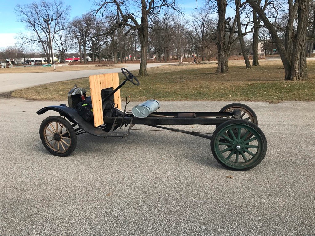

I just picked this up from a buddy. It's got a 23 motor in it so I'm guessing that's what I'm going to call it. It runs, drives and stops. It has a True Fire ignition, solid rear tires, solid frame and a Texas T alternator (not hooked up). I've driven it up and down the drive sitting on the gas tank.
I'm thinking it is over heating as steam comes out the radiator cap. I've got to fab up a cab and bed. One of my rear wheels has a wooden fello that has shrunk back from the metal rim, the spokes are solid. I'm going to get a court ordered title before I start putting any work into it, it's going to be a dad and lad (13 year old) project.
My main question is how does the cab and floor board attach to the frame? Anyone have any good picts? I've got it figured out how to build the bed but want a cab built first. I've got a windshield for it too.
Then I've got to get that rear rim sorted out. I'm planning on putting some verier around the outside diameter of the wood fello and press it back in. Some say not to do that, but the thing only goes 15mph.

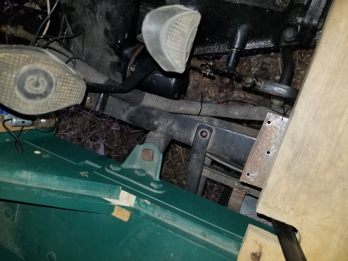

I like the looks of the C cabs and I'm looking for something easy to make. I've got 4 tabs on the frame that I think are mounting holes for the cab, but I'm not exactly sure how the cab and floor attach to them. I'm 6'3" so I'll probably extend the cab a bit to make it adult sized.

My cab and bed are both bolted to bearers that run the length of the chassis back from the firewall. These bearers are bolted to the rear cross from, the large 'lugs' just behind the petrol tank and to the lugs just behind the firewall. An extra angle bracket is used to fit to the front lugs (just like in Dallas' post below).
The cab and the deck are built on these bearers. Dallas' cab is separate I think? Both possibilities will work.

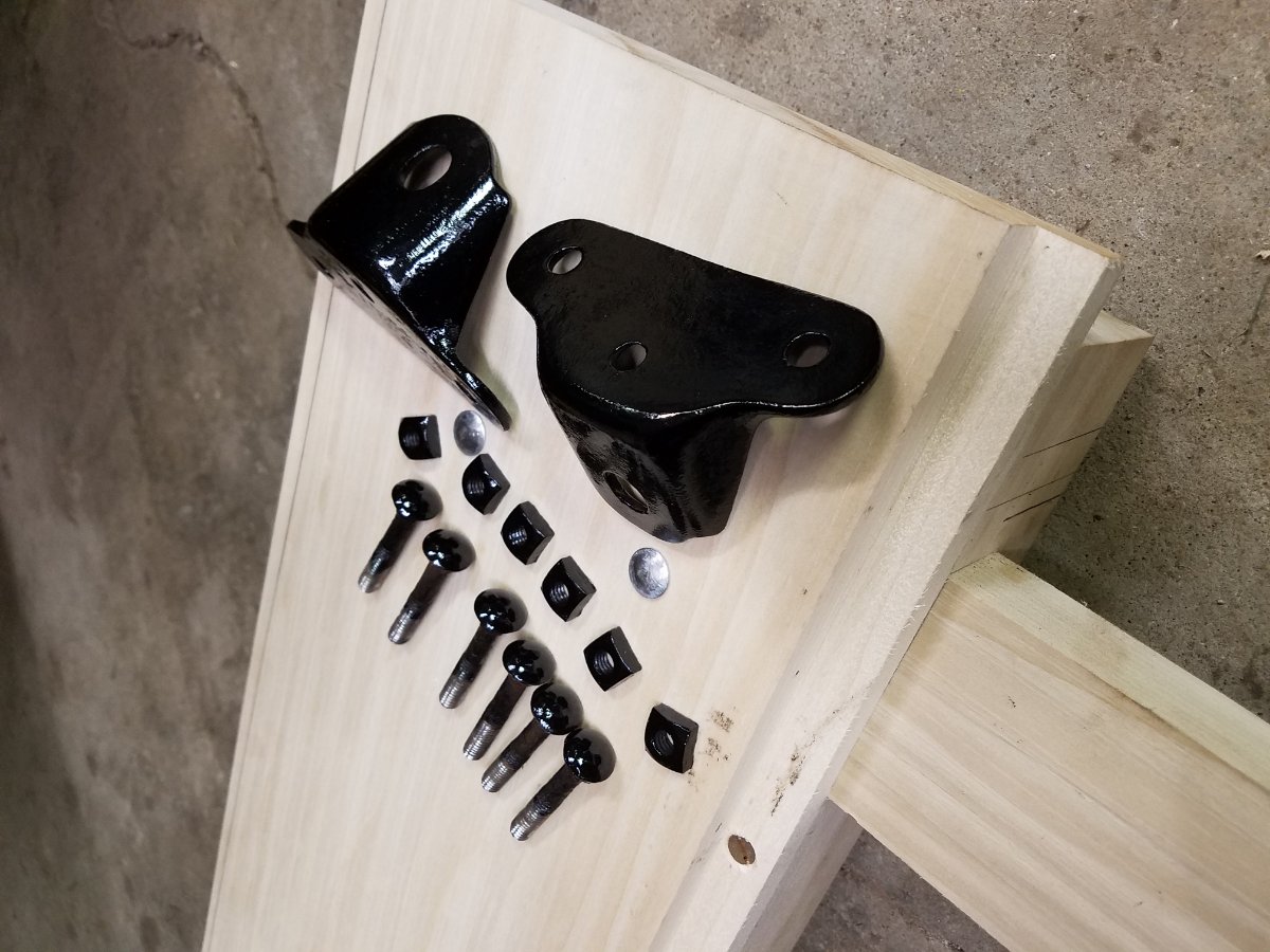

This is the main floor for my wood cab and brackets to attatch to frame tabs. Bracket bolt to the main wood runners on floor system.
Its hard to see in photos when all together. The most critical part of the floor build is the angle and placement of the front portion so peddles work as they should.

Re: My 23 TT project
Post by Dallas Landers » Sat Mar 21, 2020 7:05 pm
Very easy to make some. These came with another wood cab I have.

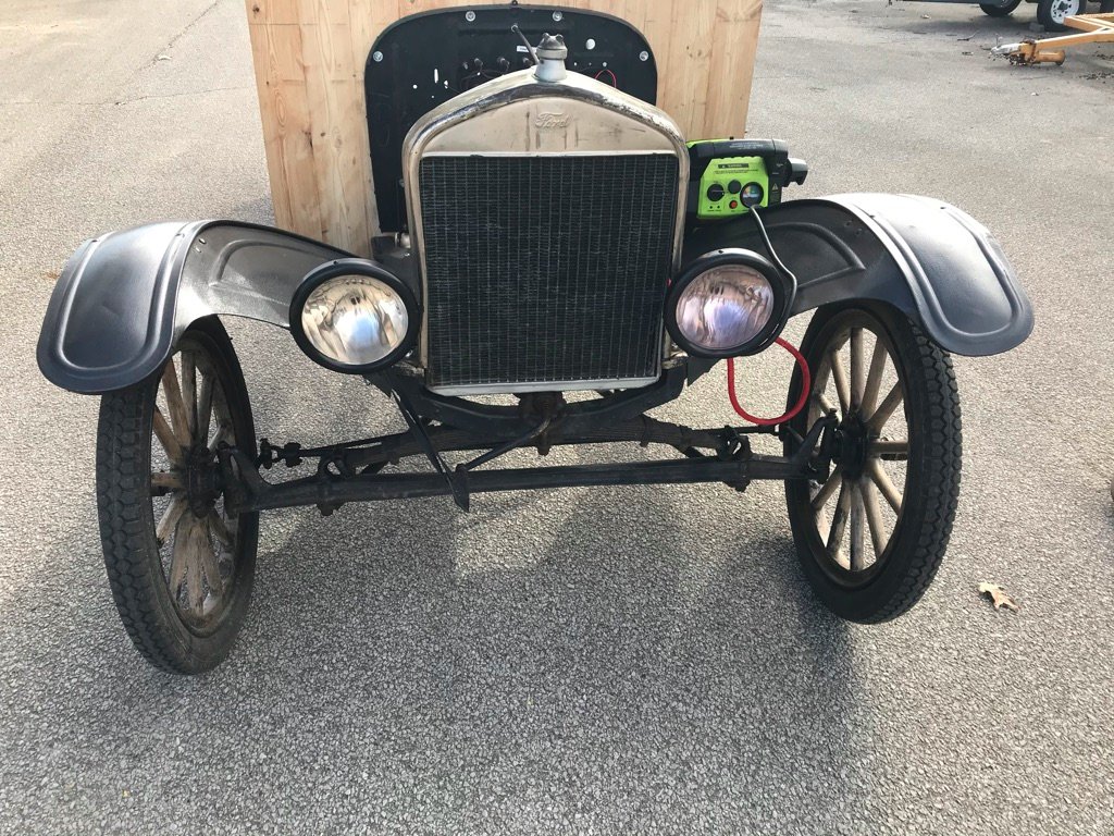

I'm not convinced it's a '24 or newer just because it is currently sporting a high radiator/firewall. Contradicting that opinion are the short running boards.
Some things a photo of might help get a better idea of the year it was built:
1. The rear end' Clam shell bead at axle tube or not.
2. Rear chassis cross member 1 hole or 2 on each side.
3. Horn button on steering column.
4. Patent plate on fire wall.
These things will not date the truck exactly, but will give you a better idea of whether it's an early TT or one from a little later on. You may never know for sure what year it is, but for legal purposes it's a 1923 Model T Ton Truck!

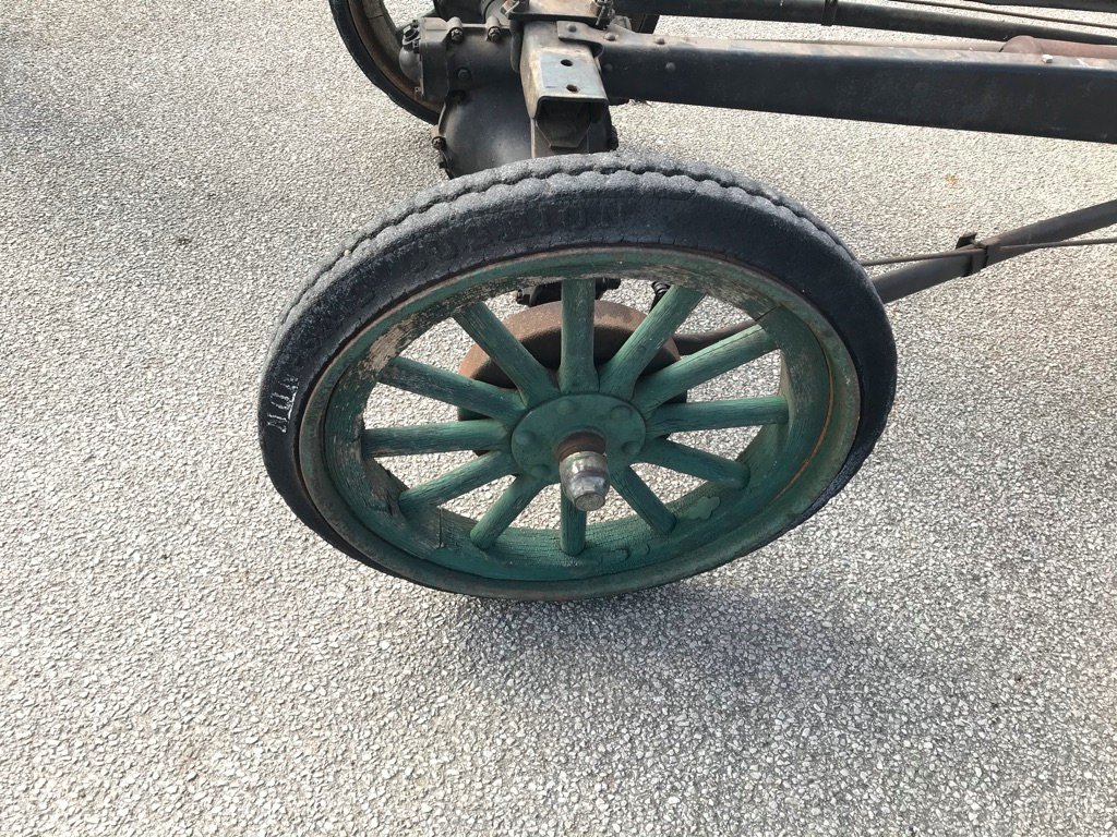

Here's a couple more photos. There is no horn button and the patent plate is unreadable.

These latest photos would indicate that it is a later TT. The longer chassis rear cross member with 2 holes on each side, the absence of the bead on the clam shells and the oil plug on the top of the rear end cap (early units didn't have this) all indicate a later truck.
This all makes me curious about how it ended up with those short running boards. Of course, it's nearly 100 years old. Anything could have been done to it over that much time.

Right, 100 years is a long time and there are no numbers on the frame, so I'm going to have to title it as a 23 due to engine numbers. I guess it's a frankentruck?
Are the solid tires typically on older ones?
