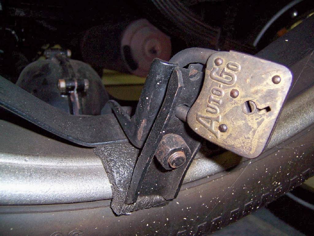

John
Could be a new rim, looks super nice....however, not mine. Photo snagged off older forum posts...can't give credit as didn't retain who posted.
Here is mine, original rim, alum spray paint for shine
Non-original piece of black foam plastic for anti-rattle.

Mine look like yours also Dan! Thanks.

Dan, thanks for these two photos. It clears up a question I've had for awhile. Most people are missing the clamp piece and they just align a lug to the hole on the frame and bolt through it. I've looked at factory photographs to see what was right but I hadn't seen what I was looking for.

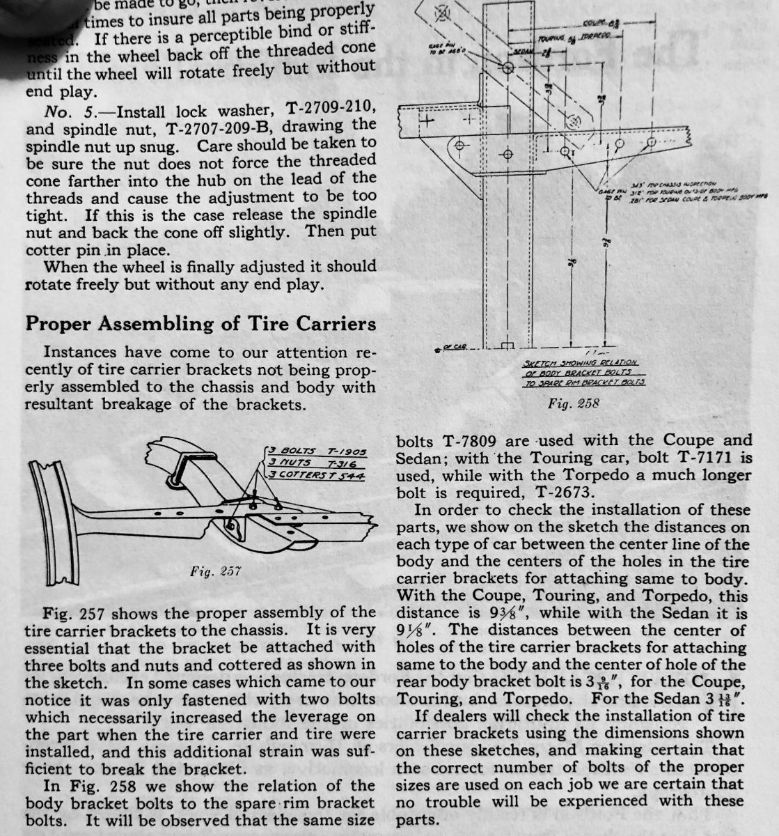

Good to know what the other hole in the clamp does. Say the 3/8 ths OD is too big 5/16th's fits...
- Posts: 4042
Re: Spare Tire Carrier Bolt Sizes, Mounting?
Your are correct on the 5/16"x 24 thrd. Parts book shows length as 11/16", but some additional length is needed for certain body styles, date of this Service Bulletin is Aug, 1921.
These earlier carriers were slightly different than the later, esp. in the crossbar design to hold the license plate and taillamp. Of course the '26-'27 got completely different rim carriers.
