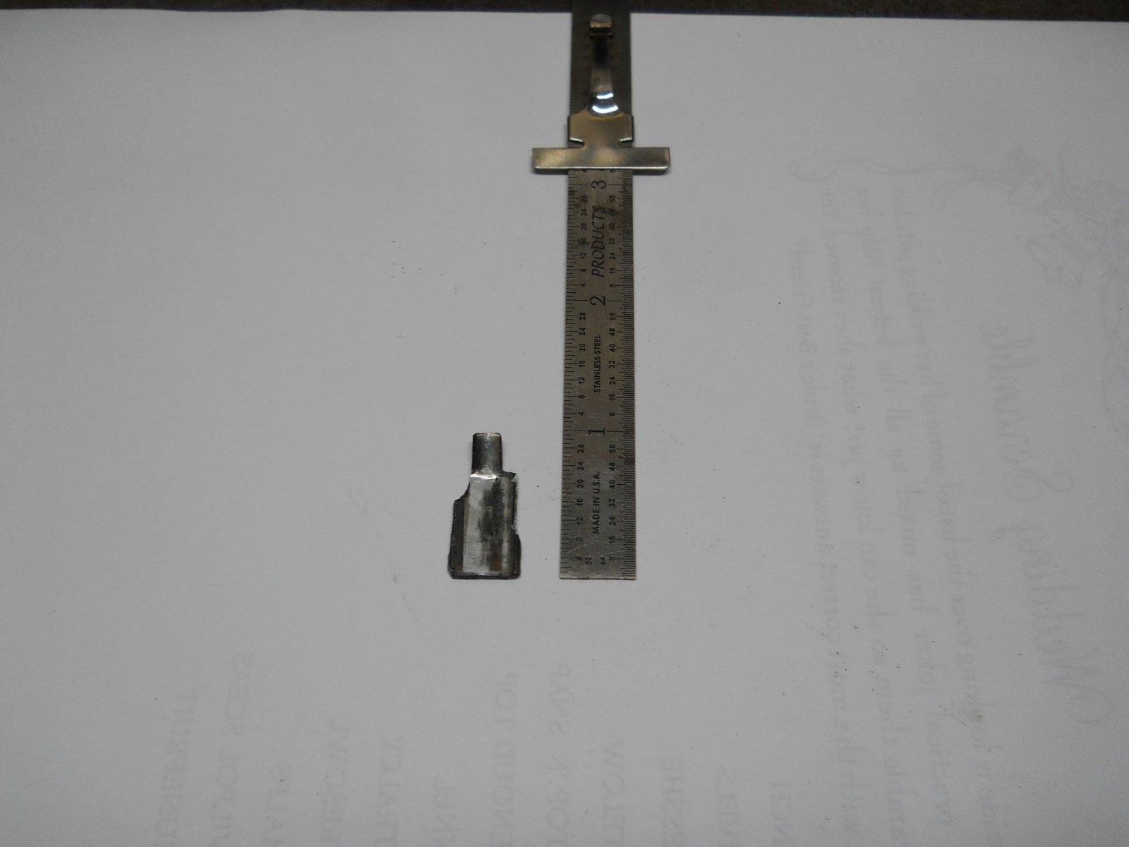

where did this come from???
I found this in my oli screen...scary...any thoughts? thanks rl

My best guess is that it is a clip that goes inside the brake drum that the clutch discs ride on. If that is what it is there are more pieces missing. This part would only be in late 25 to 27 transmissions.

Think I will take that back. There doesn't appear to be a detent to ( lock ) it in place.

Re: where did this come from???
my low gear makes bad grinding noise

Might be a chunk out of your low drum ?

THAT HUNK OF STEEL LOOKS VERY MUCH LIKE THE TIP OF A BAND, THEY DID MAKE THREE TYPES THAT I KNOW OF BUTTON---SLOT---AND I DON'T KNOW THE NAME OF THE THIRD, BUT THE END OF THE BAND LINK HAD A TAB THAT FIT INTO A HOLE , I WOULD LOOK AT YOUR BANDS. HOPE THIS IS HELPFUL.

Whatever it is, it looks as if it's been through the gears, hence noisy low gear??
Can you post a better, larger picture? One that fills the whole frame? I know we can click on it and zoom, but still it's hard to decipher what we're seeing.
- Posts: 4529
The shinier side of the piece looks like it has a curvature to it going by the pic. That makes me think of a piece of one of the drums. Maybe take the transmission inspection cover off and have someone slowly turn the engine over to what may be broken? That’s what I would do.

How thick is it? Is it steel, or cast iron?

Well I found out what is was a part of...transmission brake drum shoe...which let the steel clutches get bound up also..and took out two teeth on one triple gear a 0ne tooth one another...it's been a fun day...that's why they call it a hobby....Happy motoring rl

Kudos to Steve M for diagnosing it right away. Steve, I'll bet you can see the detent now, knowing that you were right...right?

I do not know the age of the clip...strange thing is it was the only one in it...and the pressure plate bolts were not wired and loose...the clutch disc were about all sticking together and very blue...the truck was running fine the morning this happened went out after lunch and bang grind grind bang so I shut it down and pulled it back in shop with tractor...took engine out and down and found the part of shoe and no other steel pieces and four teeth broke from two triple gears and found I think a bent or cracked tooth on the driven gear and skinned up my coil ring just a little....odd to say the least...however all is cleaned and repaired just waiting on new clutch discs, gaskets etc...( I did find that the triple gears were very loose on shaft from worn bushings, new bushings a good gears fixed this.) I think sometime in past someone made mistakes putting this together...rl ( The dropped magnet a couple of years ago was much worse)
