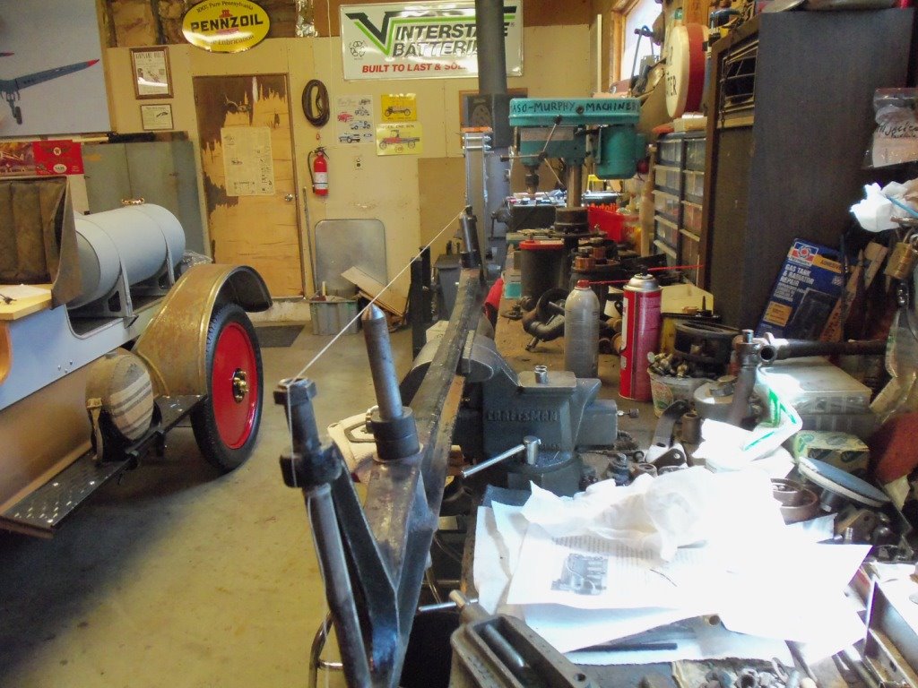

Need o search the old forums to see where I got these photos
- Posts: 7335
Re: Front Axle Alignment Tools
Here's the rig Bud Redding uses. Rods through tapered plugs that center in the holes.
I have used twin tapered collars with thumbscrews on 3/8 rods for many years. Very similar to the picture above.
You can tell immediately if the axle is twisted. Very easy and quick to turn out on your lathe.
Harry
