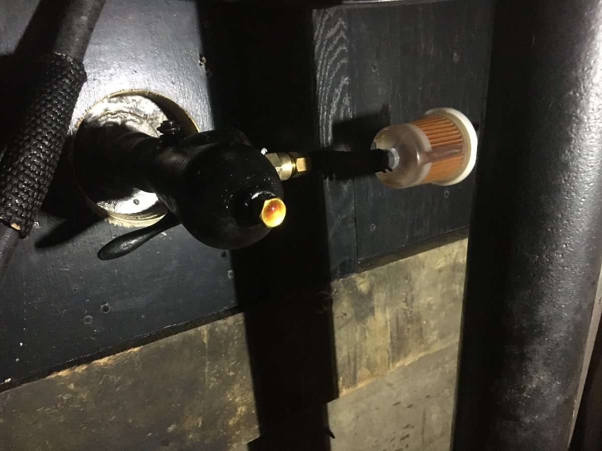

Here’s a picture of the suspect at the moment
You can see how much stuff that filter has collected, that dark stripe in the bottom is all sediment.
I’ll patch in a hose to try it first, and then today is probably going to be the day to replace the copper line with steel

I see that you put in some new gas just before this happened. On one tour a few years ago we stopped and filled our gas tank at a station along the way. Some other cars also got gas there and others got gas at another station across the road. After we got the gas, we sputtered along and had problems. We drained the sediment bowl and it ran better for a while. After we got good gas later on, the problem disappeared. There must have been some water in the station gas tank. The other cars which got gas at the same station also had problems. There might have been some sediment in the gas at the station and if the tanker had just filled their tank the sediment could have been stirred up and some got into your tank which clogged the filter. Modern cars usually have a float inside the tank and the gas is drawn into the car from the top of the tank. But in a Model T the gas from the bottom of the tank goes first into the fuel line. So if you drain some out of the sediment bulb, most of the bad stuff will be drained out. However if you have an inline filter, the bad stuff will go in and clog the filter.

drained the sediment bulb, removed the plug to clean the screen. There was more teflon tape in the sediment bulb than sediment. Someone used the teflon tape to install the side plug, rather than the lead gasket.
the screen didn't clean very well, so...I'm going to order the proper sediment drain valve (it has a plug right now), new screen, lead gasket.
Once I get those parts I'll run a new steel line with no modern filter, and I'll report back in a week or so.

Post by Steve Jelf » Sat Apr 18, 2020 3:33 pm
If the tank is infested by rust/dirt fine enough to get through the screen, you'll need to get rid of that too. BTDT.

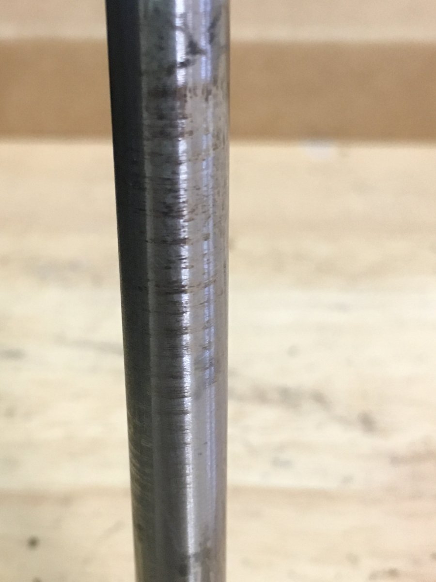

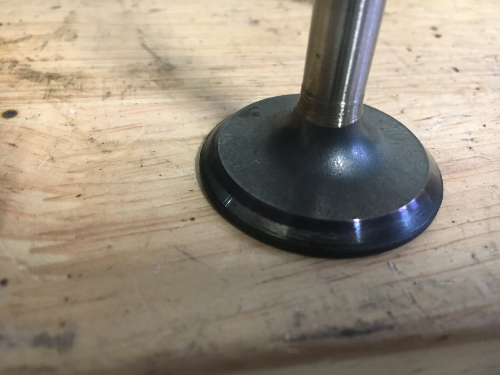

Post by Wayfarer » Fri May 29, 2020 7:37 pm
bringing this one back to the top again
finally tore into the engine today, after the Seafoam treatments made no difference.
#3 exhaust valve stem shows evidence of "chatter" indicative of a sticky valve (could also be that the guide has been knurled, and the valve was stuck in place, leaving behind "witness marks"), and the face shows uneven discoloration - evidence of an eccentric valve or seat, and eventually a burned valve
EDIT 05/30 : cleaned up the valves. several show uneven wear indicating guide issues, and 3 valves have evidence of corrosion. the one pictured is by far the worst. Also - the guides aren't knurled
misfire case closed
