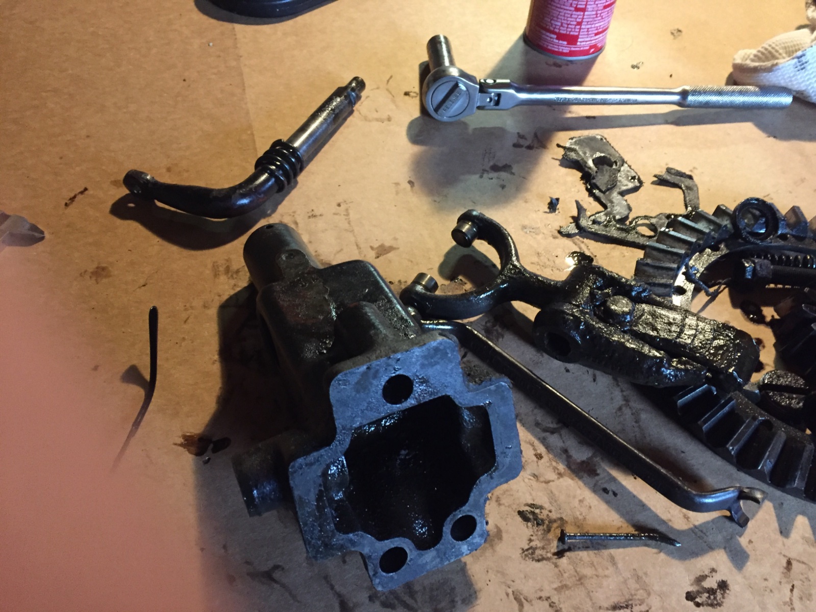

The new gear arrived (thanks Dennis!).
I was not happy with the fit on the old driveshaft, it rocked a lot on the taper, so I scavenged another and cleaned it up. Much better fit !
  The old gear was loose and wore the old shaft.
Hey grandpa, what’s for supper ??
Looks kinda crunchy...had this toaster oven I was gonna pitch, and per some pro advice, I warmed up the new gear to 450 degrees before mating it to the shaft. Modern spool bearing is set with a slight preload...
All ready to setup the housing and move forward.
