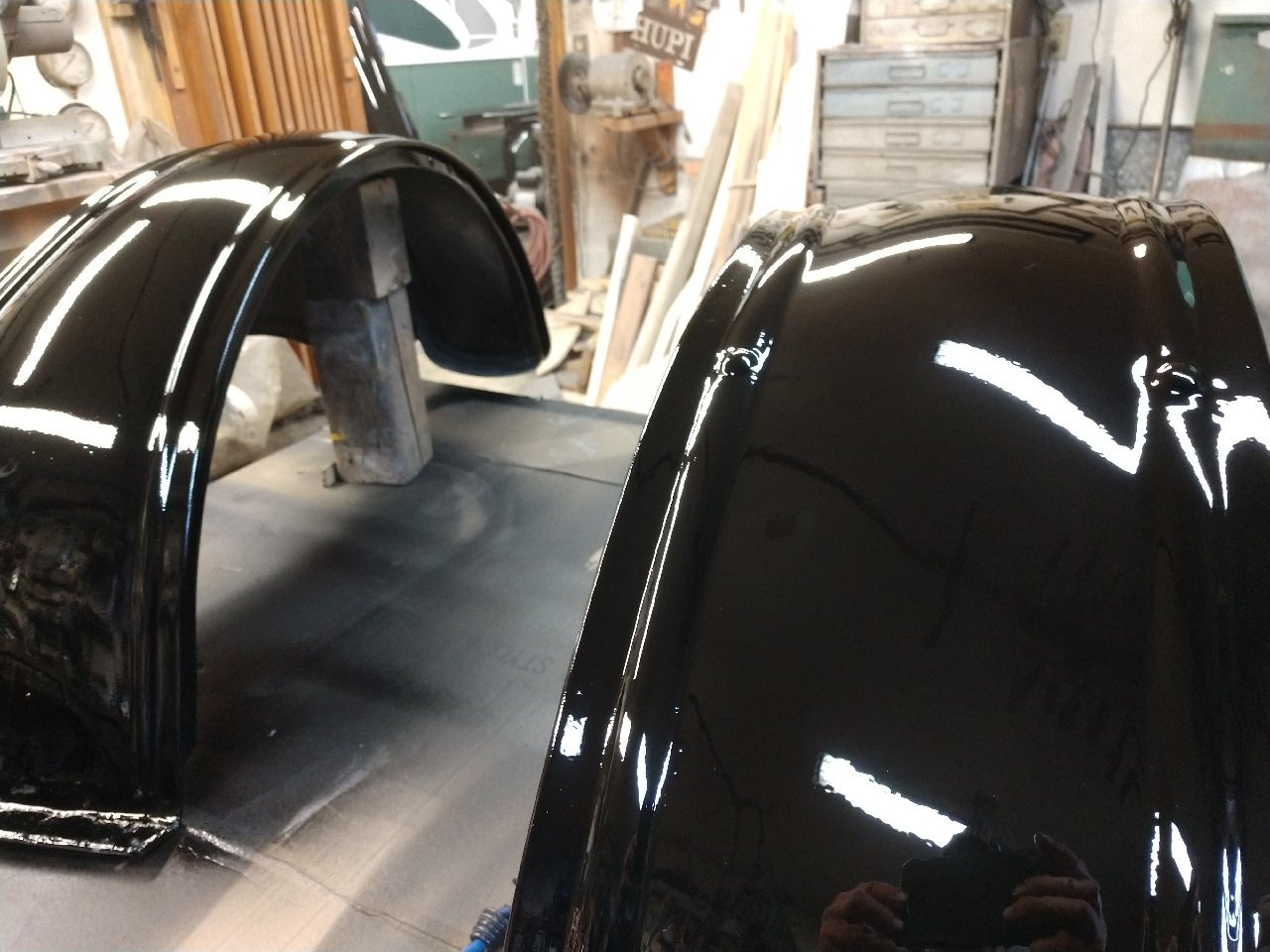

Started to do some painting today on a few smalls.  Painting once a year isn't enough, and it shows.  Still very wet in these pictures.

Re: '16 Centerdoor restore...
Don,
If I could paint that good just once a year, I would be ECSTATIC!!!! Geez, those look great in the photos. I realize, close up, you might be able to see some small defects but the photos look outstanding. Good Work!

Thank you Terry, I probably should have waited until it laid down and dried before taking pictures.   Being that its still wet is shows every little piece of dust in it.  I will have to wait until the morning to see what I actually have here.  Either way it all gets wet sanded and then either clear coat or cut and polished.  Just having fun during the lockdown !!  Hope everyone else is too.
Crowned rear fenders?
Yeah, I question those fenders also.  Mike Husted didn't think they were correct for a early '16 either.  The hood, radiator shell and hood shelfs all appeared to be re-pops.  They had no surface pitting anywhere and the radiator was newer also.  So, more research has to be done on the period before I fork over more money on a maybe.  I would also have to have the flat style fenders of the '15's to see if they would properly fit the deep fender wells on this body.  The fender wells are just shy of 5" deep in the front where they meet up with the aprons.  Talk to me Wayne !
Bruce's book talks about the 1915 -1916 sedans starting on page 201.  It mentions that 1915 sedans had an aluminum body and different splash shields and rear fenders from the "other models", but by 1916 it had a steel body and used the same splash shields and rear fenders as the "other models".  It mentions that the rear fenders were attached directly to the body rather than using irons.  The rear fenders do not appear to be crowned in the pictures in the book.
Bruce's book also has a special section on the entire run of the "Centerdoor" sedans starting on page 287.
Yeah Mark, I've had some long discussions on the body and fenders and the entire car in general.  The FaceBook groups I belong to have no definite answer. They do agree this car is transitional and may very well be correct OR incorrect.  Until I get some solid proof that it's wrong I will go with what I got.  Bruce McCalley's book is very much a gray area for this centerdoor time period.  I guess he even admitted he couldn't be certain what he wrote was right.  It keeps things interesting to say the least.
I had a few discussions with Bruce personally when I was restoring mine. He admitted he didn't know for certain what the '16 model c-d sedans were like, or even IF they were originally built at all. Decent evidence that they were in fact built didn't come to light until after Bruce was gone.
In the first place. It MUST always be remembered that the "true" '15 model c-d sedans and the '16 brass model c-d sedans are two completely different animals. Although they look very similar from a distance (or in most photographs), in details, exact dimensions, materials, and trimming, they are VERY different. There IS reason to believe that a few transitional early '16 model c-d sedans had some carryover pieces. A long-time friend of mine had one that still had its factory installed gasoline tank under the rear seat! However, a previous owner had also installed a later front seat and square gasoline tank because of the fuel flow problems that rear seat tank became famous for. And his car was a Canadian built sedan, so that casts doubt about some differences from USA cars. My car had an identical rear seat structure as did his, and our two were the only c-d sedans I looked at that had that structure. Every other c-d sedan I looked at was different than ours, and I looked at about two dozen of them.
My '16 c-d sedan also had the early '15 sedan fenders on it. Unfortunately, my car had suffered a bad '50s restoration casting doubts on everything about it. There were good reasons to believe it had been the real thing, and a well known San Francisco Bay Area collector that had previously owned the car claimed the rear fenders were what the car had when he got it.
As for the rear fenders. I haven't seen a really definitive date given for when the crowned rear fenders began showing up on cars. Apparently, from past discussions on the subject, the rear crowned fenders started showing up late in 1916 model brass radiator cars. That detail rarely shows in era photographs. Usually, the picture is of some thing or some one else, and we get to hope to see such car details. Rear fenders were rarely ever the subject of era photographs. From many common angles photos are taken from, the crown does not show. Many times, one can "think" they can see the crown or not, but often it is as much illusion as it is a clear view. I have seen a few era photos that clearly did have the crowned rear fender on a brass touring car. But not many. And I have spent a fair amount of time studying multiple photographs of a single car just to study how both crowned and flat curved rear fenders look from different angles. In some of those past discussions, a few people having nice original late '16 model Ts, with good reason to believe the rear fenders were original to the car, have found the crowned rear fenders as early as late June of 1916, and several from July and August. I doubt that any T had the crowned rear fenders before late June of '16.
And as usual for me, that is my opinion from my memories of past discussions.
Ohhh BABY!!  It laid down real nicely.  The morning after results.  Love that paint !
Wow, that is nice nice!! Is this the super paint like the red paint $$$ you used on the Sedan? Good job Buddy.
Basically the same... Thanks Joe.
Mirror mirror on the T, the reflection looks like a fatter me....
It is nice to see someone follows Henrys way of applying paint using a paint brush, garden hose  and dipping. Points should be taken off if they  shine to much, we cannot have that.     Mike
That is a BEAUTIFUL paint finish. I can't wait to see the car all together.

Day 4 of wet sanding....you have to live it to appreciate it.  Uhgggg !!!
Almost done with cut/polish process.  Taking the afternoon off and letting it get a tan.
				FordorGalore
