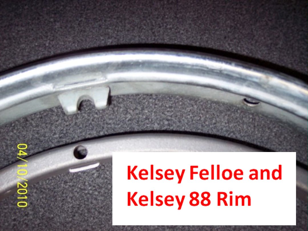

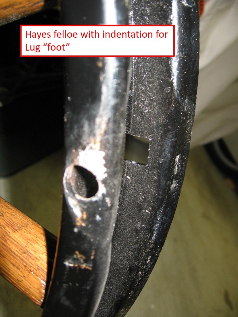

Hayes felloes also use the slightly longer spokes (Kelsey and Hayes were separate companies in the days of the Model T). If you have Kelsey felloes, they will have four slots punched into them for the separate lugs to bear against.
If you have Hayes felloes, they may be stamped "Hayes" somewhere one them. Hayes felloes also have four indentations around the perimeter to allow clearance for the "feet" of each lug.

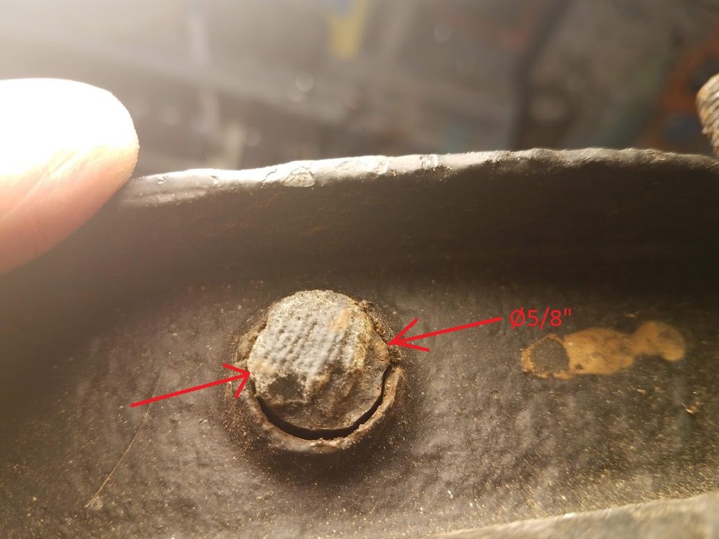

It's a little bit of a mystery why this '27 (April) has 3-1/2" x 30" wooden wheels, but it does. Also has older style water outlet / fan setup. That aside I still need to re-spoke the wheels. The tenons are Ø5/8", but I still don't know how to verify the fellow diameter to determine 'short' or 'long' spokes.

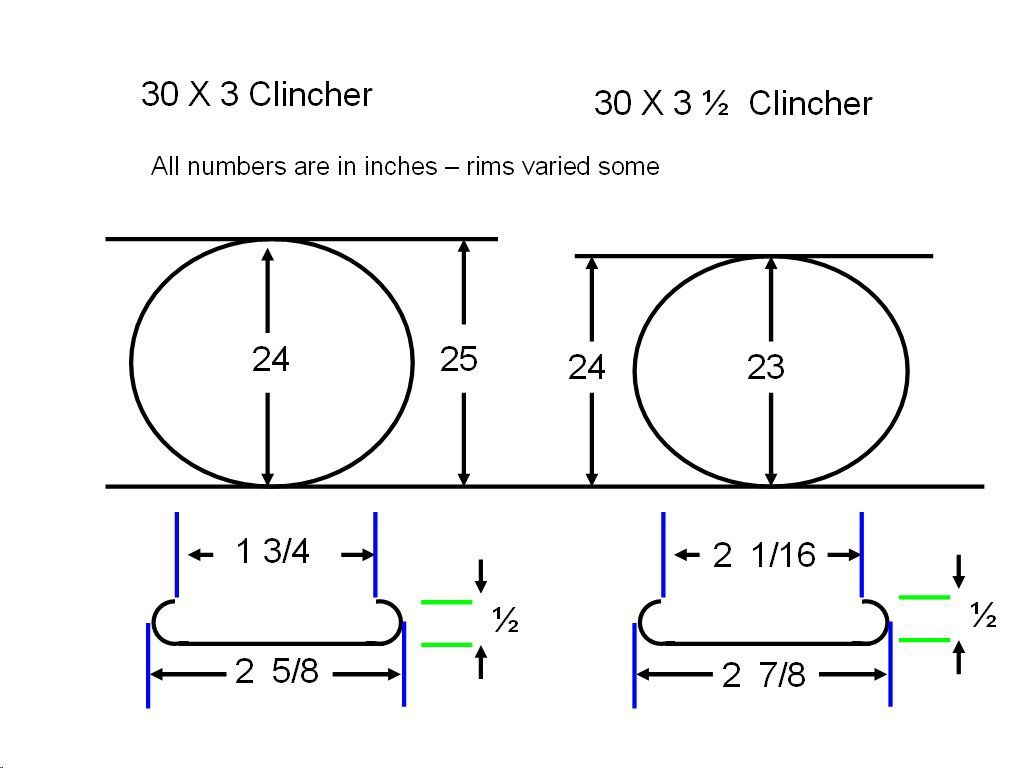

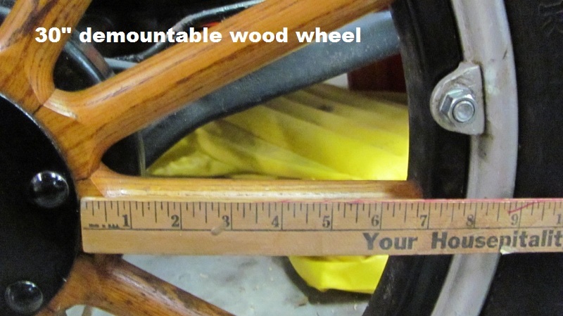

Your spoke length would be typical for any 30" x 3 /12" tire demountable rim wood wheel.
The actual rim diameter is larger than the rim diameter of the split-rim demountable balloon tires, which are 21" tires.
Your 30" diameter for clincher tires.
Spoke length is shorter for balloon tires.
Ref. for both sizes of clincher rims:

Lang’s 2019 catalog tells you how to determine the difference between 30x3 1/2 Ford or Kelsey Hayes felloes. It says the Inside diameter is only 1/32 “ difference. To me they go into detail how to tell the differences in the spokes for a paticular type of wheel. Whichever it might be.
Posts: 6804
Re: Re-spoking wood wheels
Post by Scott_Conger » Thu Apr 23, 2020 9:34 am
Well that is a bit of an odd duck. Anyway, here is what John is talking about in the Lang's catalogue: https://www.modeltford.com/item/2800HS-5/8.aspx
