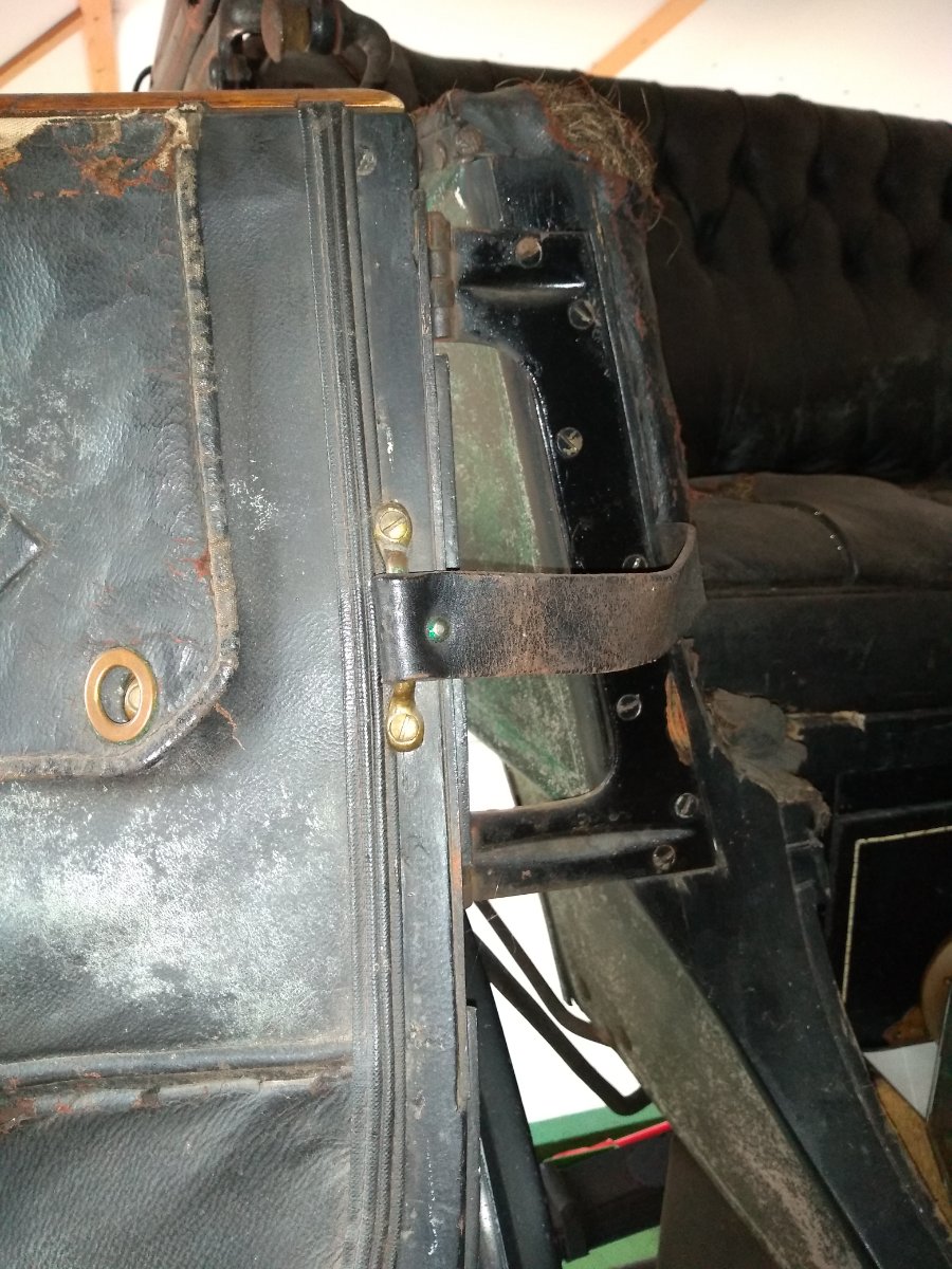

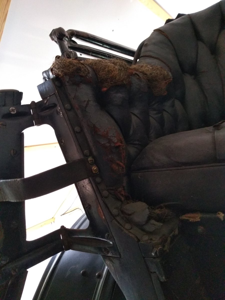

Re: 1909 door check straps
August 09 Beaudette alloy body, believed never responded or retrimmed.
Shoul have said never rewooded! Spell check!
Hello Jem:
Thanks large for these excellent photos...great looking original car. I will check with Russ Furstnow to see if this style of strap is one of his leather products. Mine has a similar door panel with the footman loop.
