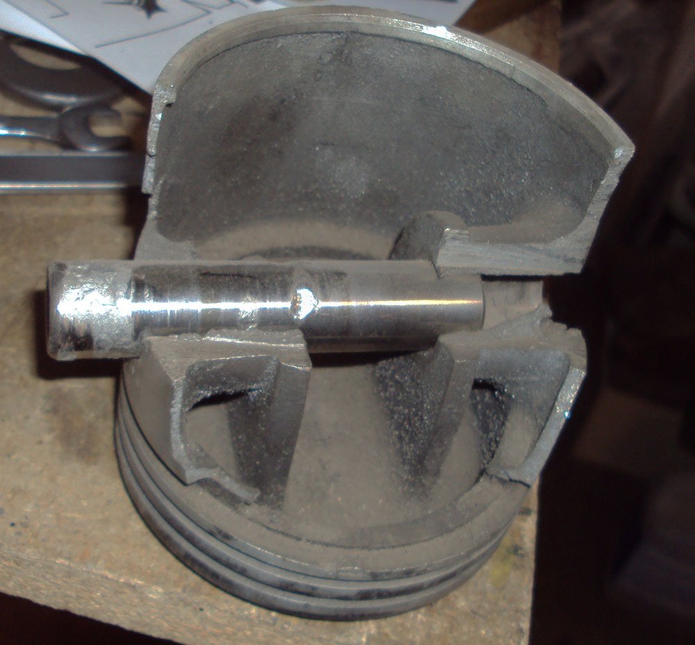

Post by Rich Eagle » Sat May 02, 2020 2:52 pm
This piston locked up the engine and stopped the car. The pin bonded with the piston and I had to cut the piston to get the pin out to remove the rod. The other three never had a problem but try and buy one piston from a dealer.
The engine ran fine for a few hundred miles before this happened. It was a very cold day but I doubt that affected anything.
I wouldn't have believed it if it hadn't happened.
Posts: 6732
Re: Piston pins
Post by Scott_Conger » Sat May 02, 2020 3:19 pm
that had EVERYTHING to do with it
what was a too-close fit at 70F and too few miles to wear in, a very cold day would shrink the piston right onto the pin and eliminate virtually any boundary lubricant
holes grow more than pins when they heat up...what happens when they get cold?
Yup.
Joe Bell
Posts: 1200
First Name: Joe
Last Name: Bell
Location: Tiffin Ohio
Re: Piston pins
Post by Joe Bell » Sat May 02, 2020 5:33 pm
Rich, those where the Jahns pistons, they where made out of any aluminum they could find, I saw one that did not have crap for compression in a cylinder, tore it down and I could see through it on top from porosities in the aluminum.
