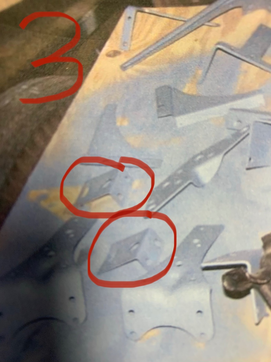

I am in the process of putting my Fordor body together and have the following questions please.
Question 1 From the attached pictures taken from Ray Elkins 2009 restoration I need the dimensions of the brackets that are just flat sheet as pictured 5 in total 2 are the same as each other. Also the location of these would be help too please.
Question 2 Does anybody know the location of these triangular shaped brackets. The ones with the curve.
Question 3. Are these other triangular brackets for a Fordor ? I cannot see them in the group of brackets that Ray Elkins posted in 2009.

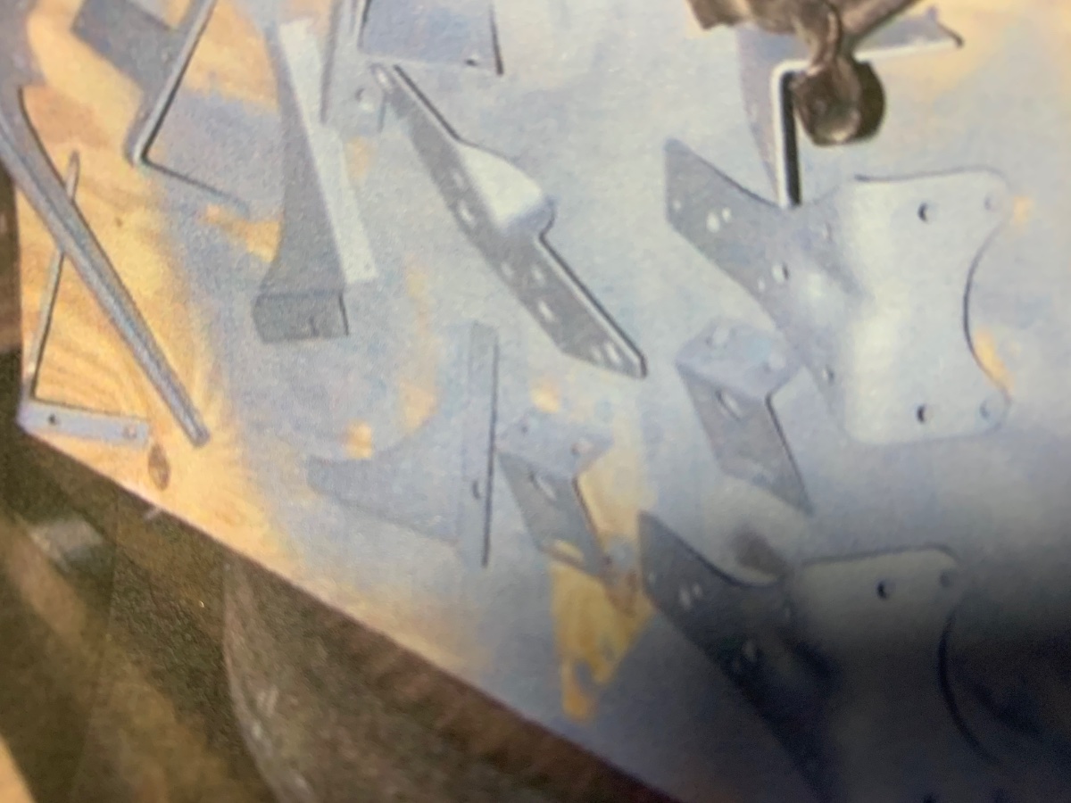

I have labelled the photos now
#1 looking for the location of this one. It’s a pair and I assume a corner brace
#2 not sure what these ones are
#3,4 these are not my pictures and I am missing these 5 brackets as circled in red 2 are a pair and am looking for dimensions and locations
Thank you

This image might be a little clearer. J.P.

Post by FordorGalore » Wed May 13, 2020 7:11 am
Picture 1 that bracket goes on the main base of the car. Its a corner bracket for the cross-brace.
Picture 3 are the brackets for the main base that attaches the floorboard support (at both ends) between the battery access and the passenger side
of the floorboards.
The very top picture of the thread is the cosmetic plates that covers the wood in the very lower rear of the rear quarter windows.
You also have the C and D pillar supports that to connect to the main base frame on the inside of the bottoms of the pillars.
I can answer just about any other questions you may have if you want to PM me your email or phone number. Feel free to do so...

All main frame corner brackets mount on the underside on the main wood base frame.
