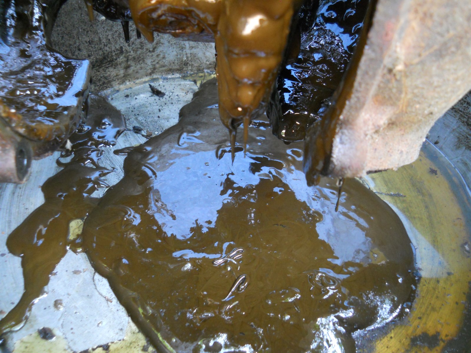

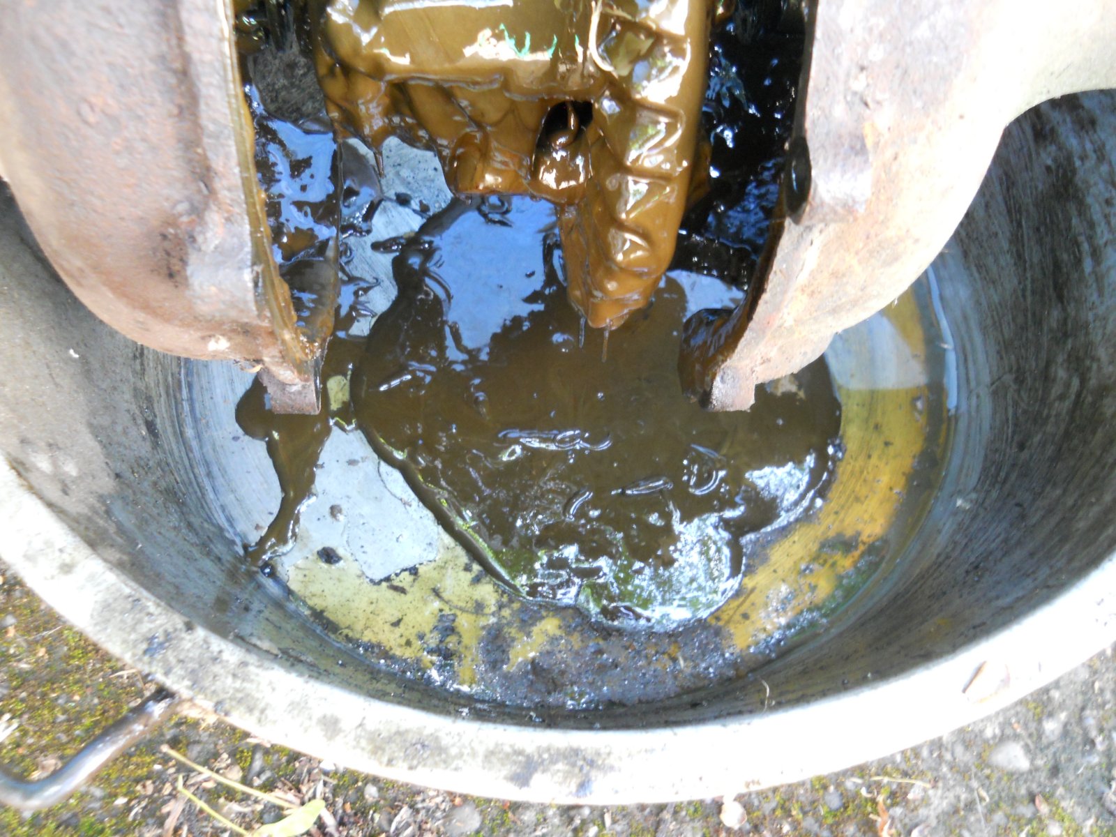

- Posts: 5442
Re: Differential oil measurement
Once the flowable grease get inside the works, it's going to take a while for it to flow out. This rear end has been sitting up right for a couple of months and maybe in the 6 months I have had, turned the drives shaft less then two roatations. I wish I knew what type it was.
