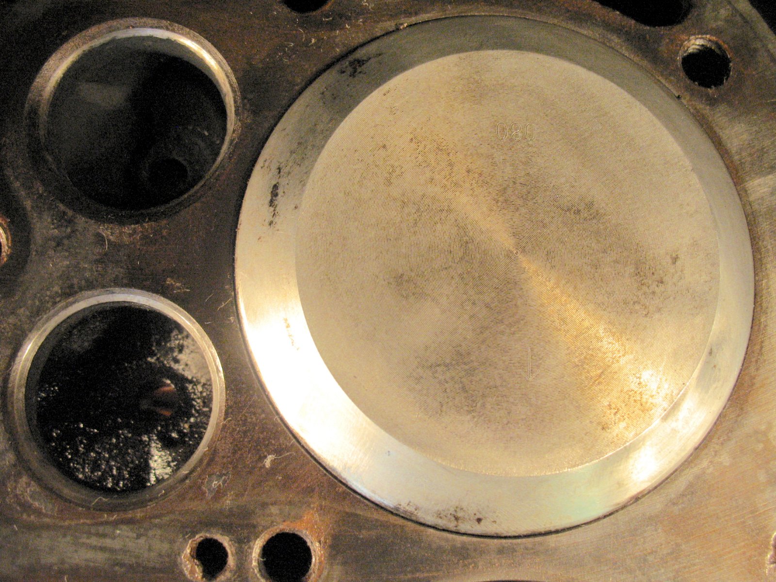

Here are the piston tops in order—1, 2, 3, 4.

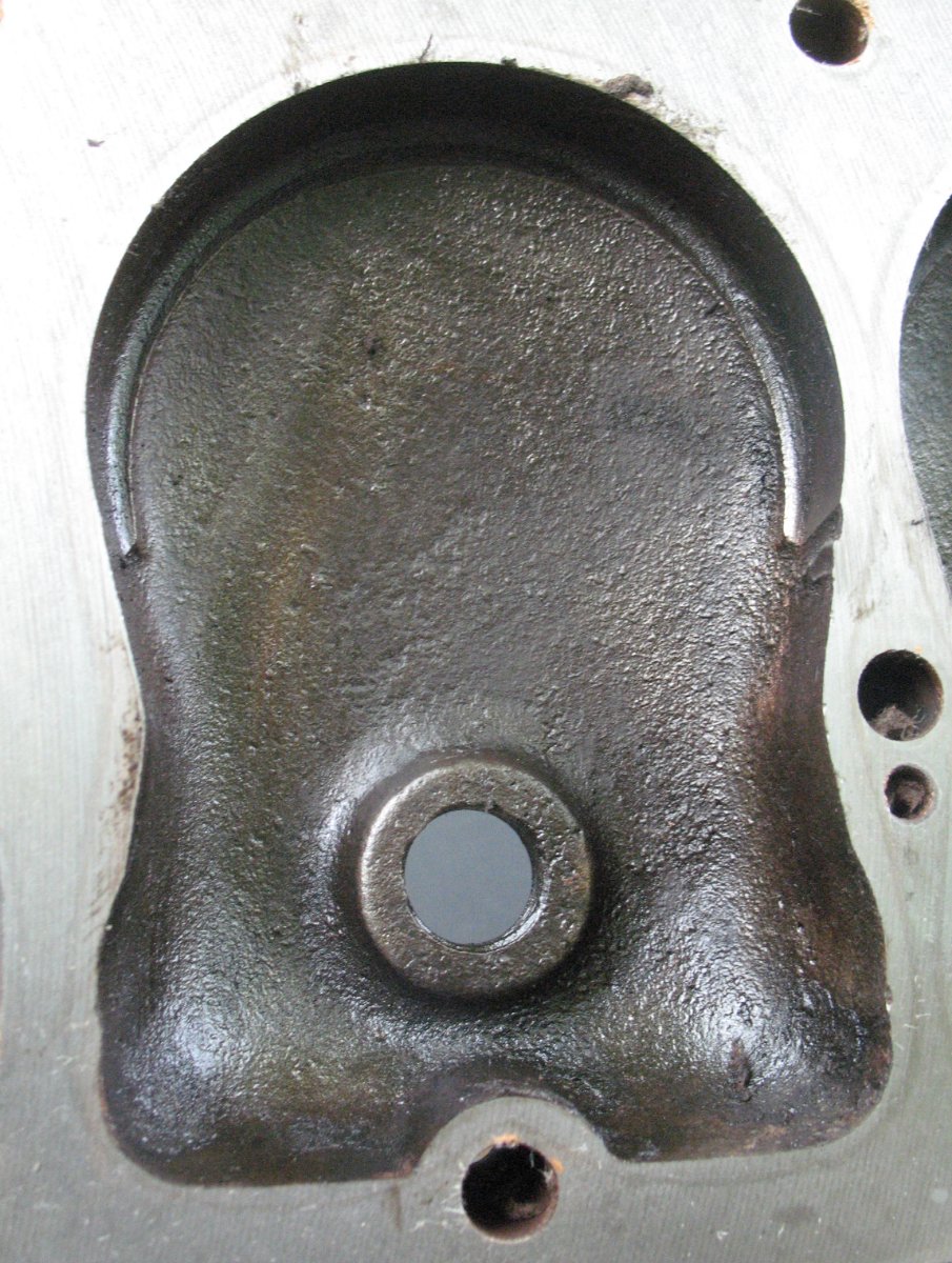

Head chambers. I wiped them but didn't wire brush or blast. Again in order—1, 2, 3, 4.

Post by Jerry VanOoteghem » Thu May 14, 2020 2:50 pm
Steve,
Your valve seats look way too wide, deep & out-of-round. In short, they're used up. I believe you should have valve seat inserts installed and most likely new or reground valves. Even if the rings weren't bad, my experience has been that the act of just removing the pistons, then putting them back in, reorients the rings in such a way that their wear patterns now do not match those of the cylinders. Along with new rings, a touch-up with a hone is also in order to help the new rings to seat. I don't feel that the cylinder wall pitting is a huge deal. Would be nice if it weren't there, but I wouldn't bore the cylinders to get rid of it.

The vertical scouring bugs me.On a 2 cycle engine if you can even see vertical scouring it will affect a engines running.The ring can't seal that vertical mark. I would be wondering what caused it.

I'm happy to allow that it might be a camera illusion, but:
What I see in all the pictures of the valve seats, is that they are not concentric. Every one of the seats seems wider on one side than the other. It's as though they were cut with a tool whose guide shaft was bent. Or it was loose in the valve guide, and the operator leaned it to one side.
This can't be good. The valves are more or less free to rotate, so they can't adapt to a non-concentric seat.

Now your valve problem. I does not appear to be the primary performance issue, but it appears to be an issue. It appears the valves are leaking. Since you posted the photo's of the block it also appears the valve seats are sunk down into the block. I believe this is leading to the installed height of the valve springs being to tall. This I believe is leading to insufficient valve seat pressure and thus valve leakage and will continue to be an ongoing problem.

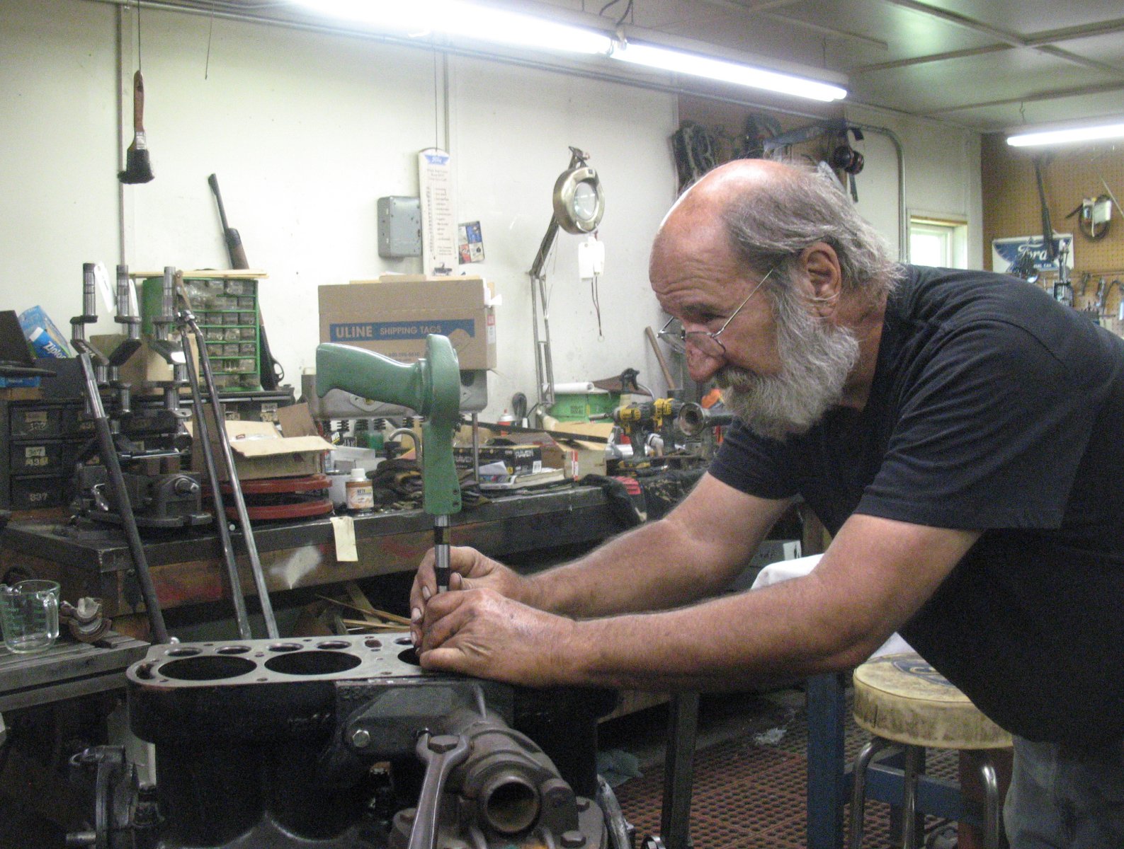

Yesterday I took the short block to Tulsa for an examination by Mike Bender the Model T surgeon.
The cylinders checked out OK for roundness and taper. The pistons are fine. The valves are getting low enough in the block to call for new seats, so we're going with new rings, valves, and seats. But Mike thought the overall condition was pretty good, and my low compression readings may have been from a faulty tester. So if the hard-start/no-start problem wasn't caused by compression I'm back at square one. We'll see how it is with new seats and valves.
