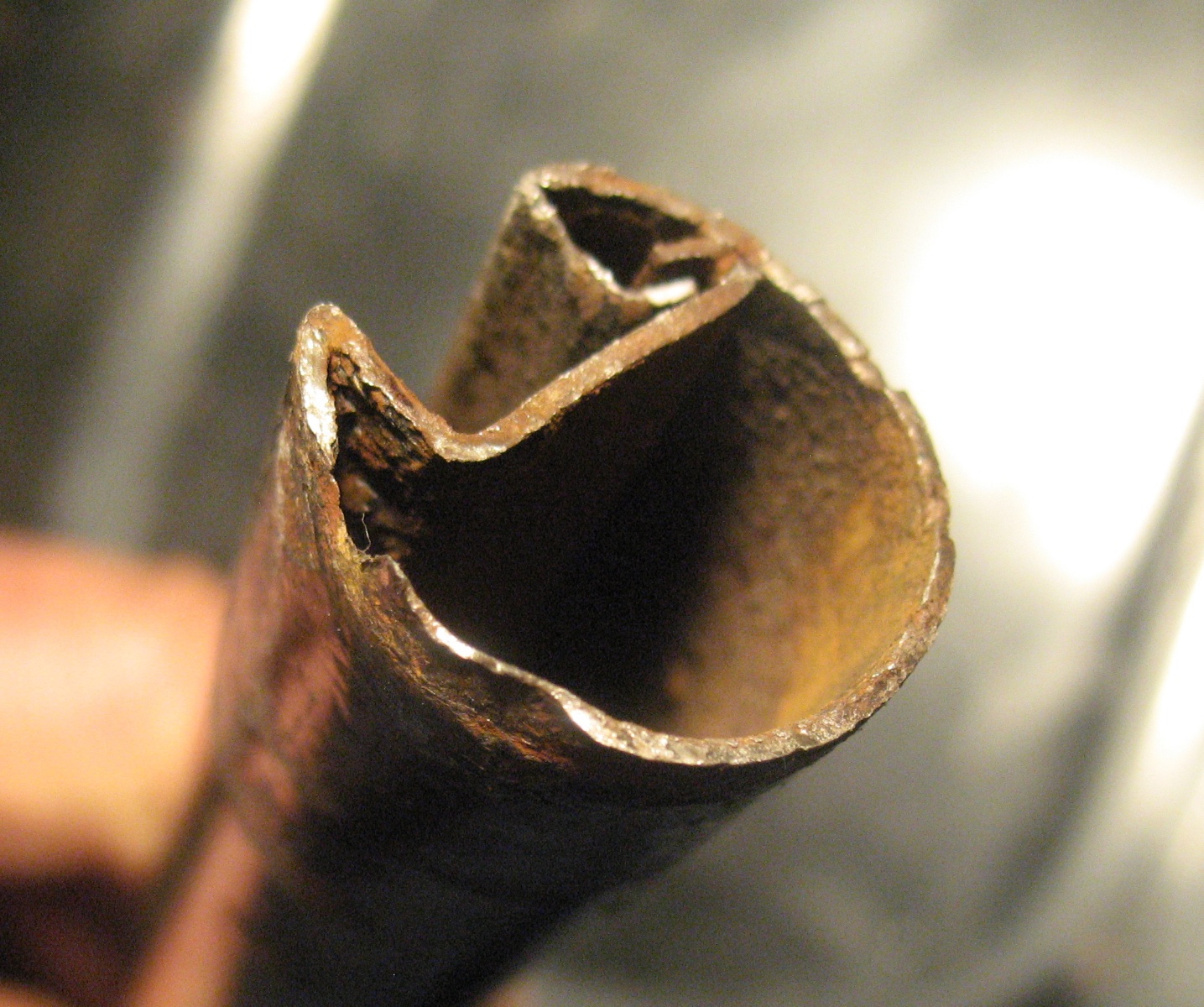

Rust in the break shows that the piece had actually been broken for a long time, with just the glass and brass channel and gravity holding it together.
After drilling and punching out the rivets I had to apply the heat wrench to remove the short piece of upright that was inside the bracket.
Here are the two pieces of upright together, and the two screws that attach the windshield hinge.
A solid steel piece fits inside the tubular body and the screws for the hinge and the top cap are threaded into it.
Before I got the thing apart I thought I would just make a new upright out of one solid piece. But this part inside the bracket sticks up inside the sheet metal tube. That rather complicates things. I'll have to make the new upright of two sections welded together.

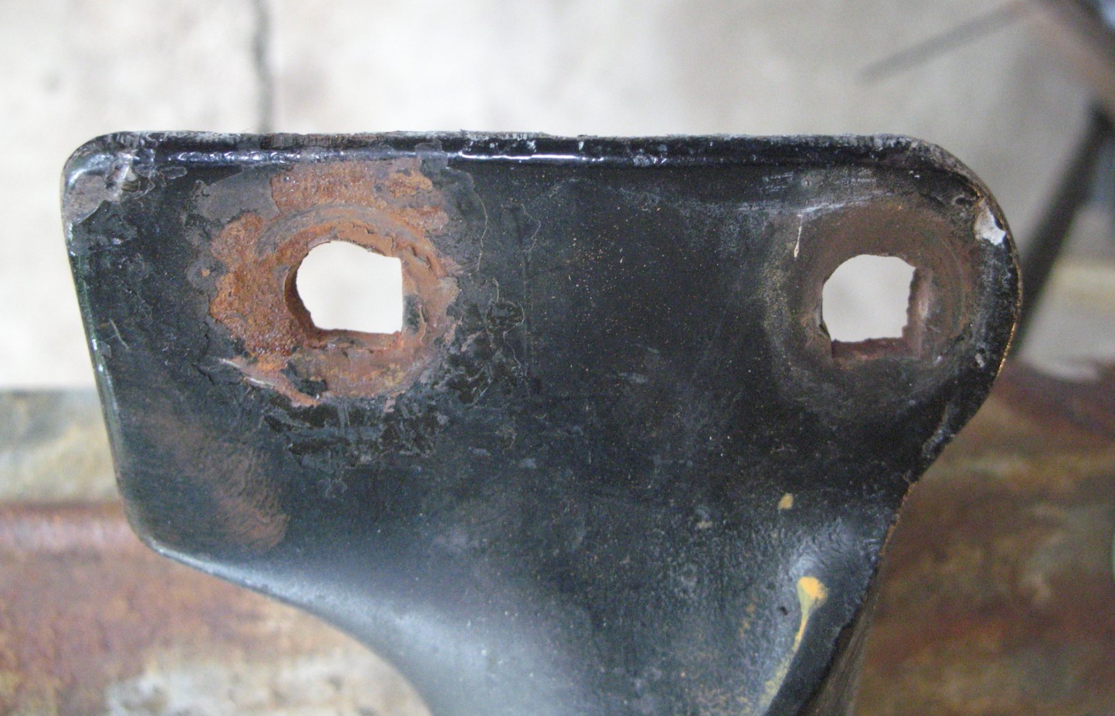

One of life's exasperating misadventures is dealing with carriage bolts in rounded-out holes.
So today I squared the holes in the left bracket.
