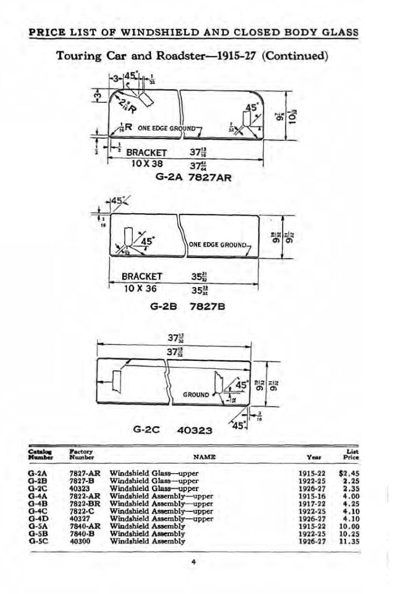

I am removing the original glass from my 24 coupe. I have taken the measurements from the old glass. The new laminated glass will be 1/4 thick and should fit in the channel. Likely not enough space to put the fabric in the channel like original. I have seen people put a bead of clear silicone and install glass. I have not had the glass cut yet.
Any ideas or guidance with experience would be helpful.
Anyone have the glass measurements for a 24 coupe to compare with what I removed?

This has '24 closed body glass dimensions.
