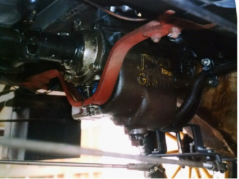

Found a discussion with picture of a mount http://www.mtfca.com/discus/messages/70 ... 1507814284
Here are a couple of links with pictures and more info that may help
http://www.mtfca.com/discus/messages/50 ... 1420996116
http://www.mtfca.com/discus/messages/41 ... 1409244609

That picture looked familiar, that is the Jumbo Giant in my 24 TT. Sold that 12 plus years ago.

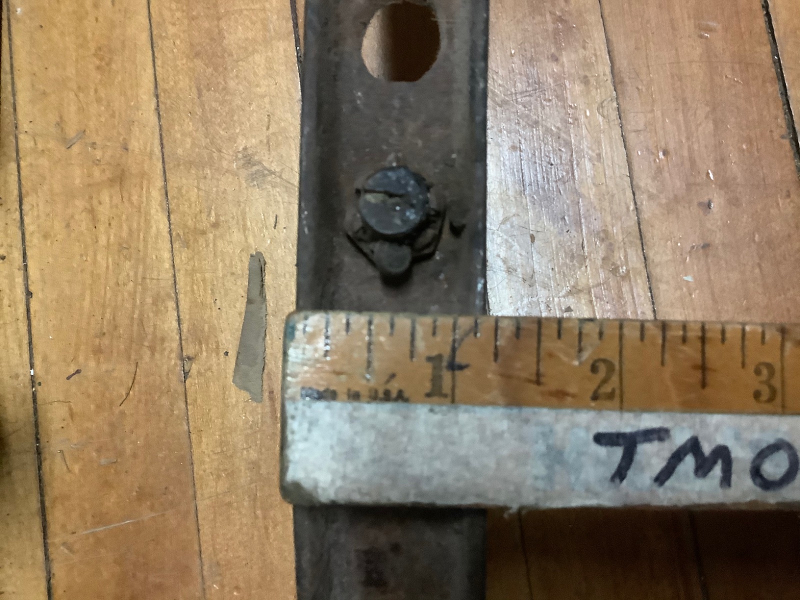

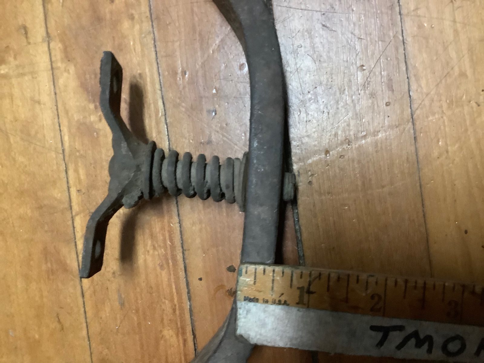

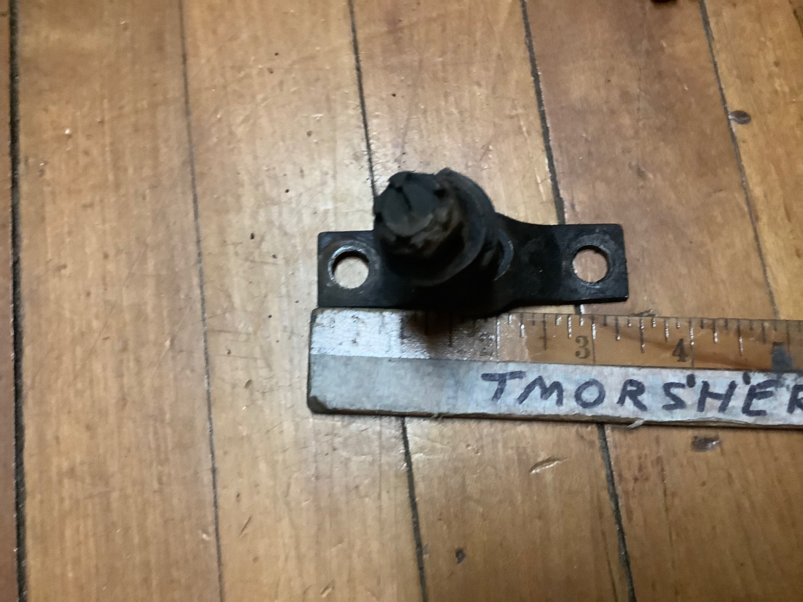

Bill, I have a loose one here. Unless I’m confused, it came with the nice transmission I sent to you. I have procrastinated sending pics and dimensions to another friend, but will do so tomorrow and post here. It’s pretty simple but might as well do it right, if you are doing it. T
Dropacent
- Posts: 3384
- Last Name: Morsher
- Location: Norwalk Ohio
Re: Jumbo Giant frame mount
Bill, I think this is for the Jumbo. I kept it to modify for my chicago trans. If you need further info, just ask. The channel is 1/2” x 1 1/8” It’s an uncommon size, so probably 1/2x 1 1/4 or 1 1/2”would be Aok, IMHO

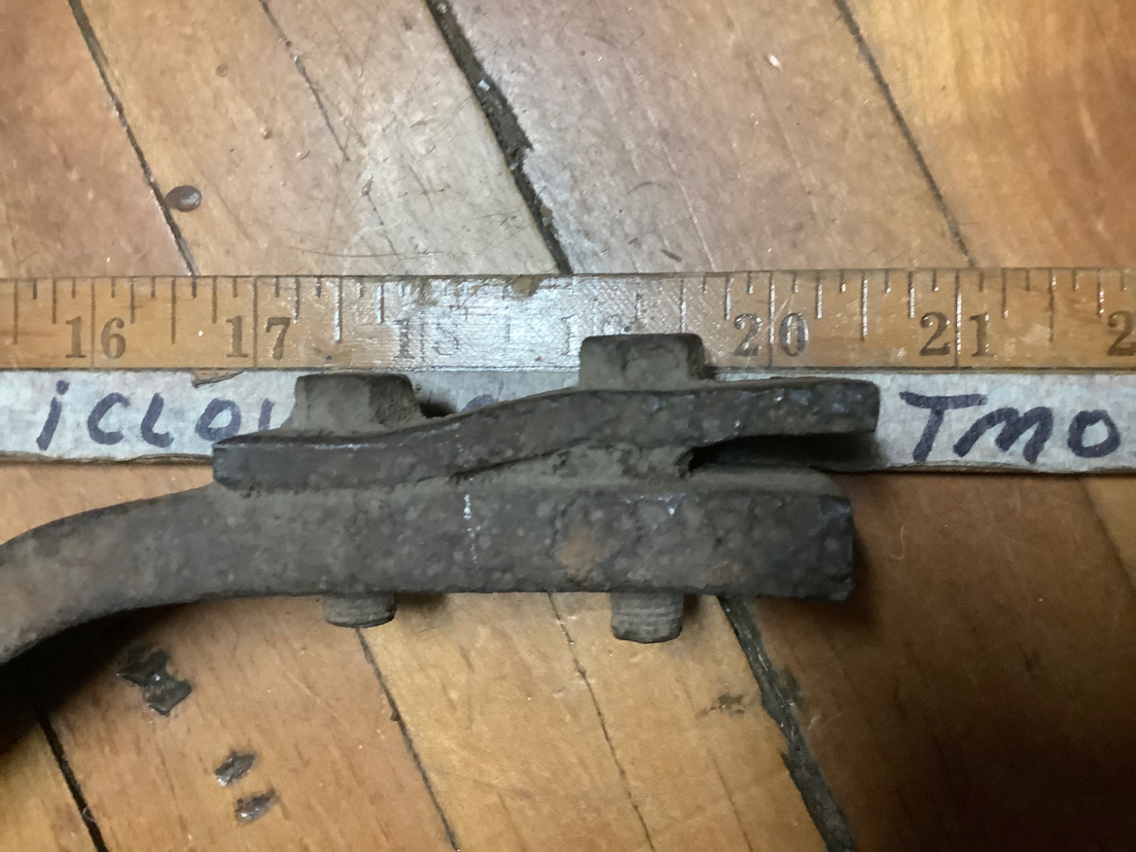

More pics
- Posts: 5599
Thanks for the photos & specs., Tim - I have a like new Chicago been sitting on the floor for the better part of 20 years waiting on me !!!
Remember , Steve. I think the one I’m showing is for Jumbo. I snagged this picture of a Chicago Mark E brace.
I think a simple mod like this will get us Chicago owners in the ballpark.
