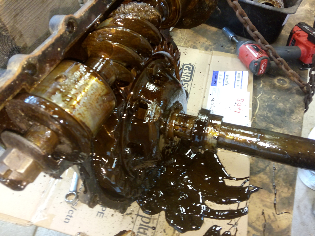

Home made carrier for modern oil seals - there is enough clearance if you measure carefully

Another good reason to strip it down is you never know what sludge you may find that built up in there, so a nice clean out in itself is a good idea (friends TT diff:)
