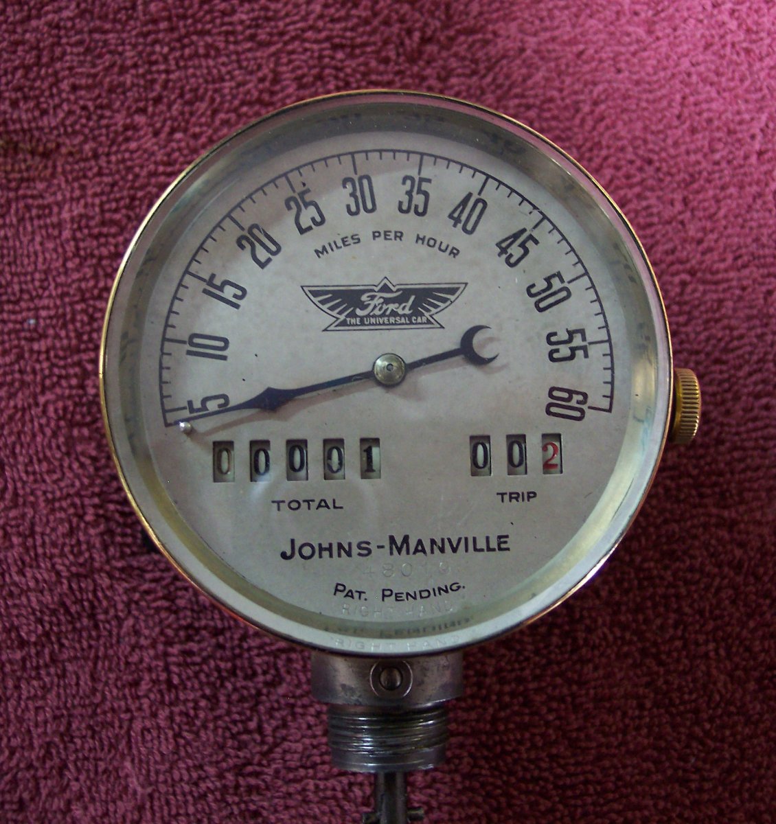

For the 1915 model year, Ford Motor Company contracted with five speedometer manufacturers (Jones, Sears Cross, Stewart Warner, Standard Thermometer and Johns-Manville) to produce a speedometer for the Model T. The 1915 speedometer is known as the Ford Special and is the only speedometer made by various manufacturers that has interchangeable parts. The Ford Special was an accessory item on the 1915 Ford and in July 1915, Ford stopped installing a speedometer on the Model T. The speedometer used a direct drive (no swivel) and "modern type" inner cable. I've attached some photos of the speedometer and its drive parts. I hope this helps. Russ Furstnow

The Ford Special was a "factory" accessory, but there were other manufacturers that offered speedometers to owners and dealers in 1915, so speedometers other than the Ford Special can be found on original 1915 Model T's. One interesting note, the passenger side engine pan on the 1915 Ford is unique in that it has a 1" hole directly behind the carburetor drain hole to allow the speedometer cable to go to the drive. This hole is not found on other engine pans. Russ Furstnow

Standard Thermometer also made a 60mph Ford Special.
The Ford Special setup has a 12T8P fiber pinion and a 35T8P road gear...all unique to the Ford Special. The swivel that is shown in a previous post does not fit a Ford. Also, I left out one part that is seldom seen on Fords with the Ford Special setup, and that is the cable support. The cable support hangs from the right fender support to the cable and keeps the cable from rubbing the front axle. Here is a photo of this important item.
