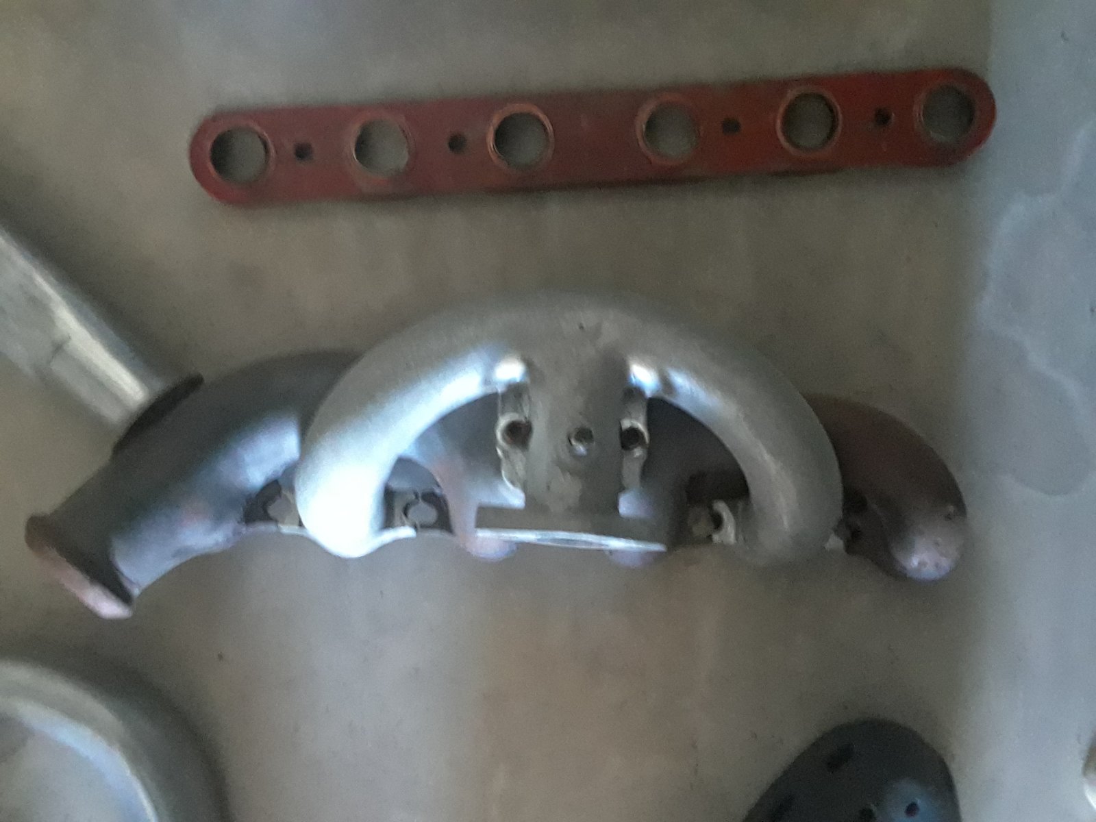

I have a 27 frodor, the engine has oversize valves, counterbalanced crank, flywheel magnets removed oiler to front main and dippers, running a stipe 290 cam with adjustable timing gear and engine has been degreed. Also using a dan hatch floating trans shaft ball bearing fourth main. The rest of the running gear will be modernized as well. I have the following choices on I can use on this engine thought I would ask some of the folks here who have done this
Hi-volume intake maniflod with straight thru holley NH Also have a walpro with air cleaner
Winfield intake to run a zenith or tillotsonx both rebuilt
Have also seen the vw solex carb(new to me )
The car has a chaffins dual exhaust manifold as well

Use the Model A intake/exhaust (they can be mounted with or without the adapter plate). There are lots of updrafts that will bolt up and give you more varoom! Stromberg OE-1 for example.

There have been many reports that the Walbow lawn mower carbs do not run or perform well without a fuel pump. A straight through NH or a Simmons or Wizard straight through would be the easiest and most authentic. A Zenith updraft carb on a Winfield manifold also appear to be popular, though they require linkage modification. I had a 4 door sedan with a warmed up engine similar to yours and had a Model B exhaust manifold and aluminum intake manifold with a Stan Howe rebuilt Stromberg OE-1 updraft carb. I removed the setup and returned it to stock before selling it, so I still have the setup.
Pictured with the aluminum intake is the Model B exhaust manifold with its 45 degree outlet, but I have a regular Model a manifold with the 90 degree down outlet, also. I, also, have the complete exhaust from manifold to tail pipe.-

What ever setup you put on, unless the fuel bowl on the carb is below the bottom of the fuel tank where it would be in the stock setup, you might need to add a fuel pump with regulator set around 1-1/2 lbs along with an kill switch in case of rollover otherwise, you would be running out of gas with lots in your tank.
I saw the 1927 but missed the fordor part with the tank under the seat.
If you wanted to run what you have listed and if the bowls don't sit low enough you could eliminated the fuel pump and add an extension between the carb and manifold.
The Solex is downdraft so would require a fuel pump. Depending on which Solex it is, I ran a #28 for a while on my Chevrolet overhead, not too bad off the line but slow acceleration over the 30-35 range. On the flat did over 50 but took a while to get up to that speed.
