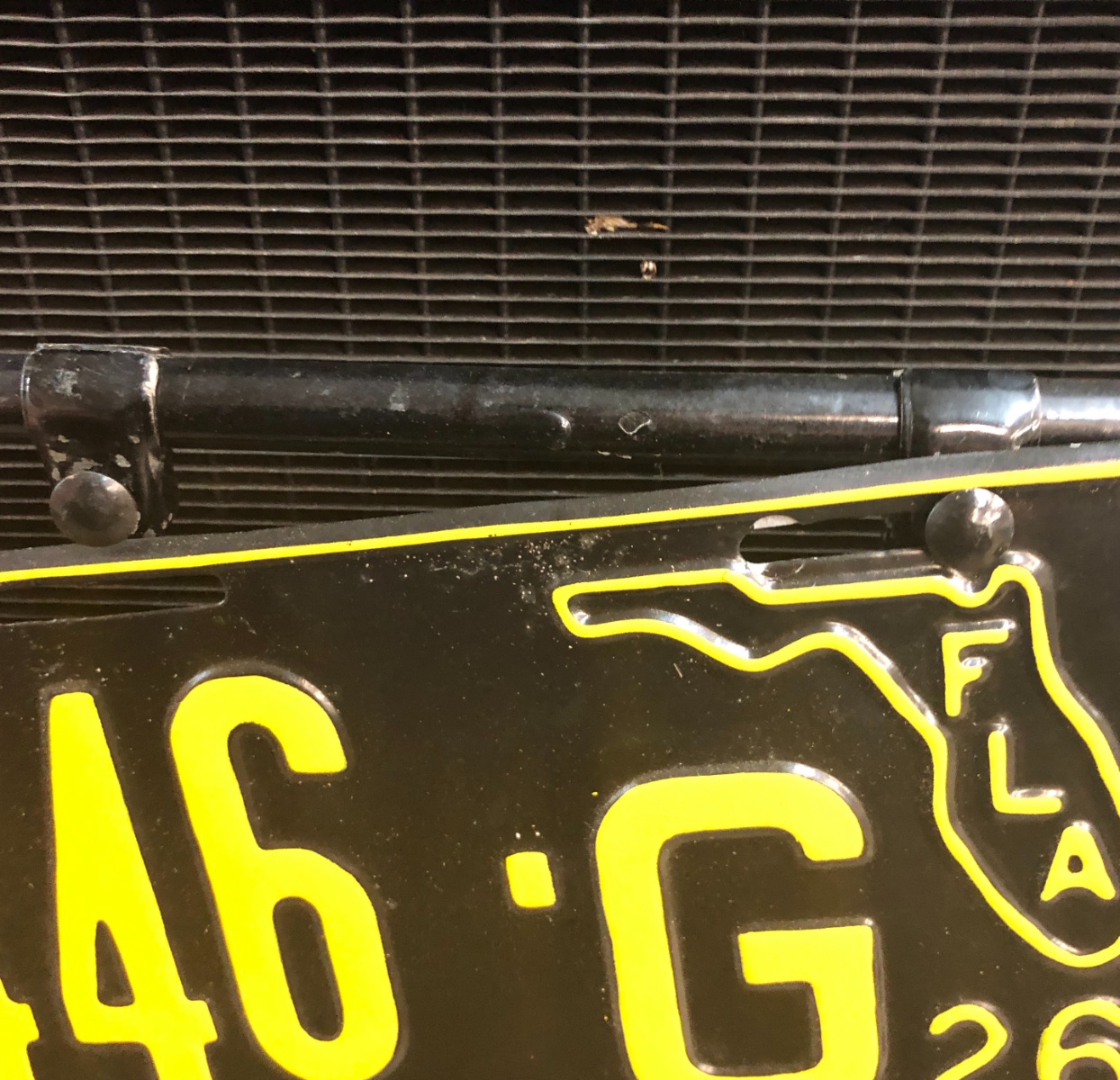

The placement of the holes on the plate should not be a problem. The correct way to place the brackets is to put the bolt to the top of the bar and bolt the plate on the front, not between the clamps. So it should work fine if you place it this way.

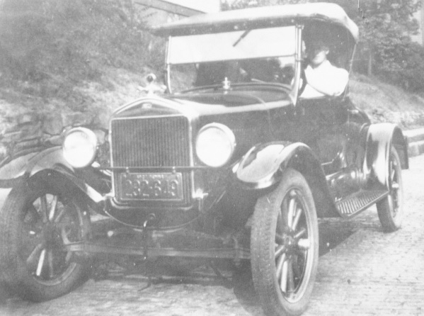

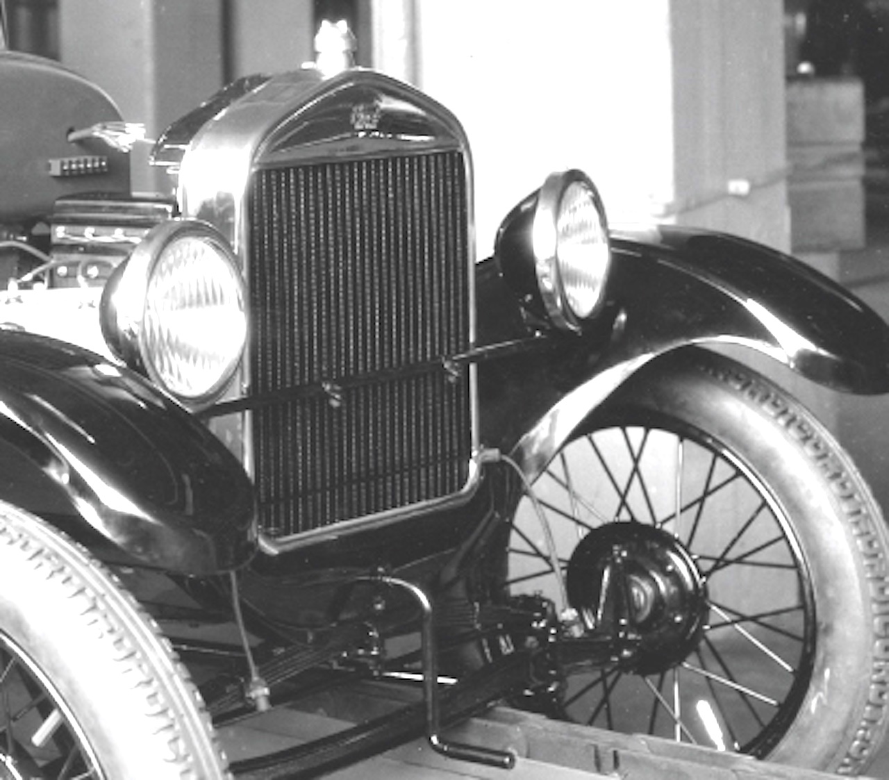

Here is Ford #15 millon with Ford accessory license clamps, note how they hang.

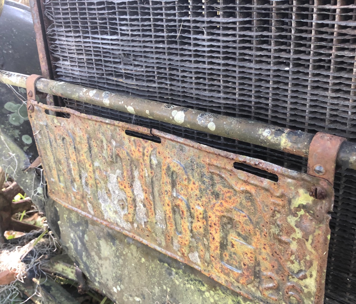

On this accessory bar, the clamps hang, and the bolt goes thru the license slot, period plate.
Or, if you found old aftermarket versions, they hang from the bar too. Plate below hanger.
And another old photo of period placement.
348170 (599x446) (2).jpg (113.6 KiB) Viewed 4042 times
