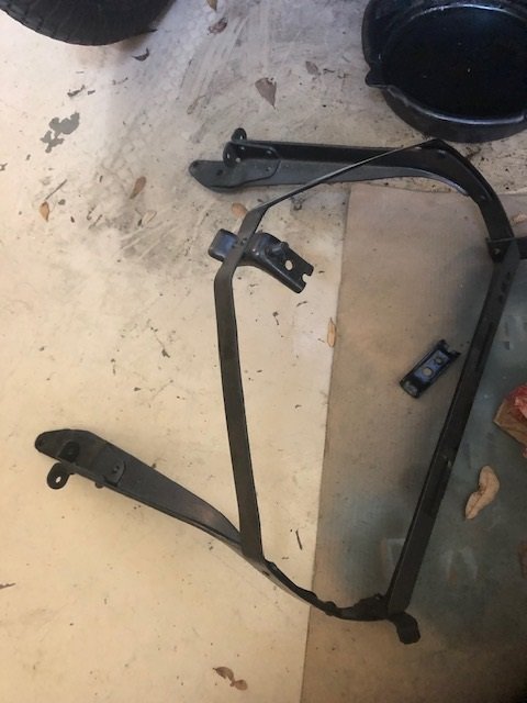

Hi, all getting ready to mount the spare tire carrier pictured lying upside down on the floor.
What size bolts do the 4 holes on the rear crossmember mount with?
What size bolts do the 4 holes on the top of the frame take?
The nut is missing from the bottom keeper bolt. What size/thread is that? Is it supposed to be a wing nut or something else?
Thanks in advance, -- IV

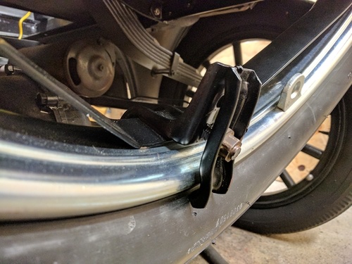

John posted what I was to do, just a 3/8" dia, fine, use lock washers, hex head, hex nut, fine thrd. bolts are stronger. All are the same size.
The rim is held by the threaded stud, thru the clamp, with a flanged style nut, so that it grips best. The upper holes are for locking means, a chain around the tire and rim or what ever you need for the neighborhoods you plan to leave the T on the street overnight :lol:

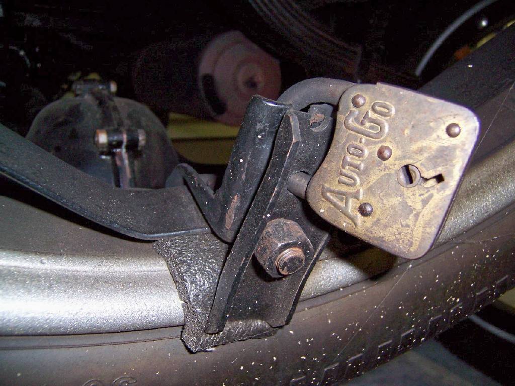

Post by DanTreace » Mon Mar 30, 2020 11:44 am
John
Could be a new rim, looks super nice....however, not mine. Photo snagged off older forum posts...can't give credit as didn't retain who posted.
Here is mine, original rim, alum spray paint for shine :D
Non-original piece of black foam plastic for anti-rattle. ;)

Dan, thanks for these two photos. It clears up a question I've had for awhile. Most people are missing the clamp piece and they just align a lug to the hole on the frame and bolt through it. I've looked at factory photographs to see what was right but I hadn't seen what I was looking for.

Good to know what the other hole in the clamp does. Say the 3/8 ths OD is too big 5/16th's fits...
