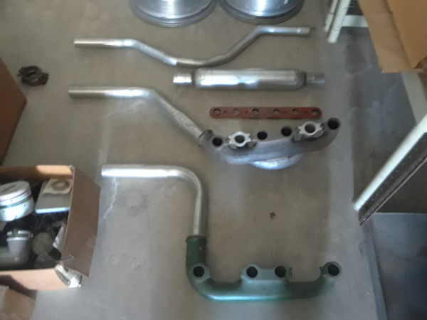

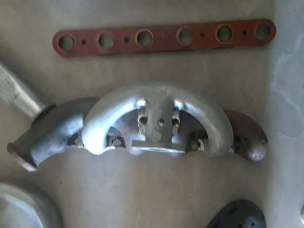

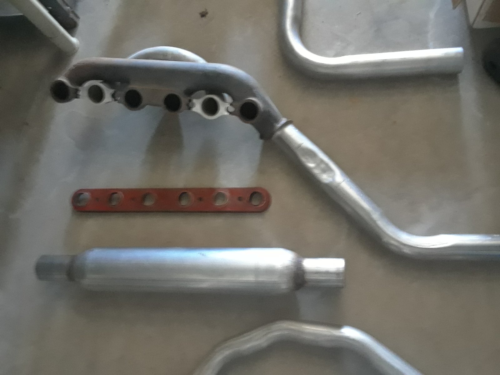

I have a 27 frodor, the engine has oversize valves, counterbalanced crank, flywheel magnets removed oiler to front main and dippers, running a stipe 290 cam with adjustable timing gear and engine has been degreed. Also using a dan hatch floating trans shaft ball bearing fourth main. The rest of the running gear will be modernized as well. I have the following choices on I can use on this engine thought I would ask some of the folks here who have done this
Hi-volume intake maniflod with straight thru holley NH Also have a walpro with air cleaner
Winfield intake to run a zenith or tillotsonx both rebuilt
Have also seen the vw solex carb(new to me )
The car has a chaffins dual exhaust manifold as well

Use the Model A intake/exhaust (they can be mounted with or without the adapter plate). There are lots of updrafts that will bolt up and give you more varoom! Stromberg OE-1 for example.

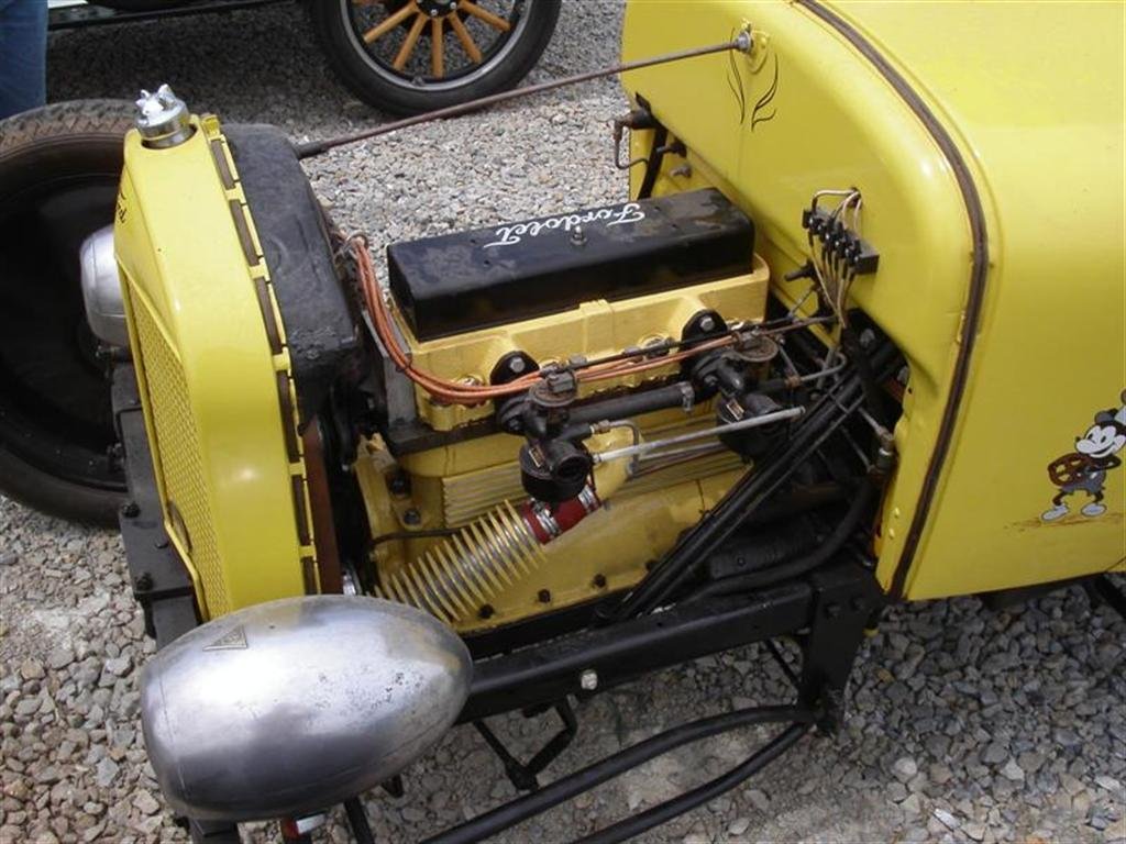

No fuel pump, no problems, period correct, all the carb you need. Buy a high volume manifold, either turn the flange or make an adapter, put it on and go have fun.
