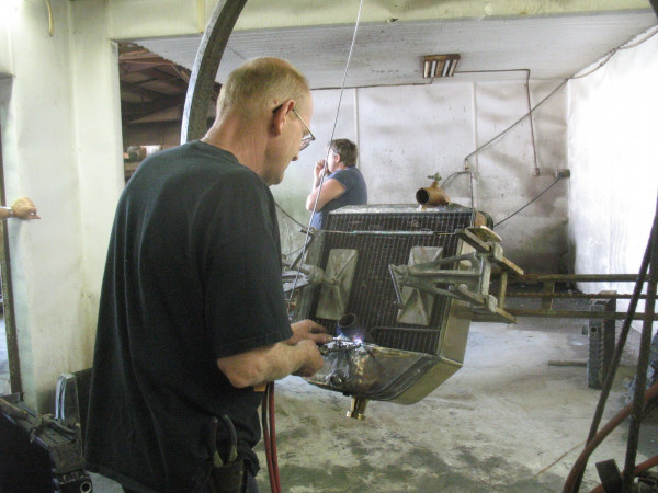

Instead of buying a new radiator for my 1915 I had the original recored, for three reasons. Most important to me was that I got to keep the original appearance. The new ones are not made the same. A secondary reason, but also significant, was saving a few hundred dollars. The third reason was second hand. I have no personal experience to back it up. But I have seen forum posts griping about the new radiators not surviving well on cars that get driven, and my car gets driven. I've had to patch up the tank on my original, but it doesn't look bad for 105 years old, and the recore solved the overheating problem.

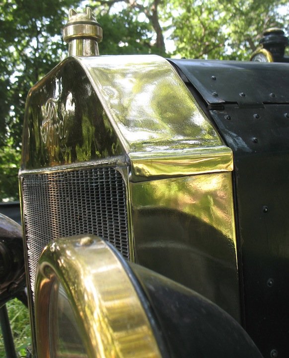

Brass radiators look good to those who don't know real original radiators, and the Brassworks doesn't. They have modified the way Ford assembeled radiators to suit their own purpose, which is wrong. The original Brassworks almost did it right, but didn't rivet the side panels to the top tank. I wish that people who make reproduction parts would learn to do thing correctly, and not the way they want to!

My recore was done by Tom Nolte. He did a radiator for Rob's Model K, so I sent mine to him.
