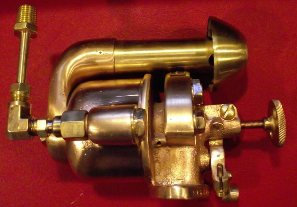

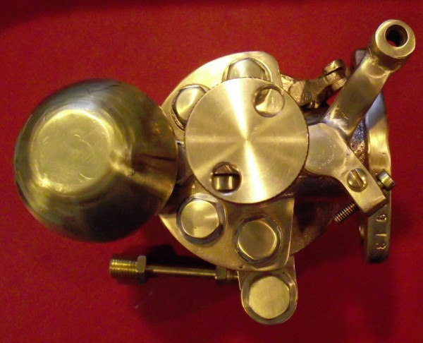

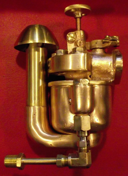

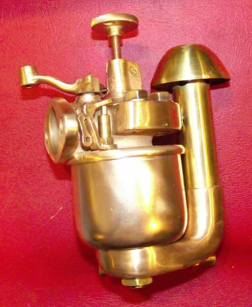

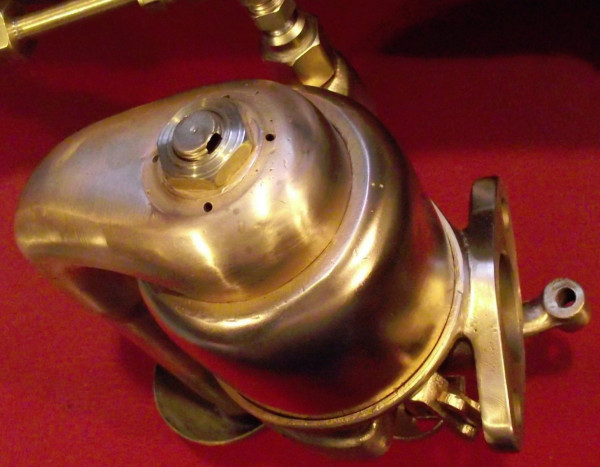

I posted a couple pics of the new caps for this a week or two ago, thought I post a pic or two of it done and off to the owner. It had been whacked with a wrench, a hammer and whatever else, lotsa bruises that hadn't healed on their own, took a little massage to get it looking good.
There is always some controversy over the air inlet tube and design. This is how it came in except the hat was squished flat. This is how it goes out. Right or wrong, correct or not, it went away.

Stan...does it have some other designation other than 1909, Kingston 5 ball? Anything different about it other than the air intake?

Not that I know of. The air intake varies from year to year but the body of the carb is the same as near as I can tell. The later ones also added a butterfly choke but that is also part of the air intake.
