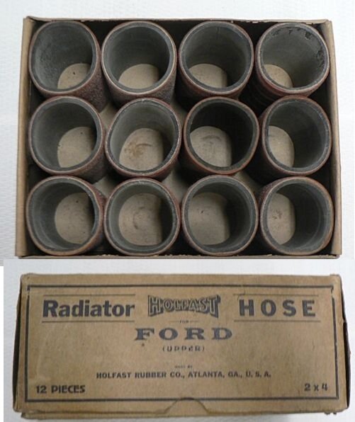

- Posts: 5549
Re: radiator hose
When I got my radiator hose at the auto parts store for the 1920 Dodge I had to buy by the foot. The Dodge hoses are smaller in diameter so I didn't ask about T size hose nor have I compared the construction/thickness of the 2 types of hose. I have had no issues with the red hose sold by the suppliers. If you are having problems with it sealing, could it be the condition of the water inlet and outlet that are on your car? If it is the clamps, it has been recommended to use the worm type to set it then replace them with the original type if that is what you are going to use.
If you buy local, you may or may not, have to trim to fit.
- Posts: 6588
Re: radiator hose
- Attachments
- hose.jpg (54.23 KiB) Viewed 4258 times
