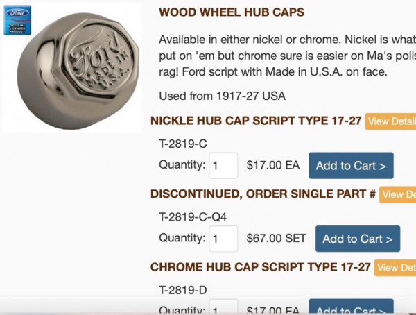

Nickel finish is what Ford provided on the wood hubs. Repo can be chrome or nickel, your choice.

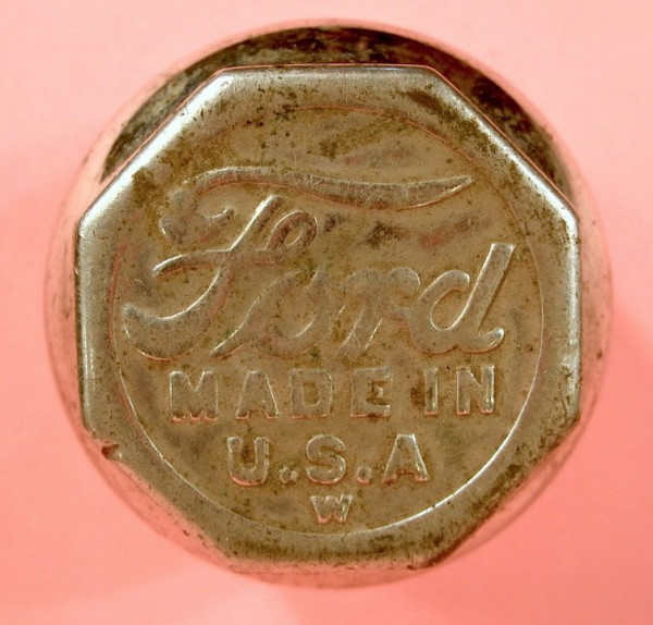

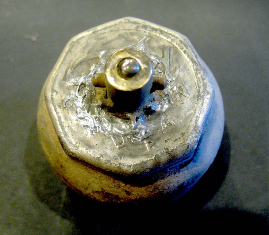

Here's one of those caps with the manufacturer's mark, in this case a W.

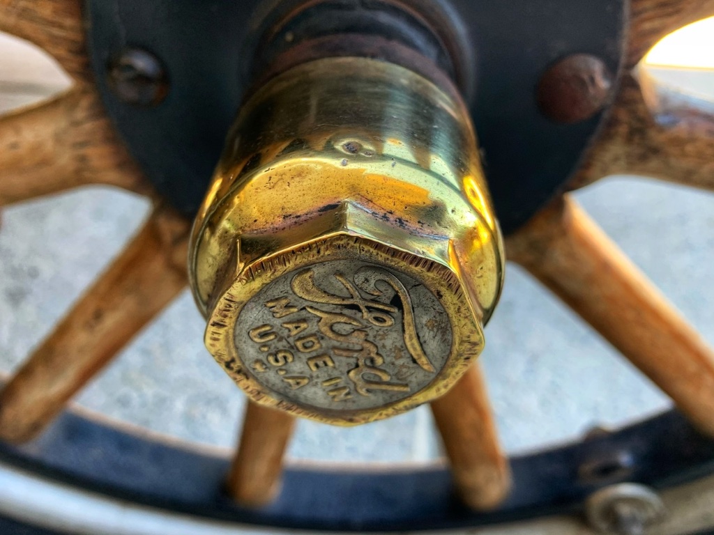

This cap with an Alemite fitting soldered in is marked R.

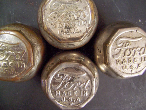

And along with letter marks of mfg. some are missing the "period " after U.S.A ;)

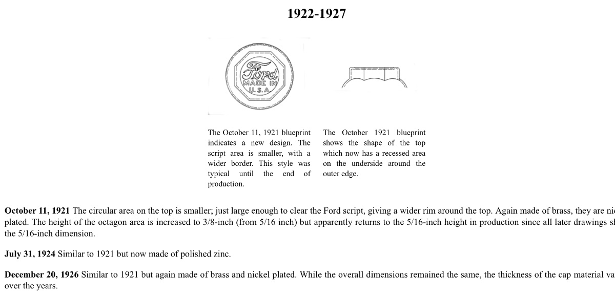

Don’t know of listing for suppliers of hub caps to Ford, but maybe not all put marks on them. Some details from club encyclopedia:
Click on image to enlarge and read

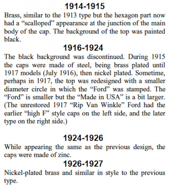

Here's some of what Bruce says about hubcaps. The encyclopedia has photos and drawings.
