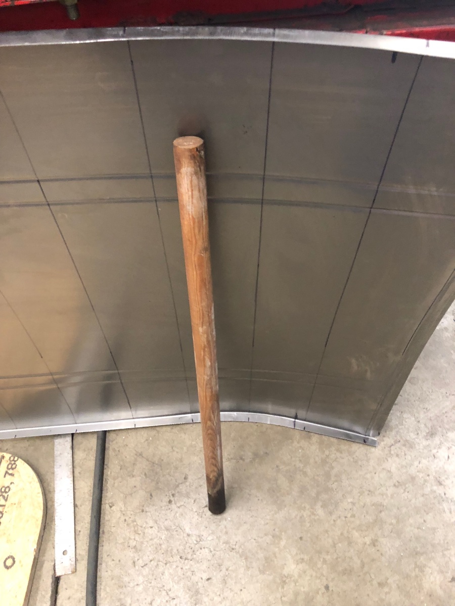

If you have noticed, I have bead rolled my complete piece first then shear again. This is because of the bead rolls line up perfectly when I resection the metal. Don't forget to file your edges after cutting, save on stitches.
If you have a HVAC company close by, they may bend the metal for you. Remember, duct work is galvanized and we do not use it here as the welding puts off deadly fumes. There are plans on the internet and other sources on how to build a sheetmetal break. A Box Break or Finger Break is a must for me but I am attempting to keep this as simple as possible. I am using some of my high end super tools behind the camera to speed things up, ie, slip roll, pneumatic panishing hammer, english wheel, etc. But you do not need these......, yet. Comes with the trade.
Now on a clean swept floor, lay down two 2 X 4's about 10" apart, push and rub the wooden dowel against the panel and watch your results. Using the croquet ball with a canning paraffin will help well too and the rolling pin. Don't over do it and check your results as you go.
If using a shrinker tool, do this often, and if using in conjunction with a pan sheetmetal break, really often.
