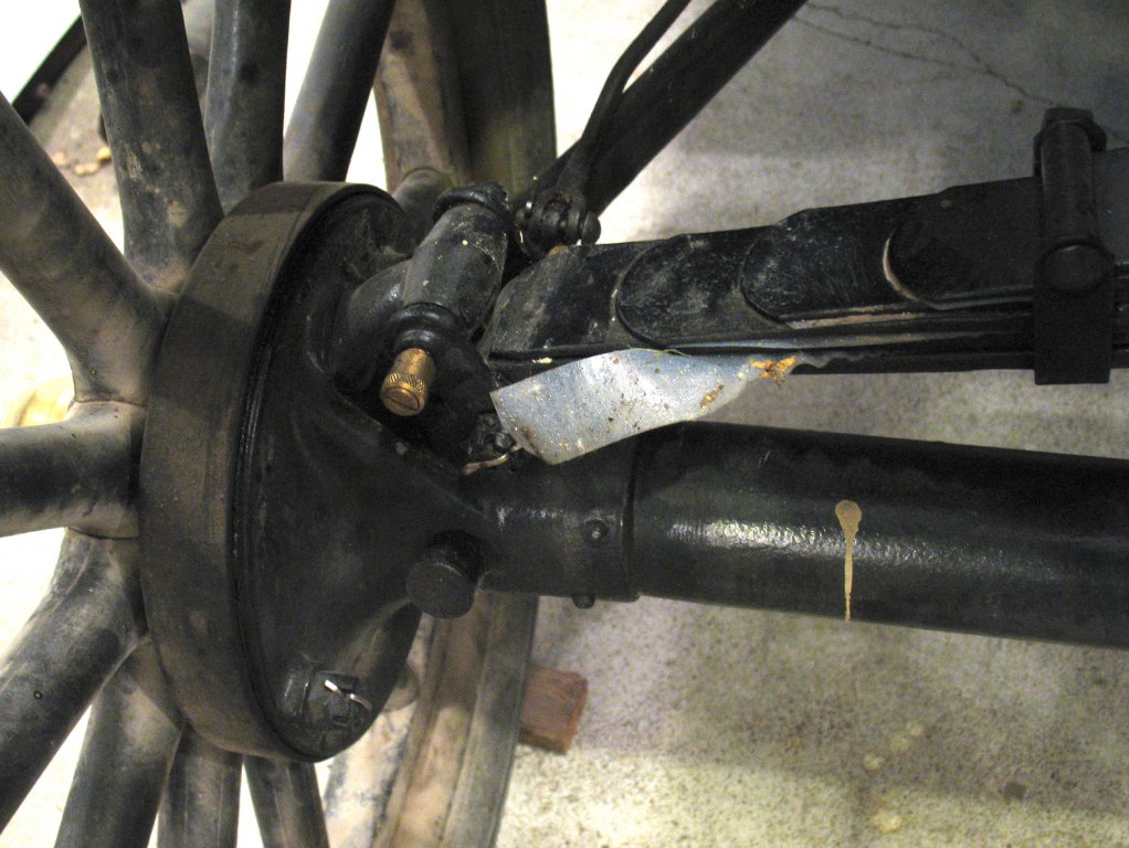

(1) How do you remove the hub caps on wire wheels? I have applied penetrating oil and am waiting a day or so.

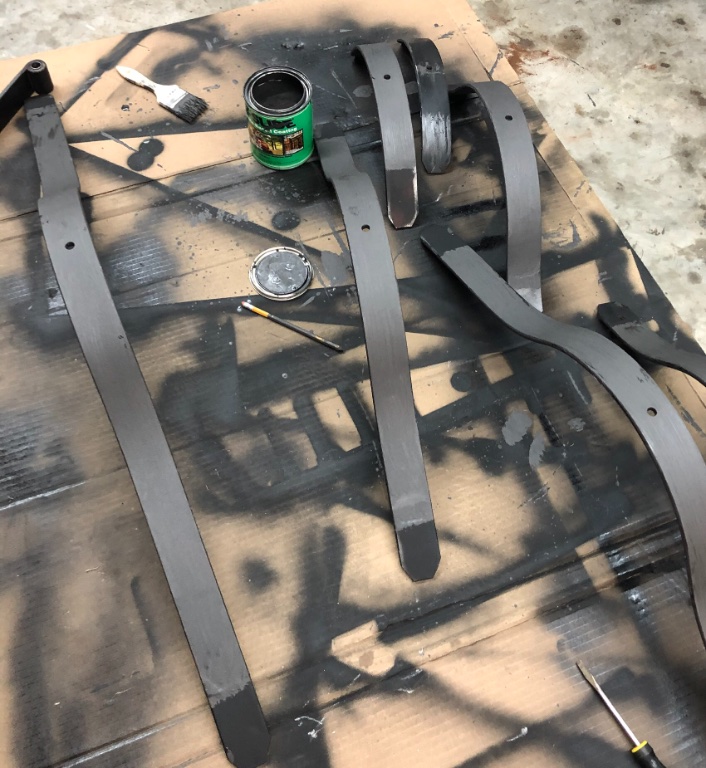

(2) Do you paint the entire individual spring leaf (prime and top coats) and then apply the slip coat or do you apply the slip coat to the bare metal "contact" surface?

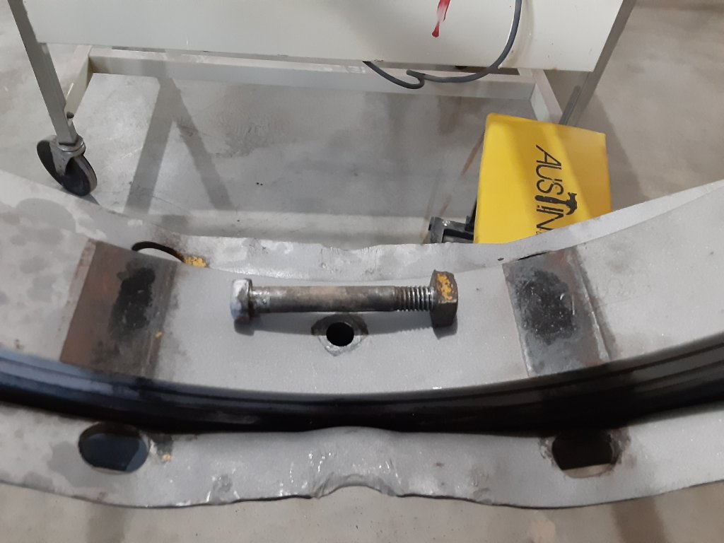

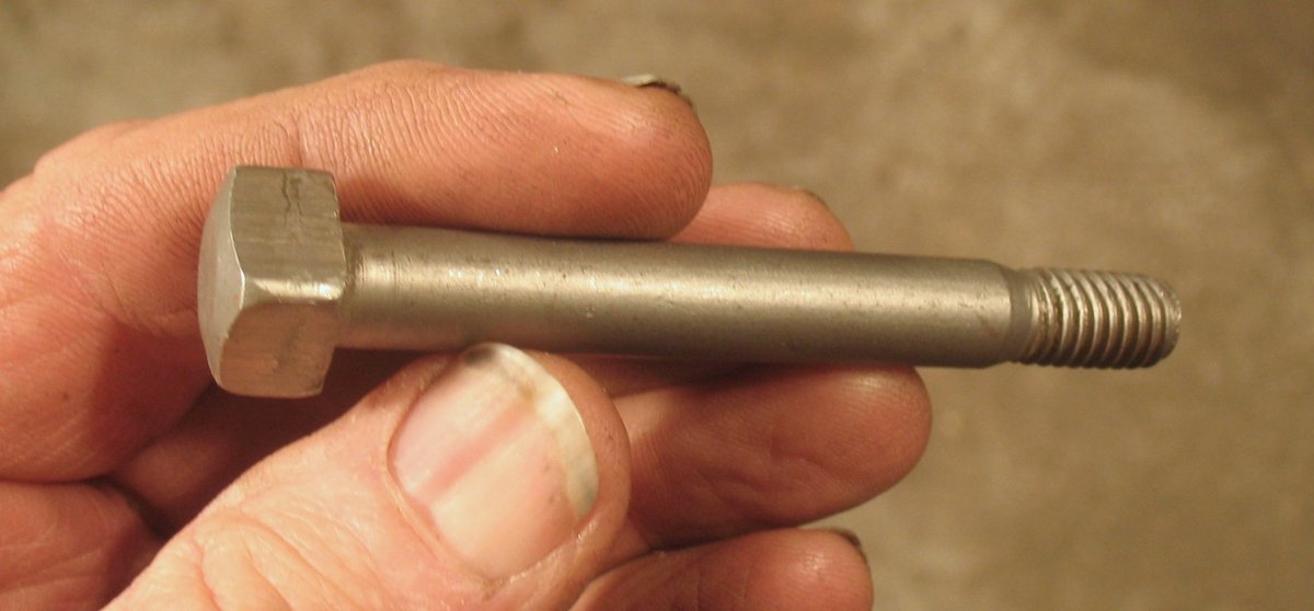

(3) The rear spring tie bolt on my 1927 coupe has the small head. There has been comments that I should use the thicker head bolt, which I sort of like, but here is what I have noted. Langs 2021 catalog (page 109) indicates the thicker head was used on 1909-1916 models and the small head on the 1927 model. I am just curious, any comments about this?

Finished script cap on wheel, take a long flat head screwdriver into the backside of the wheel hub well, and pry the tabs up, then pull the cap away.
Hub grease cap on the wire wheel hub, take a slim flat head screwdriver and pry the cap away from the housing.

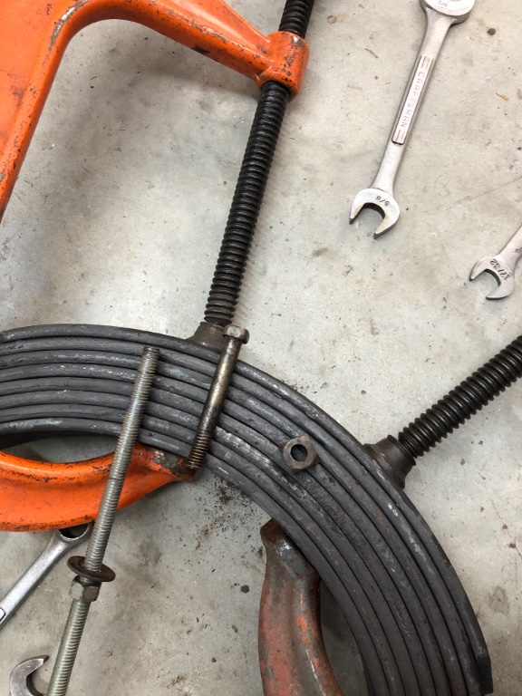

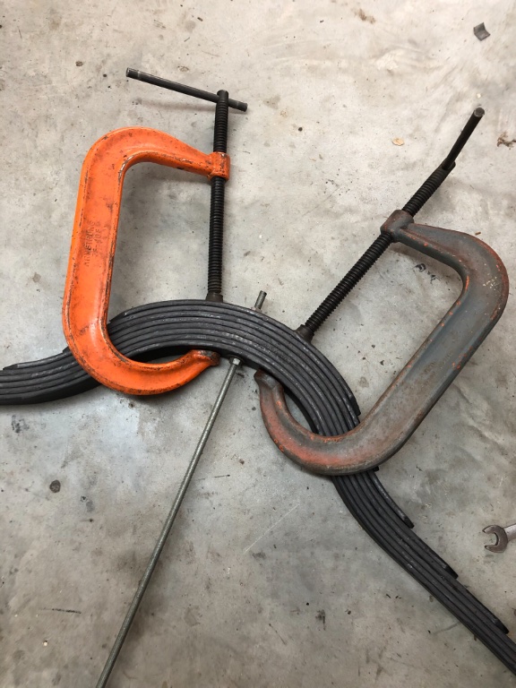

Either prime or apply Slip Plate graphite paint directly on the bare metal. Assemble the spring stack using a length of all-thread rod and two nuts, then use a clamp to the compressed leaves, remove the all-thread, and insert the center bolt. Affix the outboard spring leaf clamps. Then finish paint the entire stack. Low head bolt is ok for later crossmember, just be sure it fits into hole when securing the spring u bolt clamps.
Test fit again as your cross member channel looked compromised in the center, the spring stack should fit snug, needing persuasion sometimes with a heavy mallet.

Lang's is great for most parts, but I wouldn't buy another of their spring bolts. Get the authentic one from Bob Bergstadt.
Painting springs some folks paint the whole unit assembled. I paint all the parts separately and apply slip plate on the bottoms of all leaves except the main one. I use phosphoric acid metal prep and paint with satin black rattle can Rustoleum. Some prefer glossy. I don't. It needs no primer. It looks good and is very durable.

The hub caps for the wire wheels are installed from the inside. You have to remove the wheel first. Then follow Dan's instructions.
The front wheel hub has a cap covering the nut. Pops off with a screwdriver. They are not easy to find, so when you pry it off remember to do it gently because you are going to put it back on later.

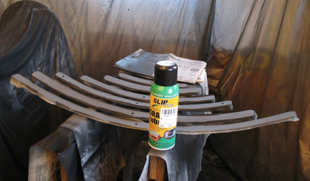

Question for Steve J: Just to make sure I understand your procedure. "Do you paint both sides of each leaf and then apply the slip coat"?

Do you paint both sides of each leaf and then apply the slip coat?
I don't know if it's right, but that's the way I did it.
In the photo, note that I've masked the sides of the painted leaves so the slip plate goes only on the bottoms.
I should also give a heads-up on what not to do. Several years ago, after reading about it on the forum, I used UHMW tape instead of slip plate. That did not go well.

Note. If you do not paint the leafs and elect to paint them with slip paint, be sure to paint both sides of the unexposed areas of each leaf instead of just the bottoms. Jim Patrick
