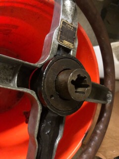

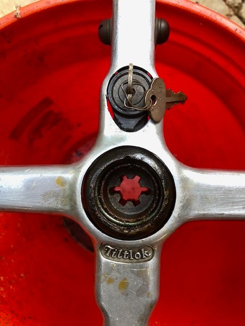

I have a TiltLok locking fatman steering wheel that I don't intend to keep but first wanted to make sure it works properly. It appears that when the key is rotated it shoves a pin in that prevents the center portion of the wheel hub from rotating. When the key is rotated the other way, the pin is retraced and the wheel spins on the hub thus the car isn't drivable. Is this how it works? As of yet, I can't get the wheel to spin on the center hub so maybe I don't understand.
1
1
2
2

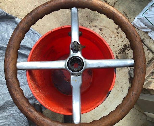

If you look at this photo you can see the "hole" where the pin engages.
3
3

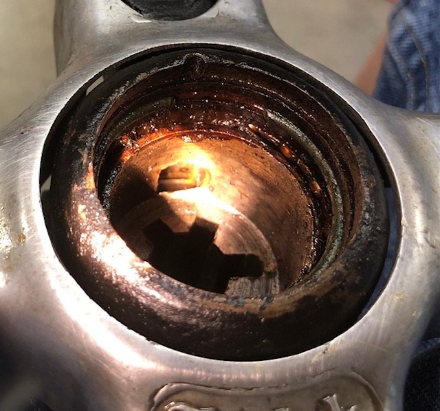

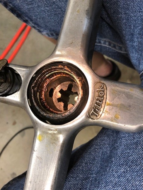

Two photos show the pin in both positions.
4
4
5
5

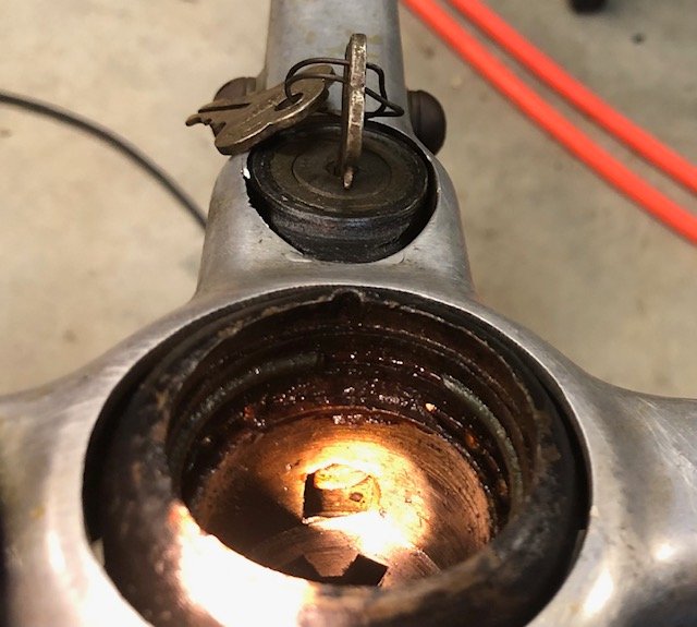

This is a photo from the bottom side. Does the hub slide up and down in the wheel vs rotating? I admit I’ve never seen a steering wheel like this so having trouble visualizing the action description provided.
Try
Try
Posts: 6793
Re: TiltLok Steering Wheel
Post by Scott_Conger » Thu Jul 08, 2021 10:28 am
Looking again more closely, there clearly is a snap-ring retaining ring in it and you may very well have figured out what it is supposed to do, and how. As for fixing it, loosening it, whatever, personally I'd leave that to the new owner.
