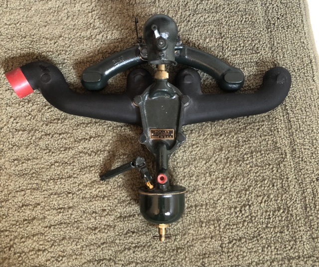

Re: Vaporizer rebuild
I have a Russ Potter rebuild from many years ago that never was installed or used. I sold that particular Model T before the carburetor was sent back and it has been hanging on my office wall ever since. I’ll sell for $150 plus postage which is a super duper price. Contact me through this forum if you are interested.

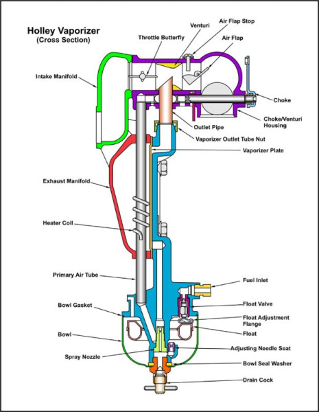

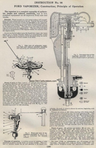

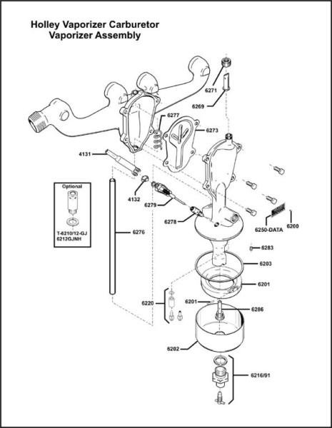

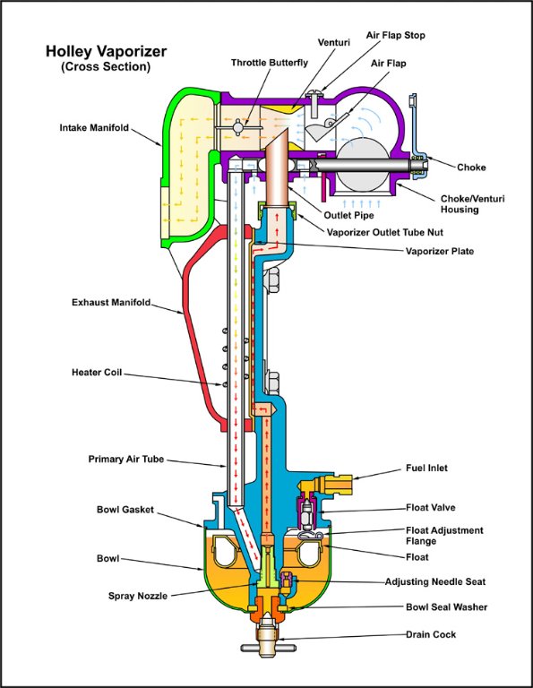

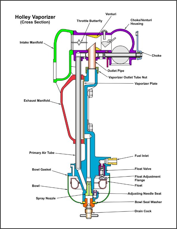

- Posts: 6579
Vaporizer Rebuild http://www.mtfca.com/discus/messages/82 ... 1529609068

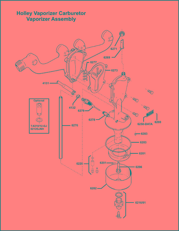

The following diagrams are explained in the link above
