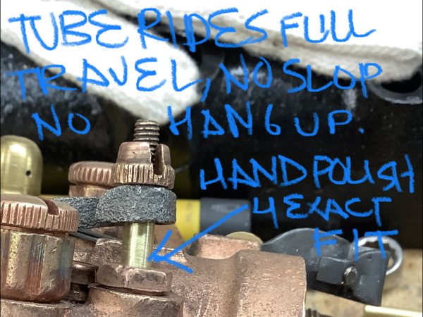

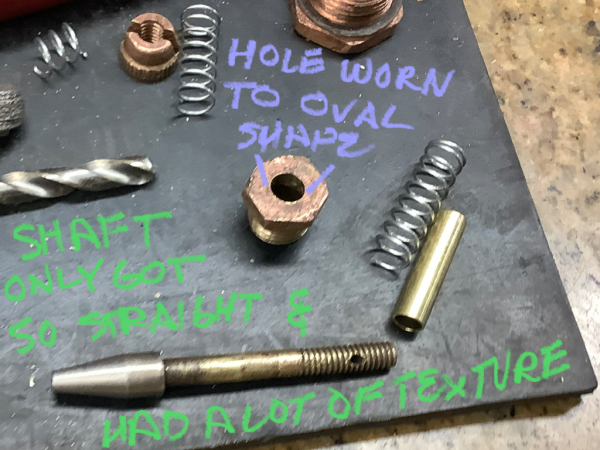

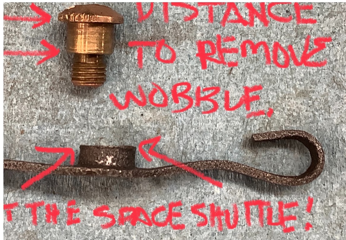

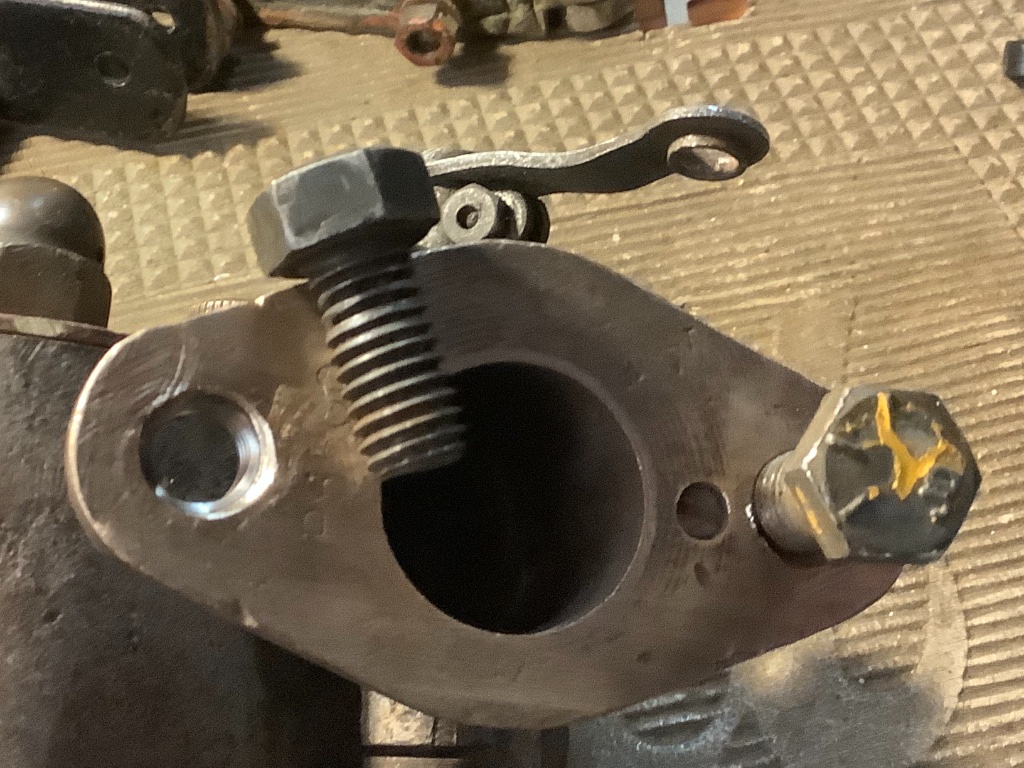

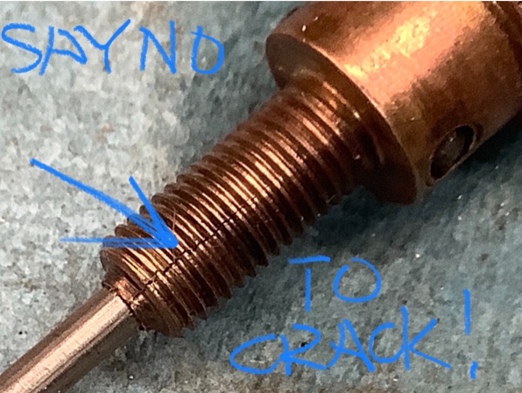

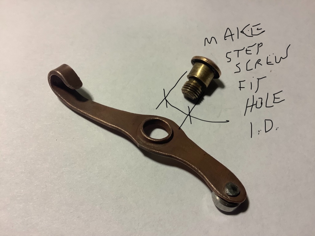

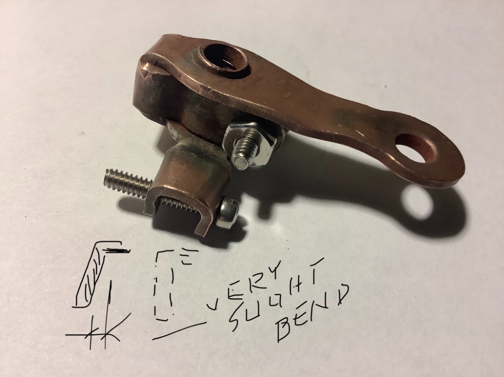

I’ll start this for hints on rebuilding your Stromberg OF carb. PLEASE JUMP IN if you have any hints or advice. I’ve often advocated that these are very simple carbs. If you can take apart a simple lawnmower carb, these are a piece of cake. If you haven’t, there isn’t much to them and I’d encourage you to get your hands dirty. Nothing better than a sense of accomplishment with model T ownership.
Now, I have never rebuilt an OF carb. So, hoping lots of people that have can chime in with their hints. I have rebuilt and restored several RF Stromberg carbs, which were the pinnacle of improvement and the follow up to the OF. They are also a bit more complicated. So, still the same animal.
I’m posting the first two as hints for the recent parts I’ve made and started to send out. Instead of sending individual notes to everyone, I thought this would be simpler.
Perhaps other will have improvements on a couple of my suggestions, and I’m always glad to learn something new or someth8ng I hadn’t thought about.

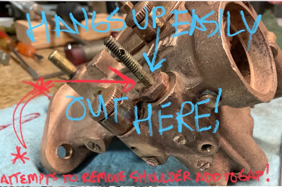

Adjusting this piece. The stop screw can have a small nut on it to keep it from moving, but originally one end of the threaded bracket was tweaked just a bit to act as a lock. Just a slight bend. The very slight shift of one of the threaded holes will keep the screw in place and set.

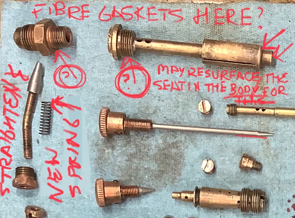

Instead of reaming the hole in this piece to finished size, I left it just a tad under size. The brass shoulder screw that is on the carb is sometimes worn under size, so I thought it may be better to fit the shoulder screw TO the metal arm, instead of visy versy.

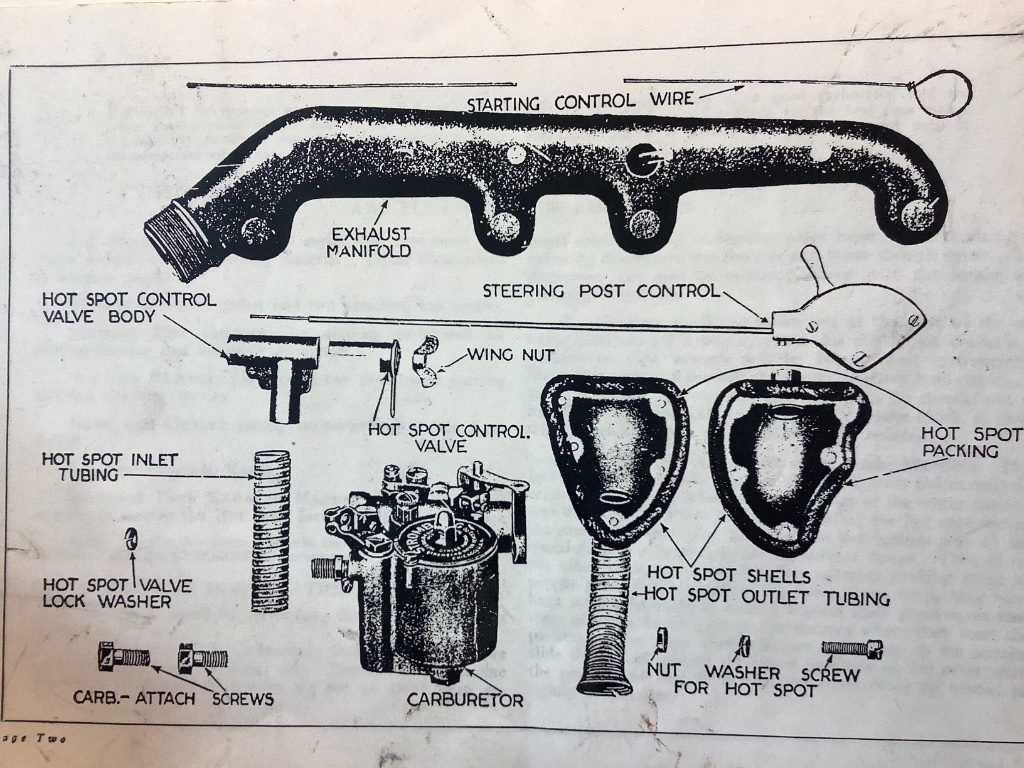

Interesting that the complete set up used the Ford hot air pipe and the hot spot chamber….

Michael, I’m not sure how accurate the sales display is now. It has a ( copper) plumbing fitting where the air valve would go, and also missing the choke cable clamp. I’d bet the original would have the steering column choke control displayed also. I’m not picking it apart, and only wish it was hanging on my wall!

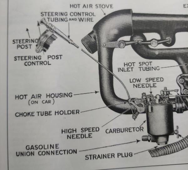

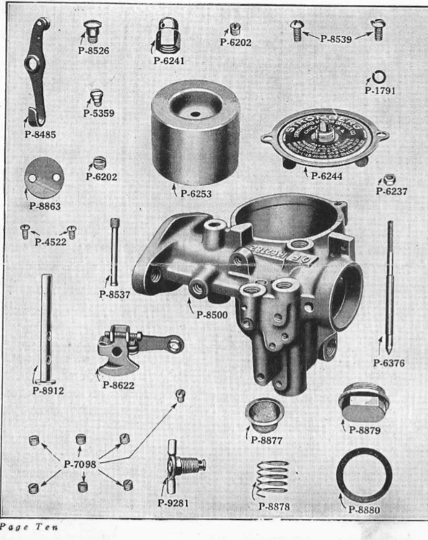

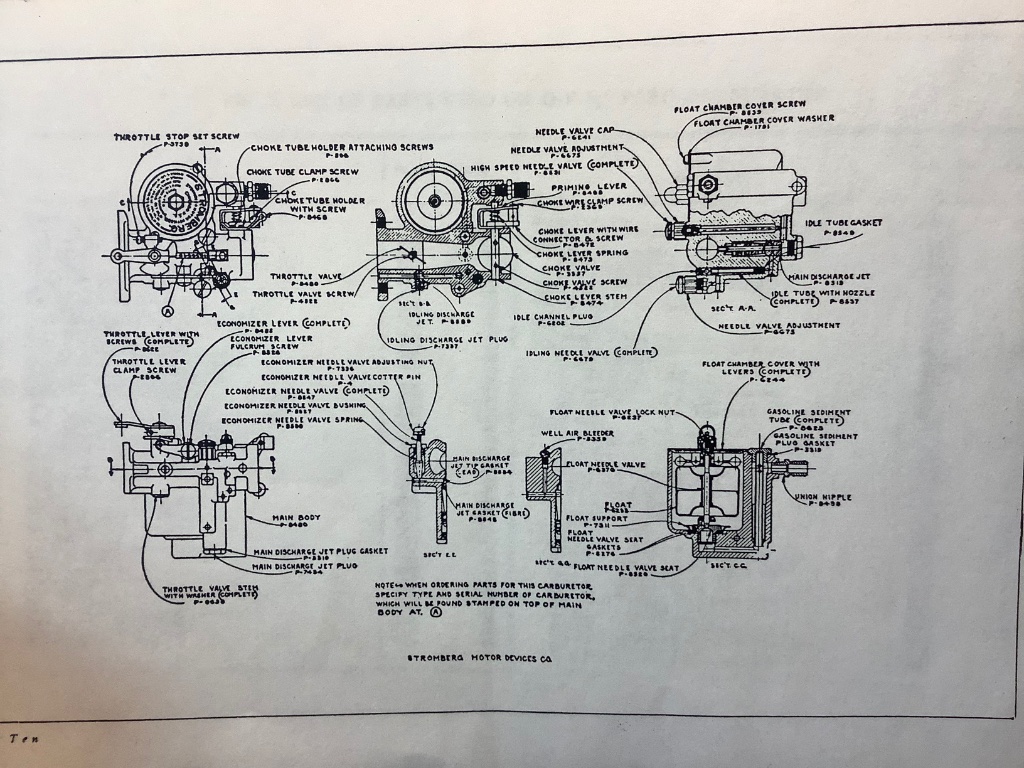

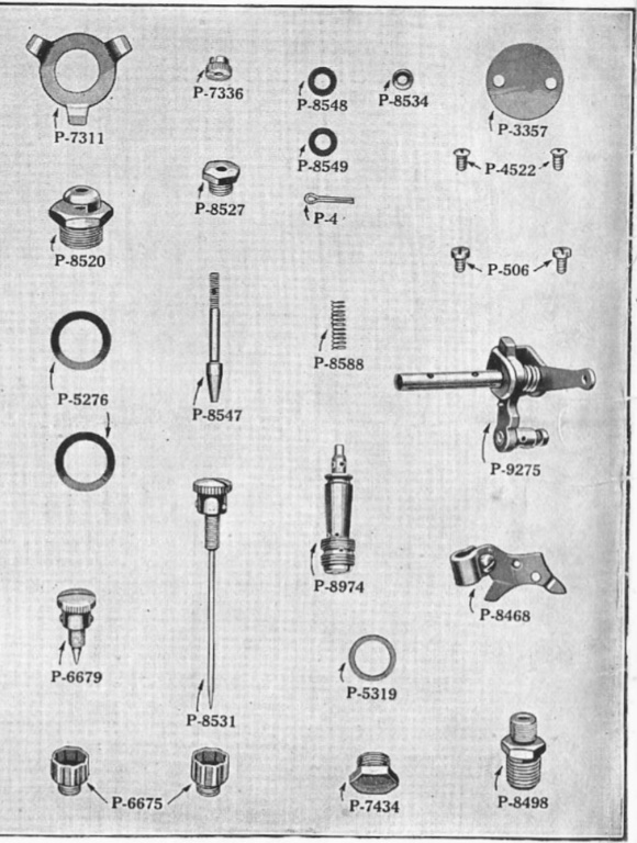

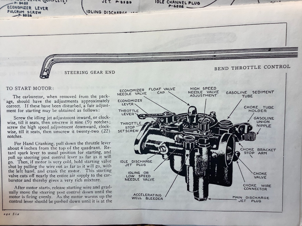

I sent an incomplete OF to Stan Howe to be rebuilt. While it was away I purchased a push/pull choke cable at a clearing sale. It was made for a T because it had the diamond shaped mounting bracket for the T steering column, so I thought it would do for my OF.
When Stan sent the carb back it came with copies of the books Tim posted and some extra instructions from Stan. Imagine my surprise when page 5 of the Stromberg manual showed my choke cable assembly. Apparently, it is the later, perhaps simpler, version of the one Tim manufactures for OF users.
I have since found a second one, with a bracket to go round a round steering column.

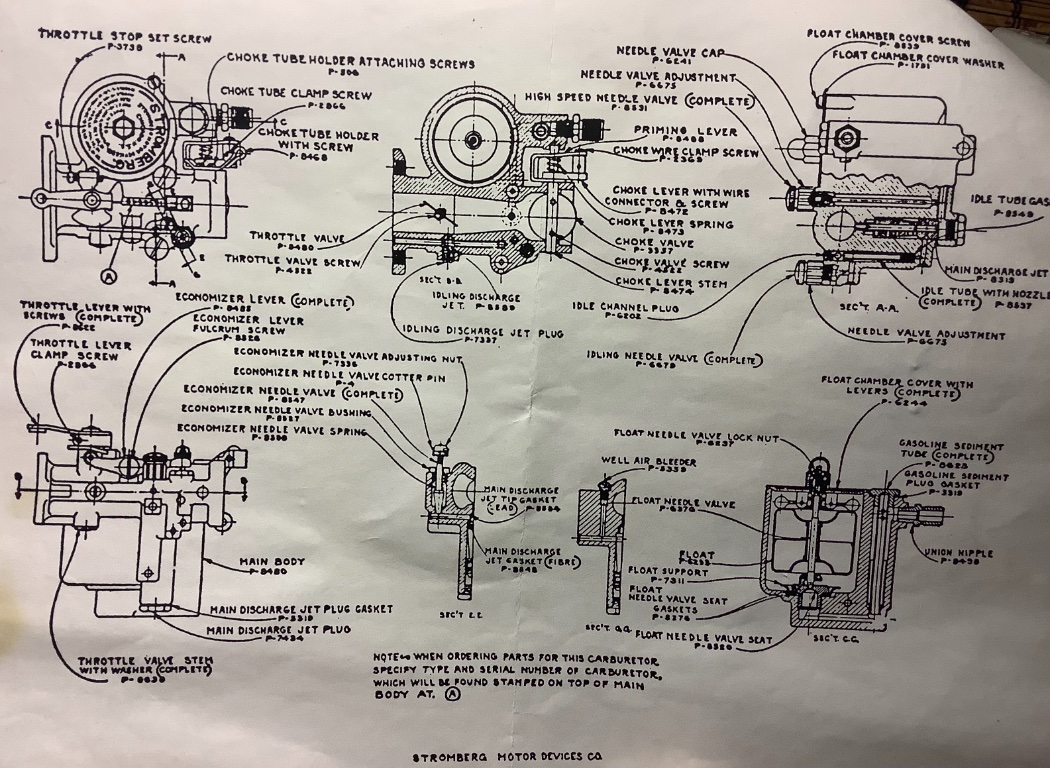

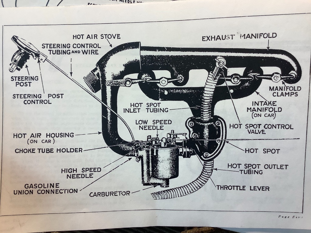

Post by Allan » Sun Jan 09, 2022 5:48 am
Here is a photo of the choke control in Stan's manual. Perhaps it will alert others when they see one.

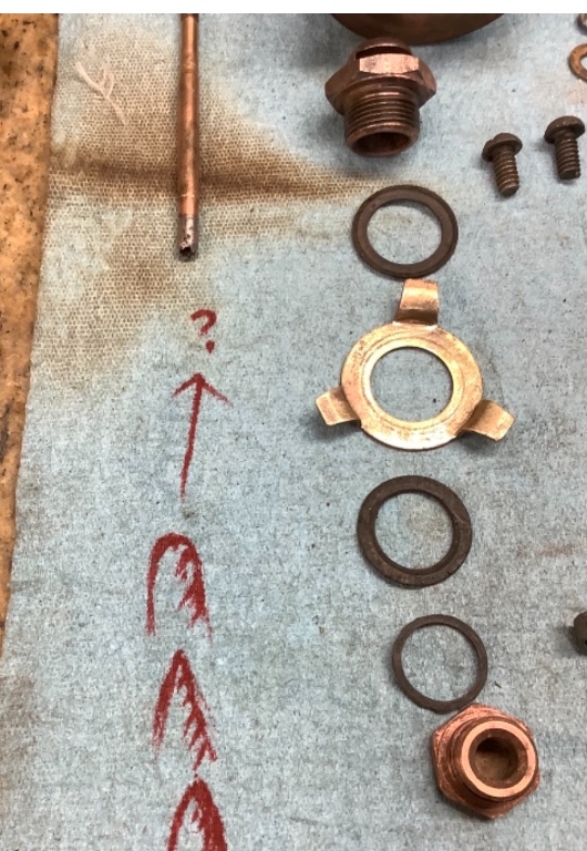

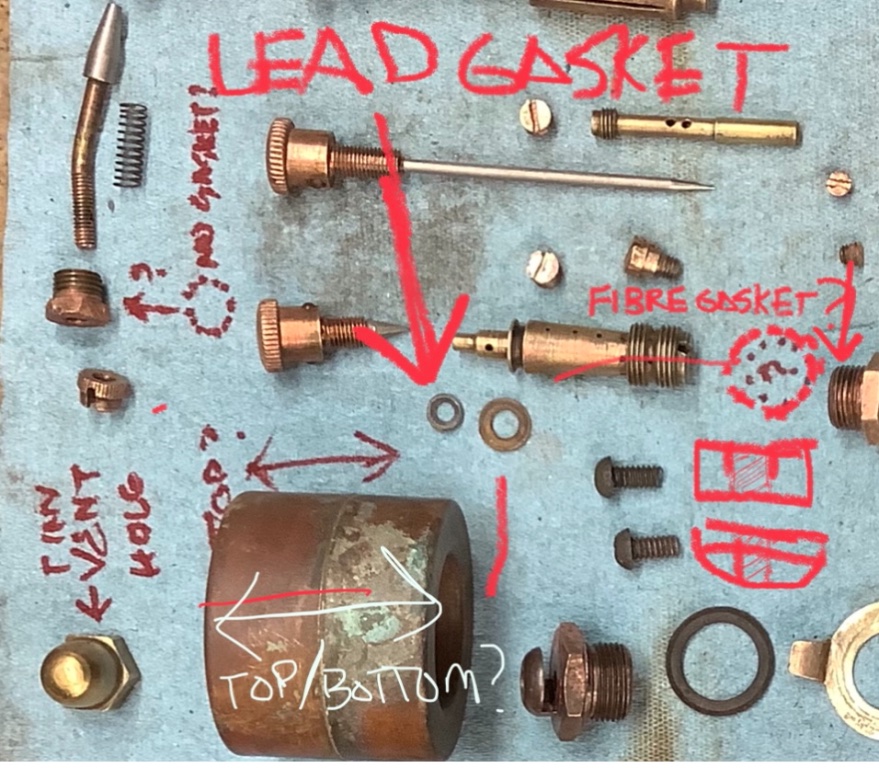

A couple enthusiasts I know are working on their OF carbs this winter. I’ve permission to post some PIcs with questions. So, if you’ve been into one of these desirable carbs, feel free to jump in with hints and advice.
Dropacent

Post by George House » Sun Jan 16, 2022 5:04 pm
That doesn’t appear to me to be a “ very simple carb” or “a piece of cake” Tim but thanks for stirring discussion on this topic.

Post by Dropacent » Sun Jan 16, 2022 5:52 pm
You seldom see them 100% apart, which I thought would be quite helpful. You are welcome to stroll on by George, and I really don’t understand the need for the commentary.

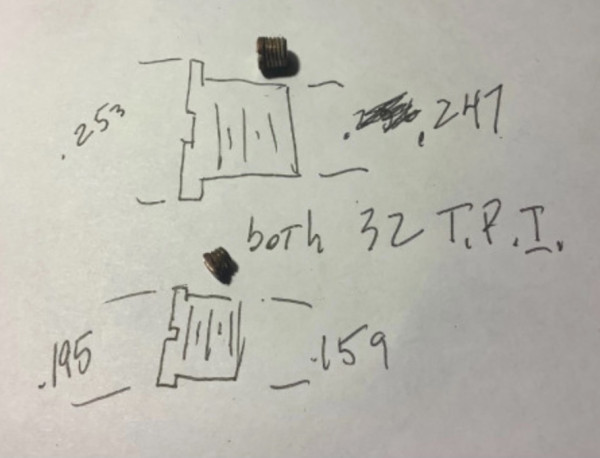

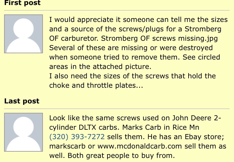

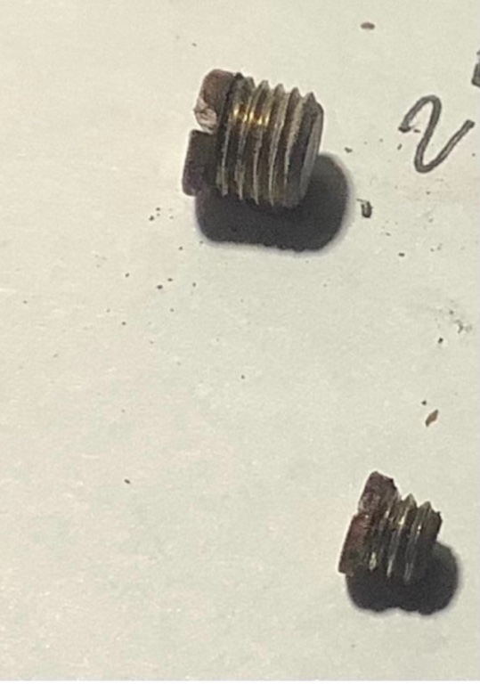

Info added from discussion in the classifieds. Size and modern source of sealing screws.

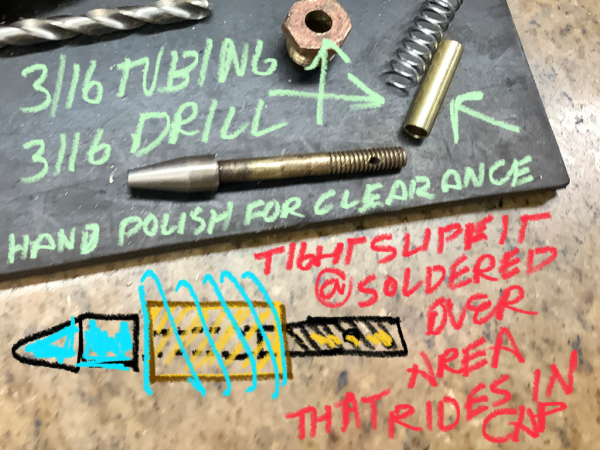

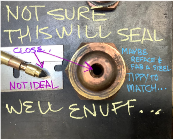

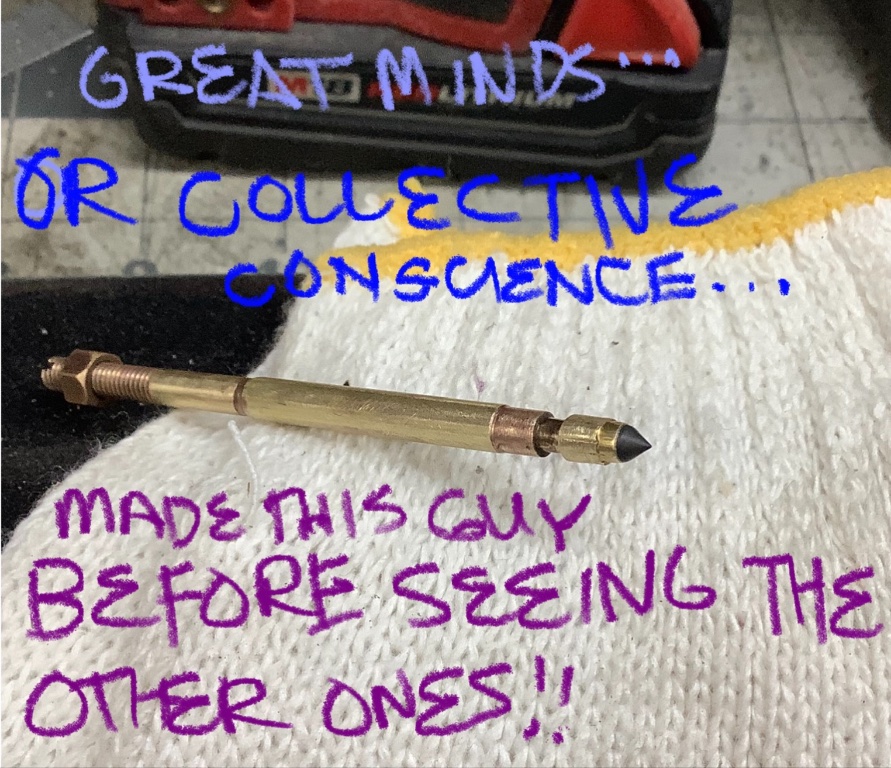

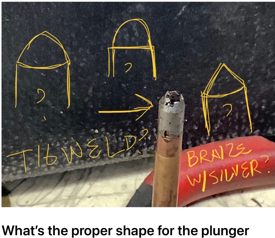

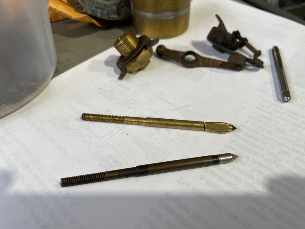

Tim here’s one I started doing a while back is this the needle you are asking about

Thanks Randall, I believe that will help him. Appreciate the effort. He has a lot of other questions written on his pics posted above, if anyone wants to help, he would appreciate it. Thanks!

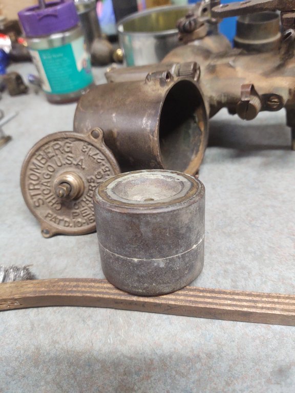

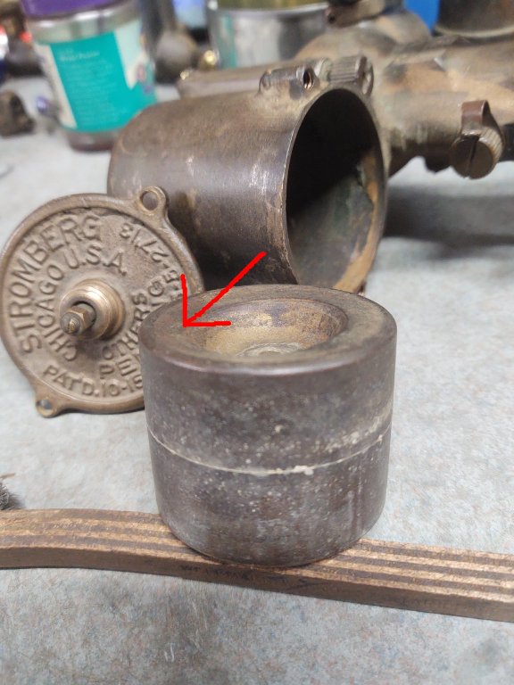

Tim, have you told the fella with the great pics that the float doesn't care if it's upside down or otherwise? :)
In my updraft M-series world, if the float doesn't have any deviations on the flat ends, It's all good either way. VERY similar.
Sorry, I'm enjoying these photos.
Dropacent
Posts: 3384
Last Name: Morsher
Location: Norwalk Ohio
Re: Rebuilding your OF Stromberg
Post by Dropacent » Thu Feb 03, 2022 6:09 am
I haven’t told him anything, as I’ve never been into one of those. So, really appreciate the feedback. I’ve been hoping for more, but I’m sure he appreciates your comments, too.
Duey_C
Posts: 1556
First Name: Duane
Last Name: Cooley
Location: central MN
Post by Duey_C » Sat Feb 05, 2022 1:16 am
Here’s what I was referring to and hopefully adding small info. Floats.
The gentlemen questioned which end is UP on the float. USUALLY doesn’t matter.
I ran into one Stromberg #1 float that had a deviation on a bottom-end surface.
Float 1. Part of the surface is “caved in” so NOT a good end to be on top for the needle counterweight levers.
Float 2 Top. Nice flat surface with the smallest of deviations so when the float turns like they do, it’ll work the same. Look for marks or solder on the float end surfaces.
The pic of the “bottom?” of the float shown above APPEARS to be quite flat so also a good end to be on top.
#1 float dimensions are 2“ wide and 1-19/32“ tall. There may be slight stamping/manufacturing differences.
I’ll stay my fingertips on other thoughts. This I will say, take the economizer out of the equation and they are very simple carbs and that intrigues me. Giovanni Venturi and Henri Pitot helped them work.
