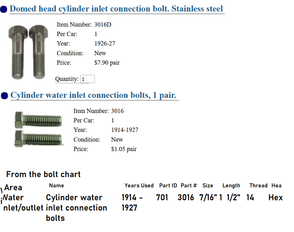

Re: Correct water inlet bolts
It will have a dome head to the bolts like the head bolts have. No zinc plate, either painted steel or nickel plated. Water outlet bolts are domed too.

Thanks to everyone for the help, and the fastener chart and links. I bought some 2 inch long bolts the other day, and they seemed too long, the 1 inch bolts holding the water pump on were definitely too short, so I’m glad I can confidently go find the 1.5 inch ones. Does the finish/material/grade matter? It looks like zinc plated grade 5 is the most common.
- Posts: 2067
- First Name: Jeff
- Last Name: Humble
- Location: Charlevoix, Mi
- Board Member Since: 2006
Common, yes, correct looking, no.
The finish/material/grade bolt does not matter for a water inlet. Modern zinc or cad bolts are not the right finish, and a modern hex head is the wrong shape, they will work, but look wrong. Model T bolts that I have had tested were somewhere less than a modern grade 2 bolt. You can use a grade 2, or greater, your choice. If you got a grade 9 bolt, it has a higher head, you can grind or turn it to make a dome head. Or you could get a dome head bolt from the vendors.
Any modern bolt with any finish, in any grade will work, not look right, but work. You asked. And if you keep your hood closed, who would know.

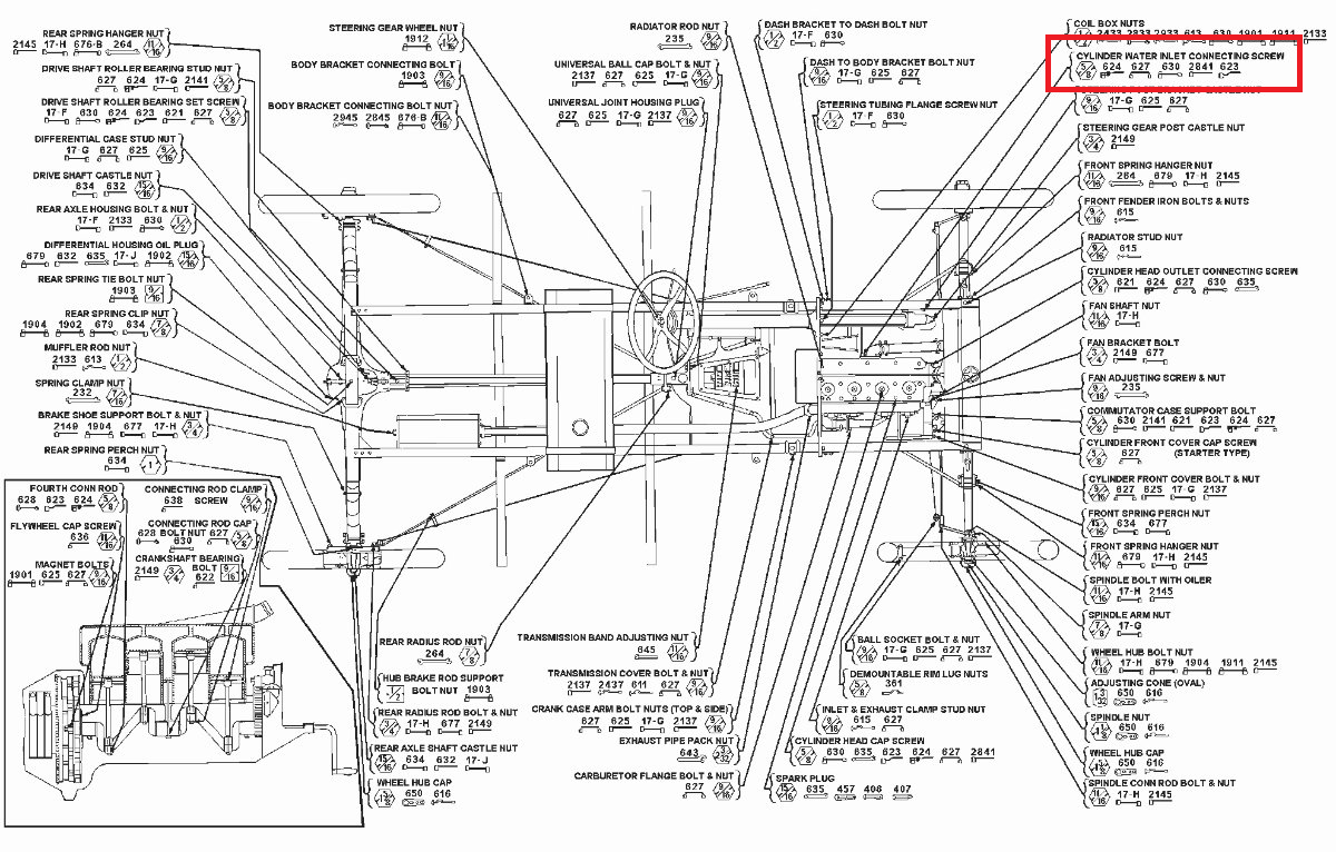

And of course we have the BOLT CHARTS on the Gallery Section, that are just waiting for corrections and missing details to be added. Feel free to have a look at PM me the corrections/ missing data
https://mtfca.com/phpBB3/app.php/gallery/album/195
(Thanks to those who did this some time ago and my apologies that I lost the replies... which is why they have not been updated... (hangs head in shame) )
You may be interested to know that HEAD BOLTS were, in fact referred to as CYLINDER HEAD CAP SCREWS 'back in the day': https://mtfca.com/phpBB3/app.php/gallery/image/1507
