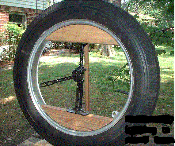

Jim,
The setup below is far superior to any period rim tool and won't tweak your wheel...

Looks good Tim. I have seen that before and will work on that today. I will start by making a template of the curvature. I have the 1926 Jack that came with my coupe. I have also seen the turnbuckle method, but I don’t want to weaken, bend or break my lugs. Thank you. Jim Patrick

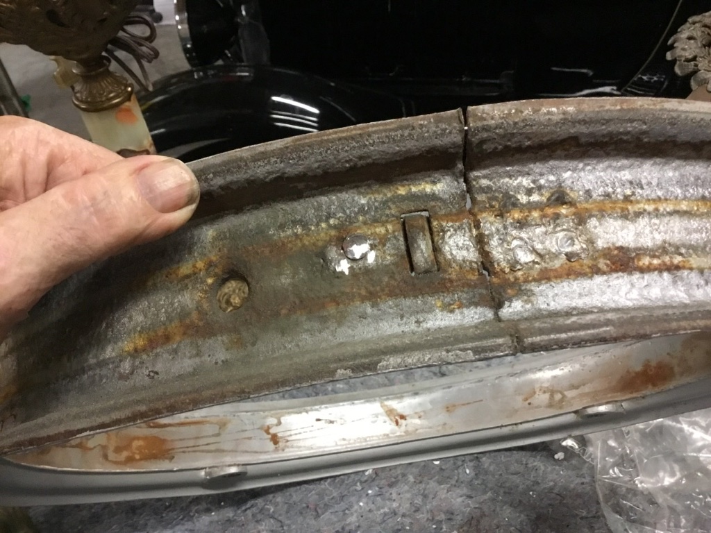

I rode around on split rims for five years before I needed to work on the tires and on collapsing found 3 of the 4 rims had no locking mechanism left.

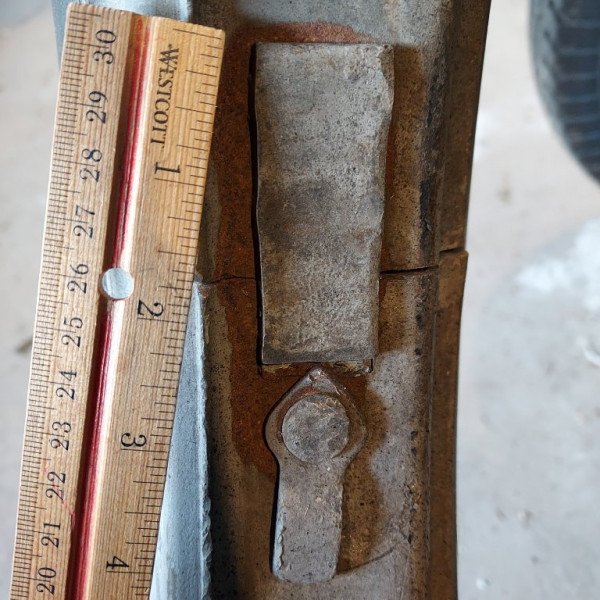

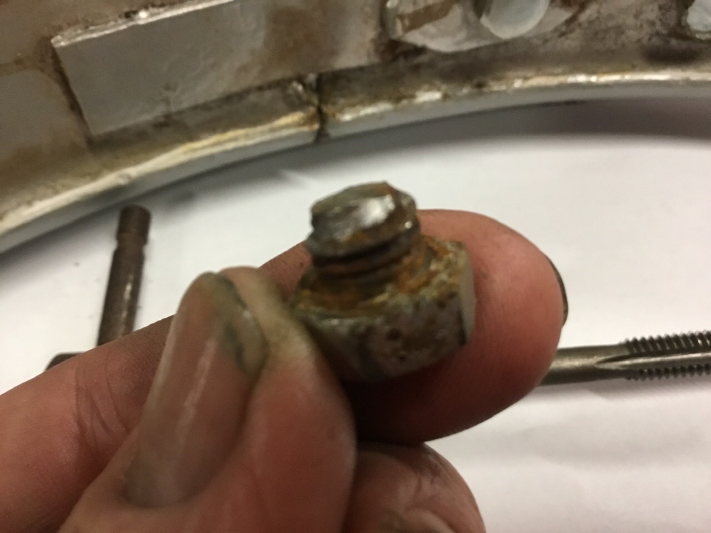

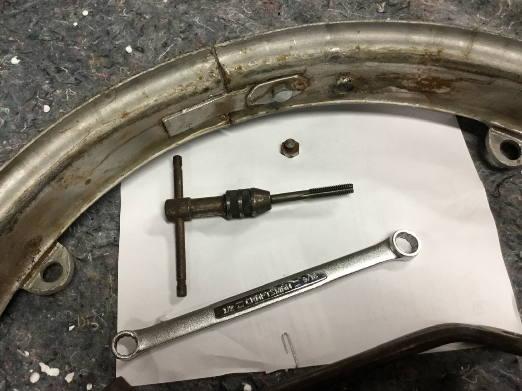

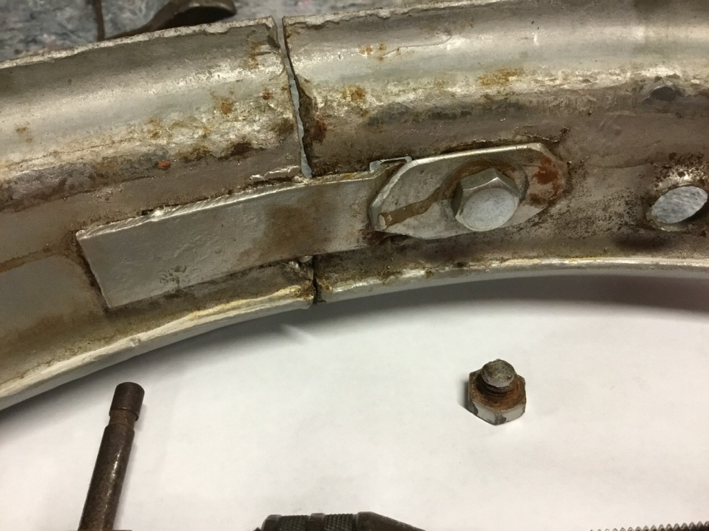

Jerry. The revolving lock latch was held in place by a 3/8”-16 bolt, cut off from behind. I tried to loosen the bolt so I coyldturn the latch and it twisted off. It would not go back in, so I redrilled the hole and tapped it with a 3/8”-16 tap, screwed in a new bolt and cut it off and rounded it off. The rim is still very strong and substantial and no, so is the lock. Jim Patrick
- Posts: 5474
Re: Installing 21” steel reinforced beaded tires
Good show ! My only other recommendation is to bolt the rim w/new rubber onto the wheel PRIOR to airing up to 30 lbs. !

Looks good! I kind of think those bolts where originally rivets, but no matter, your repair looks good. BTW, the latch plate is supposed to rotate without the need to remove or loosen the bolt/rivet. Usually, a hammer and punch to swing the latch plate 90 degrees, allows the tongue to disengage.

The latch lever you show also I do not think is original. Never seen one quite like it. Also, it looks good, functions well, and should be fine.

Jim, I think you are going to have a problem with that latch and bolt, I would suggest replacing it with a correct latch and hold it in place with a rivet. The rim is not thick enough to hold a bolt. I have seen split rims that used a bolt to lock the latch, but if I remember there was a boss on the rim that gave it more thickness. The attached picture is what your latch should look like.

Thank you Jeff. That 3/8” bolt holding the original latch is not original, but is a 60 year old repair to the the low profile rivet that broke off many years ago. The head of the bolt I replaced the broken one with is the same height as the old bolt head and it mounted onto the spoked hub just fine, however, if, for some reason the bolt head will prevent the rim from fitting onto the spoked hub, I can lower the profile of the bolt head by grinding it down to a rivet sized profile, using an angle grinder. As it is, I will probably need to take off the bolt and latch, so the split rim will open up to the stem hole. Without doing that, I believe the bolt head will stop the split rim from opening up as much as it needs to. If I need to repair the other rims the same way, I will use Stainless steel 3/8”-16 bolts. Jim Patrick
