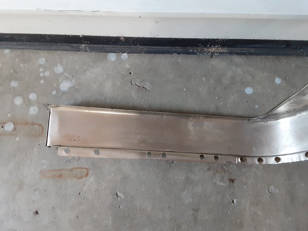

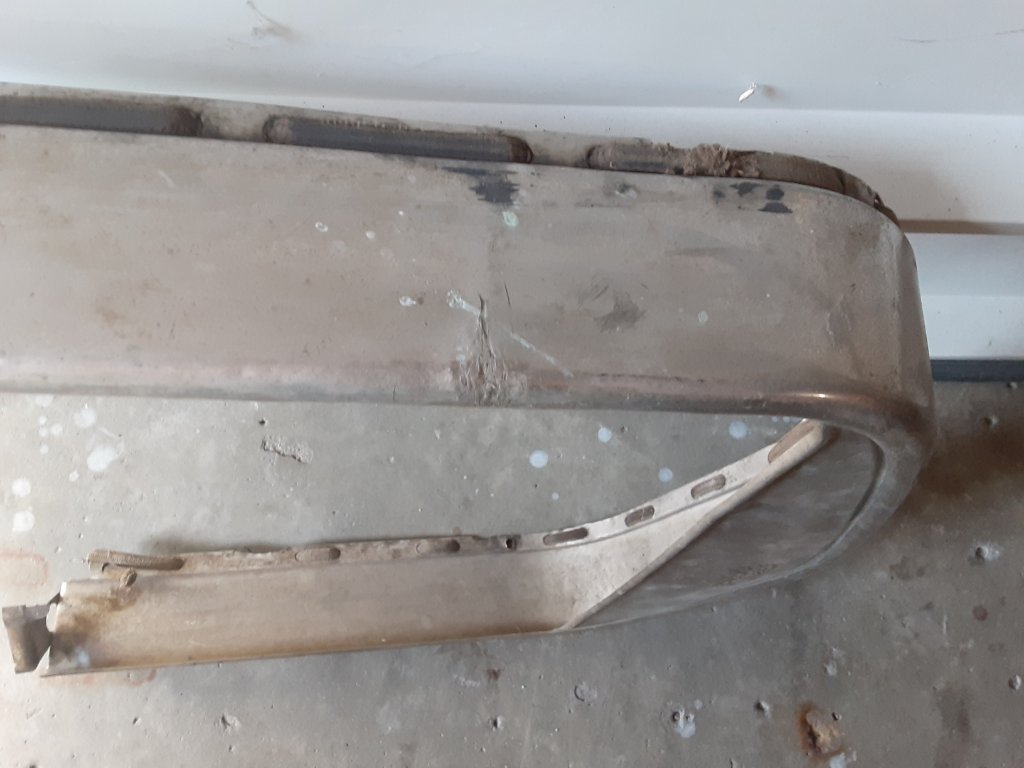

I should have included these two photos in my original post.

If I were going to take those dents out I would make hardwood (Maple is my favorite) forms to fit both inside and outside and C-clamp them together (tight). Or with a press. That is less shock that hammering.

That dent/scratch on the right hand side will not simply press out. In my experience, it will require careful pecking out from behind to get it in shape. Then it may require silver solder to fill the scratch. Block sanding with fine grade wet rubbing paper will get it back to flat, showing any low spots as you go. Then it would require re-plating. If you don''t want it fully restored, just stay with the suggestion to press out the dents, polish it up and live with the flaws. You are indeed fortunate to have a shell in such great shape. Most have suffered badly with ill fitting hoods, so much so that much of the section in which the lacing is threaded has been worn through at the shoulder.
By the way, our Canadian sourced sourced cars I have never found a brass shell with round lacing holes. All mine have had the square slots.

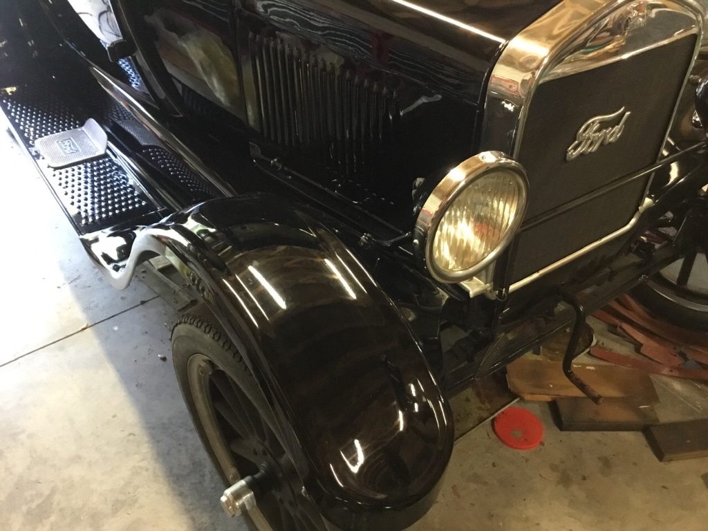

I decided to not remove any dents or other blemishes. I sensed that was what a number of the responders would have done.
I used Jim Patrick's recommended Meguiar's polish to hand clean the outside surfaces and Turtle Wax heavy duty rubbing compound for the interior surfaces, followed by the Meguiar's polish.
I liked the results as shown in the attached photos. Sorry, several had to be rotated to get them attached.
