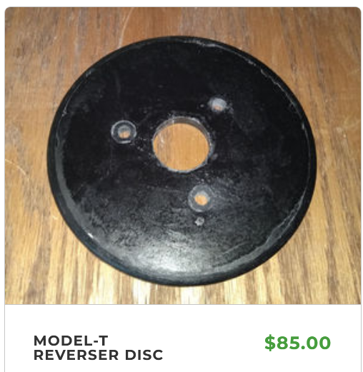

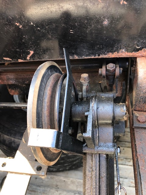

The gear box pulley with the reverse disk mounted to it is likely to be difficult - how is the revers disk attached? would a separate pulley work. --

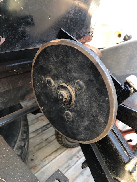

Found a picture of the reverse disk link shows instructions https://gokartguru.com/model-t-go-kart-reverser-disc/
Again that pulley should be able to be found

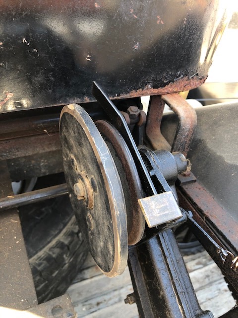

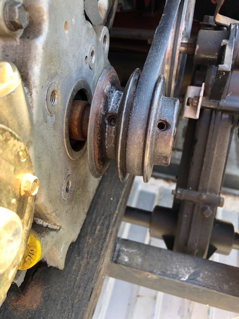

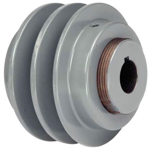

The pulley on the engine has two grooves, the groove closest to the engine is cut so that the reverser disc will mesh inside it and cause it to turn in the opposite direction. The outer groove is adjustable and takes a 3/8” wide belt which drives the pulley the reverser disc is mounted to.
I found a pulley that is similar which I have included a picture of.

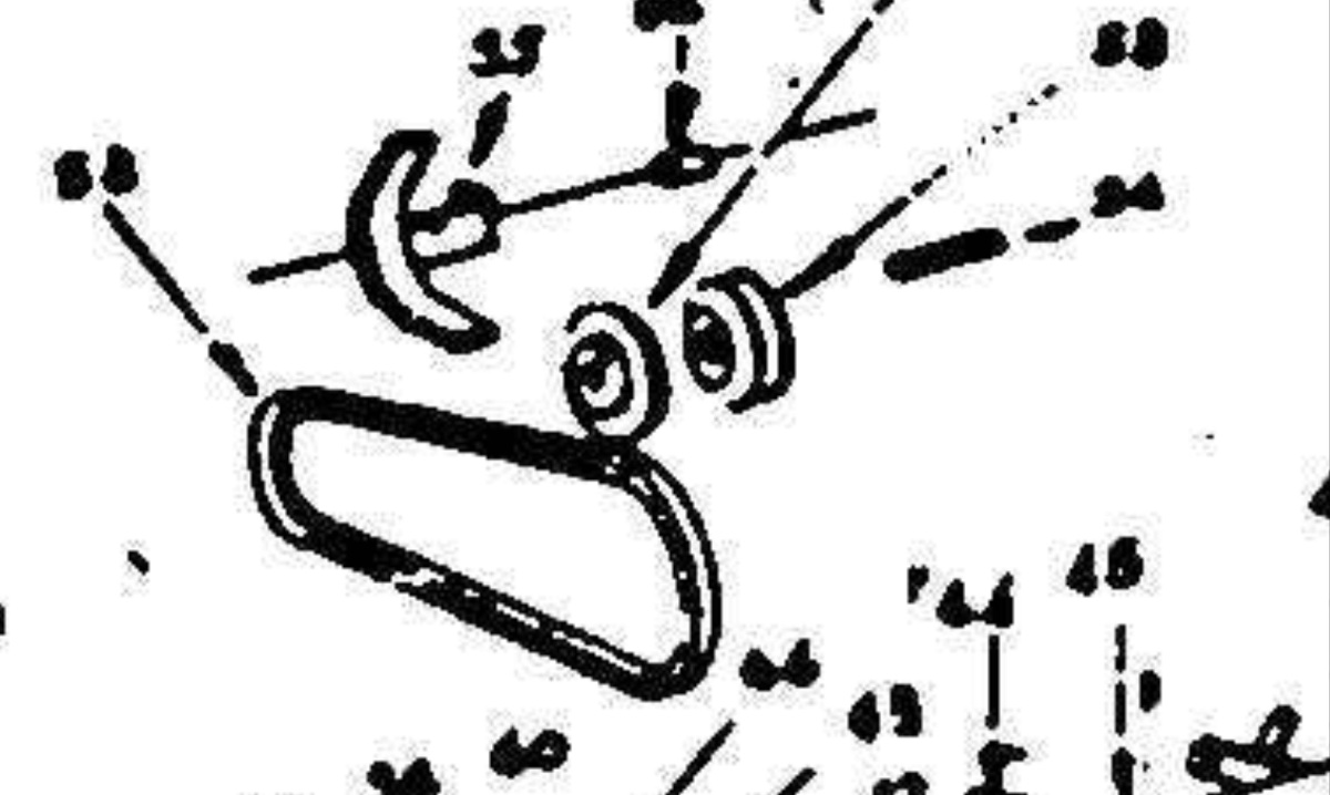

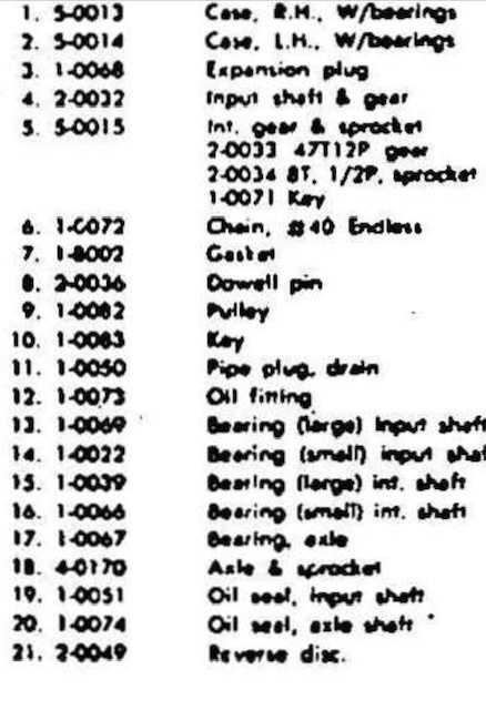

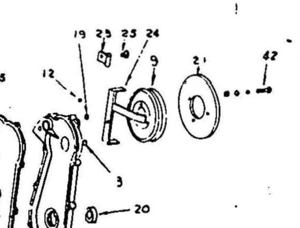

I also am including a diagram showing the parts. It’s not very clear but you get the idea. There are also part numbers listed.

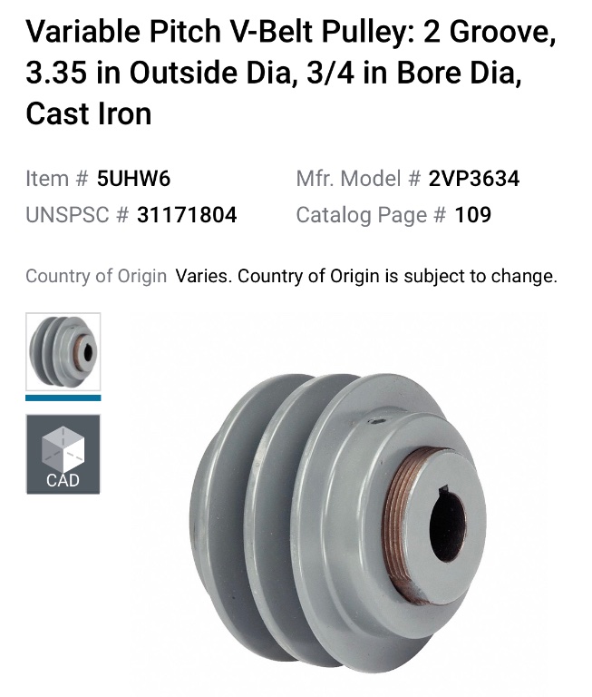

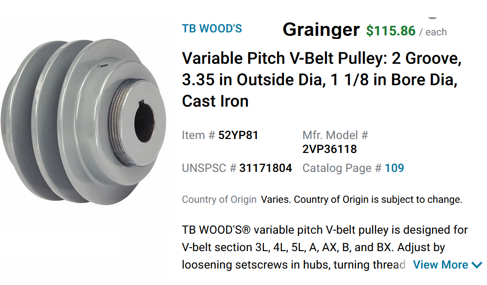

This pulley same as above
Scroll down this link for dimensions https://www.grainger.com/product/52YP81 ... lsrc=aw.ds --
Size matters
Size matters

I think this one is close but will have to get a measurement to be sure.

I think you will find that both groves are adjustable on that Grainger pulley.

That could work especially for fitment of the reverse disc because it makes contact with the taper of the pulley.
The original pulley was 3” diameter and this one isn’t that far off especially with it being adjustable.
