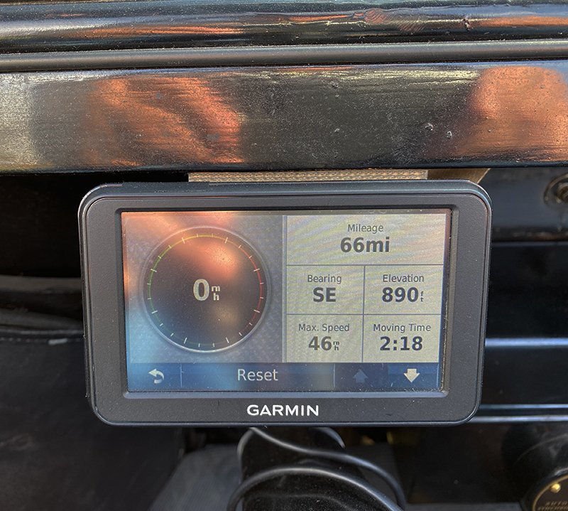

I use a John Regan Hotshot battery charger in my '17. It easily keeps my Odyssey 12 volt battery charged. A question.... I run a old Garmin GPS for a speedometer / odometer. The two Garmin's I've used were about 10 years old. The first one went for over 3000 miles and quit. The second for a few hundred. The failures may be simply age-related or is something else going on?
I understand the output from the Hotshot is 1/2wave pulsating DC whose voltage varies with the engine speed and wondered if that being added to the pure DC from the battery might have a damaging effect to the GPS over time? I connect the GPS to the DC circuit thru a USB adapter that drops the voltage to 5 vdc. Would a filter capacitor in advance of the USB adapter be a good idea or am I worrying over nothing?

I suspected the first USB adapter and replaced it with one designed for 12-24 volt marine use. I’d like to test it but need to figure out how to connect to the + lead in the USB connector or cable. My electronic education dates to the vacuum tube era so I’m not up on the latest stuff. I used to build radios… now I’m lucky if I can operate them.

The two GPS units worked great until they didn't. I also wondered how they would behave in the Model T environment with all the electrical noise but was pleasantly surprised. I never saw any sign of degraded performance. I hid a strip of velcro below the windshield to attach the GPS so I can remove and hide it in seconds for a more authentic look.
I used ten year old Garmin Nuvi units that I bought cheap on ebay. Both GPS units are profoundly dead.... I don't know if the failure of either was preceded by a problem with the adapter. I'll be checking the adapters when the tester arrives.

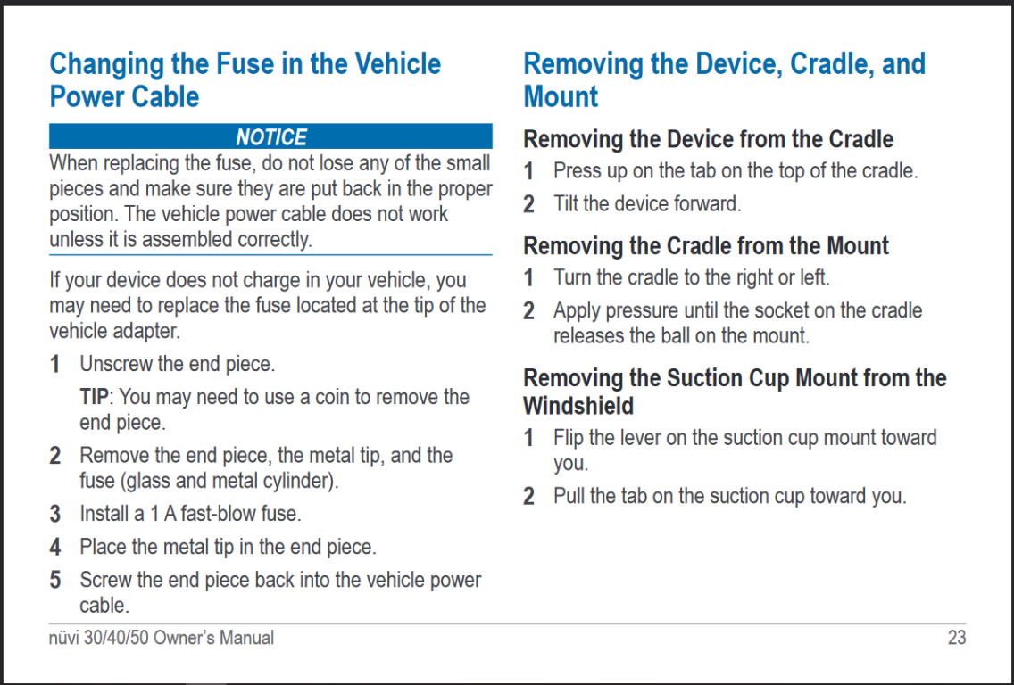

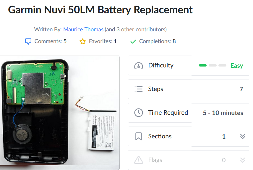

Well now.... Learned a few things about my Nuvi investigating yours that I didn't think about: 1. there is a fuse & 2. it has a battery (yeah! what was I thinking). The battery is likely the issue. When its plugged in your just charging it, when you turn the vehicle off it asks if you want it to stay on. The unit is 10 years old about the life of a lithium batteryOldav8tor wrote: ↑Mon Nov 07, 2022 10:19 amGreat info! Some comments: (1) I'll see if it wants to reset. That would certainly be a good outcome. (2) I use a key switch which does not apply voltage to the auxiliary circuits while cranking. My starter is a 12 volt WOSP unit. My car didn't come with an electrical system so what I have is of my own design. (3) I might know someone with a working oscilloscope.... I'll ask around. (4) the GPS units are 50LM's which come with lifetime maps. I added a micro SD card as the internal memory was maxed out and could not accept more recent updates. With the SD card the update went smoothly.
I appreciate your comments and suggestions....you've given me a few things to think about and investigate.
The following PDF is the owners manual for NUVI model's prefixed 30, 40 & 50 it may be that some things don't apply --
These instructions are for the fuse - I haven't looked at mine to see if it applies --
Battery swap instructions How to swap the battery --

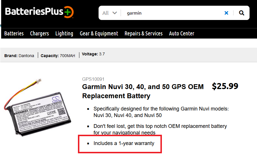

The battery is a Garmin 361-00056-00 there are many seller's but need to make sure the replacement is "new". I'd get one from BatteriesPlus, price is about the same and they may even replace it for you for free, & if it doesn't work for them then you know the GPS is dead
