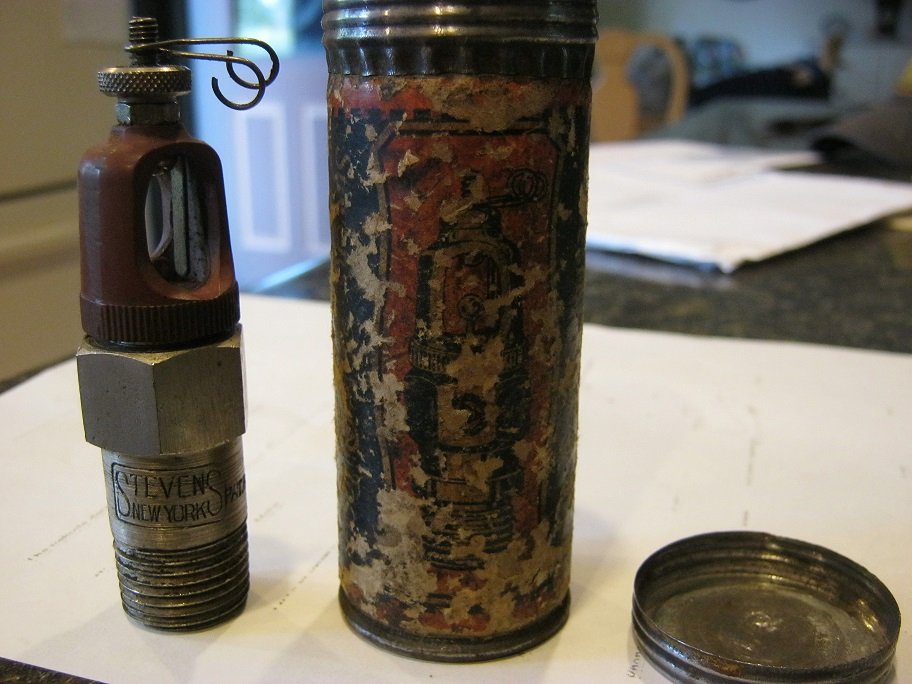

Steven King posted this nice picture of one a few years ago.
http://www.mtfca.com/discus/messages/82 ... 1531292223

I have one, but never tried to use it.
