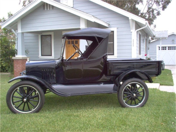

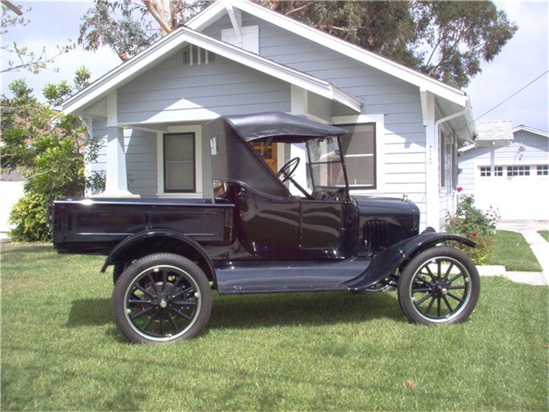

If you have a copy of Bruce's book, take a look at period photos of new cars to see what angle the rear curtain was at. The section on the 1925 roadster pickup has some particularly good pics. Here are a couple of pics of Larry Smith's 1925 pickup, if anyone would have taken pains to put the rear curtain at exactly the original angle, it would be him. Well done Larry!

The top should extend back past the rear of the body at least 2". Yes, study factory photos.
I figured for my 27 the overhang is 3.5" to match the body lines.(with consultation from fellow forum members)
Copying a "factory" 25 roadster P/U may not be the same. Angling the top back will interfere with stake bed sockets.
27 stake sockets are not @ the front of the bed. Changed some time in 26?

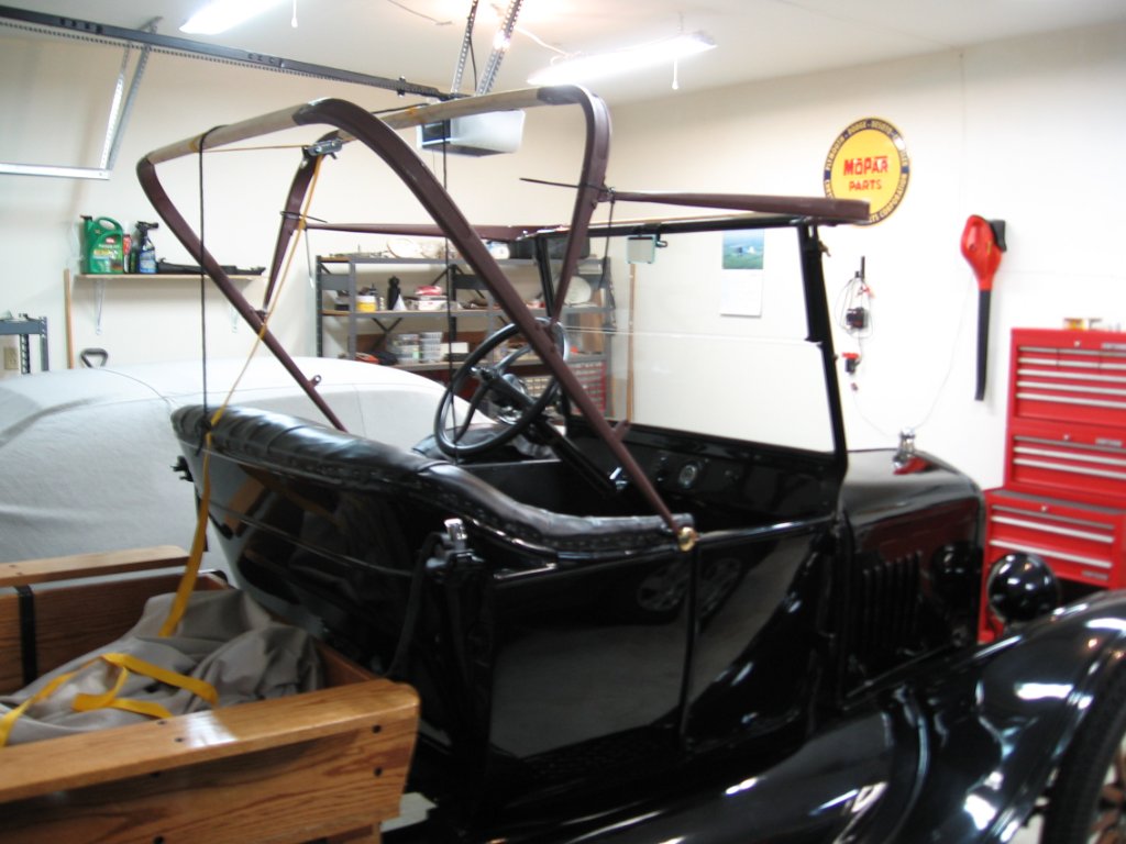

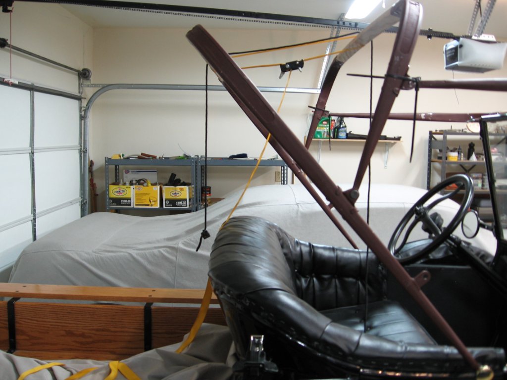

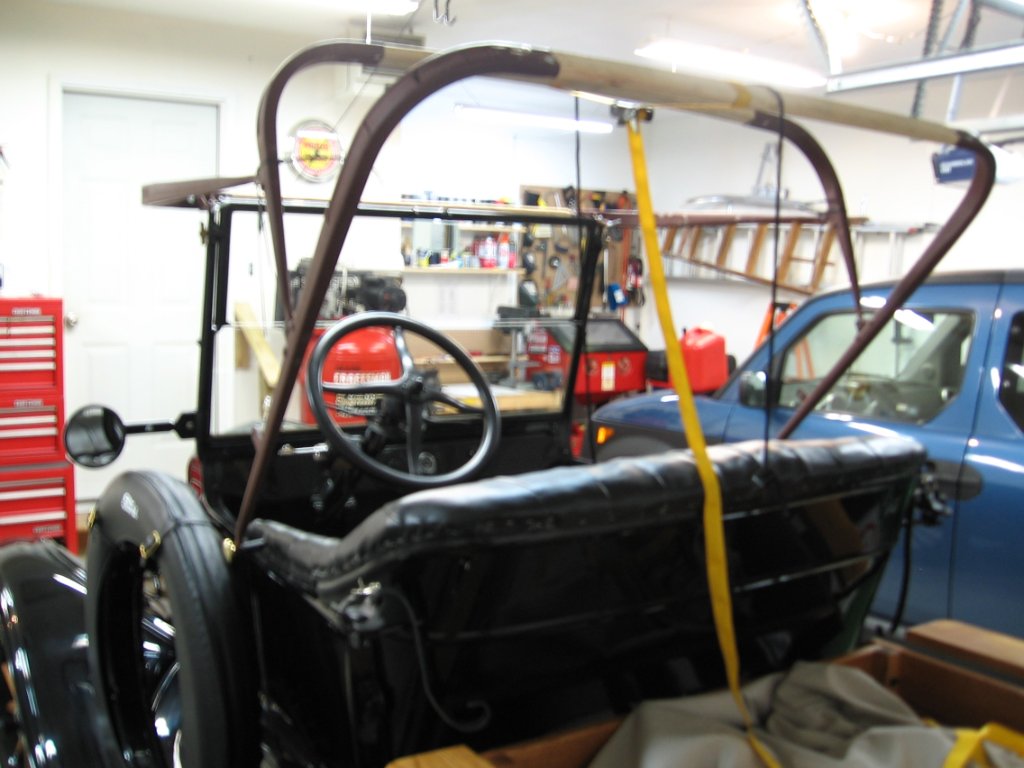

Re: !924 Roadster TOP
I made my top from the original. The rear portion of the top was missing. I made that from existing information. The front top socket has a slot in the curvature of the socket for nails, which the 1923 sockets do not have.
