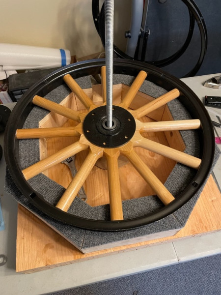

At long last I respoked my wheels today. It went pretty smoothly. I need to peen the nuts and do a little paint touch up. The jig I made for drilling the holes straight worked perfectly.
I am sure that a set done by a professional would be nicer, but I am proud of them. Once they go back on, and I adjust the brakes, my 22 will be back on the road. I did the job in the family room as I can hardly get around the shop with the 22 up on jacks.

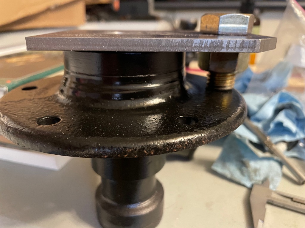

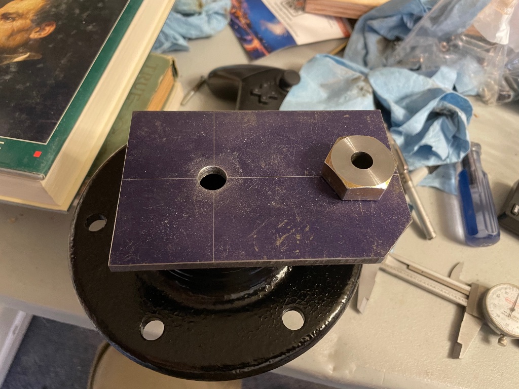

The jig was a pice of scrap plate with a 3/4 in bolt bored through with a 3/8 hole on the lathe.

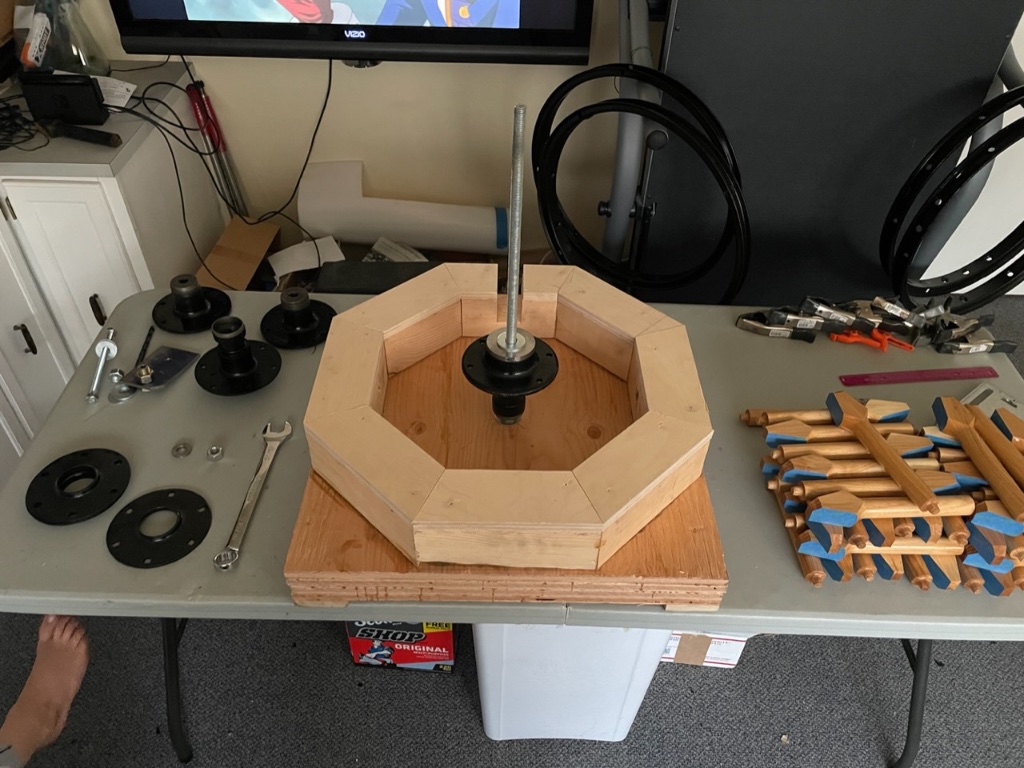

All the bits ready to go (still needed some carpet on the press).

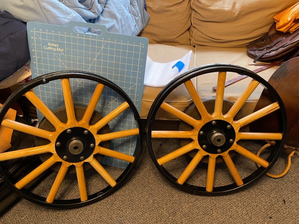

The rears
The rears
The first one in progress

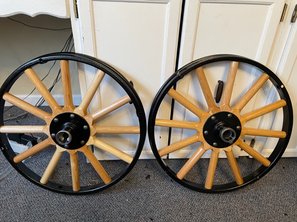

The fronts
The fronts

Another angle of the drilling jig. It was held on by a 7 inch long 1/2 bolt through the hub.
